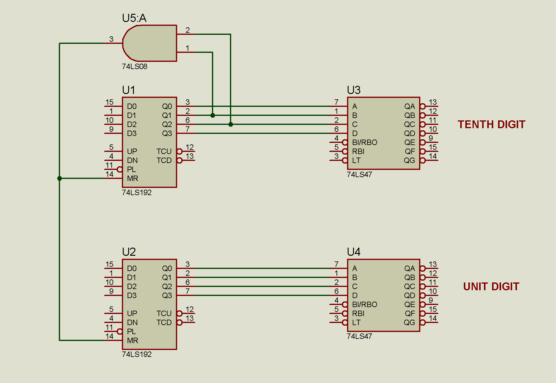

We have this project which is to make a 00-60 seconds counter using 74192 and 7447 IC. I just made a 00-99 counter with the use of the IC mentioned above and i just thought that maybe there is a way to limit the counter up to 60 seconds but i dont know how. Please help me about this guys.
If you want 60 count, i.e. 00-59, resetting on 60 back to 00, then you can connect an AND gate from the appropriate bits (2nd bit and 3rd bit) of the tens display to the CLR input of the counter.

The AND gate method I mentioned above could be implemented with two diodes and a resistor if required.
If im going to add an AND gate, what value of diodes and resistor do i need and where particular do i need to connect, to the output of AND gate? Sorry for the newbie questions, coz i am just starting to study Logic Circuits.
try something like this..
You either use an AND gate or you can use the diode equivalent AND gate; you don't need both.
The resistor can probably be 4k7, and the diodes can probably be 1N4148, or basically any standard silicon PN junction or schottky diodes. I don't think it's very important. The cathode of each diode connects to the 2nd and 3nd outputs of the tens counter. The anodes both connect to the reset input of the counter, the resistor connects from this input to the supply voltage.
