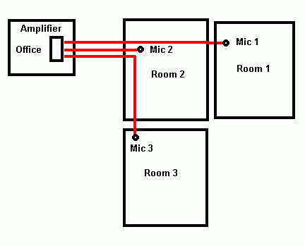

How about an Amplifier in your office.
Then just wire a mic to each room.
You won't need to plug anything in inside any other room. Just run wires to each room and a microphone.
You can have all of them on at once or one at a time.
