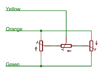

I would be curious to know what the voltage is on the orange and green wires are.
If I understand this I would run the orange and green wires to the end terminals on the two new pots.
The use one wiper in place of the green and the other wiper in place of the orange. The two new pots will set the min and max voltage. The old pot selects a voltage in that range.
three-jpg.36193
3v0

I expect the yellow wire provides a voltage to the controller used to set the PWM duty cycle signal for the servo.
The original pot is a voltage divider with one end tied to gnd and the other V+ (not too sure what voltage is used).
In regards to my previous post.
My method simply allows you to set the end voltages for the original pot using two additional pots as voltage dividers.
As long as the controller does not draw a significant current on the yellow it shou1d work like a charm.
Set center pot to left max, then set left pot to limit left movement.
Set center pot to right max, then set right pot to limit right movement.
The center pot will provide linear movement between the two set points.
Full left will be the left limit, full right will be the right limit.
If this is wrong I want to know why.
3v0
3v0
The OP specifically said that the original pot is NOT a voltage divider; i.e. two of the wires are shorted at the PCB. I was also under the impression that the original pot was a divider where all three wires are significant...
