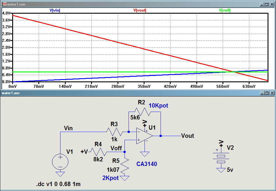

This is a simple way to do the gain/inversion.
Ideally the Voff should be a Vref source, adjustable 0.4V thru about 0.8V
EDIT: changed to +5V
Note: with only a 5v supply the CA3140 will be very close to its upper output limit when outputting 3.8V.

OK, I think I'm getting my head round this.
I want to use 5v as my Vref as I'll be driving this, the MaxSensor and LM3914 from a 5v supply. I've had a look a the TI website and think the revised resistor values should be:
R2 - 7k5 (still use a 10k pot)
R3 - 1k5
R4 - 10k
R5 - 1k3 (still use 2k pot)
but the TI website doesn't show your R1 across Vout. Please can you confirm whether my calcs above are correct, and also let me know how I calculate an appropriate R1?
Many thanks indeed for your quick response and helpful approach.
Edited the earlier image to 5V.
Many thanks. Can I still use a LM358 rather than the CA3140?
For correct operation over the required output swing a MCP6291 rail to rail opa is required.
The LM358 will clip the 3.8V output swing when a +5V supply is used.
You could use a LM358 with a higher supply voltage .

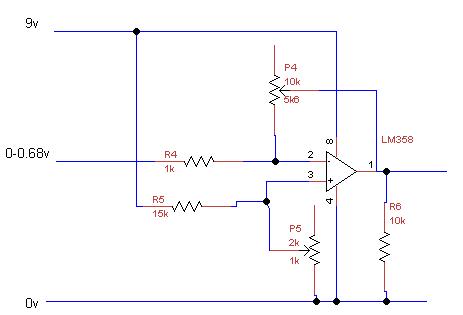

OK, I seem to have the system working with the exception of the op-amp, which I can get to work in non-inverting mode OK, with the correct gain etc using R2=20k, R3=10k pot set at about 5k. However I've completely failed to get it to work in inverting mode.
It's running at 9v single supply. Eric or bountyhunter, please can you help me with the resistor values again? I want the same response as I get from the non-inverted just upside down!
If you are using it inverting, did you create a bias voltage for "middle ground" to bias the input resistors to? With a single voltage, you can't have an inverting amp unless you raise the bias point up above ground because most op amps don't allow the input voltage to go all the way down (a few do).
Post your schematic and we can trouble shoot it.

Enclosed the schematic I think I'm working to, based on information provided by Eric. Does the 2 resistors between + and gnd effectively provide the virtual ground you are referring to?
