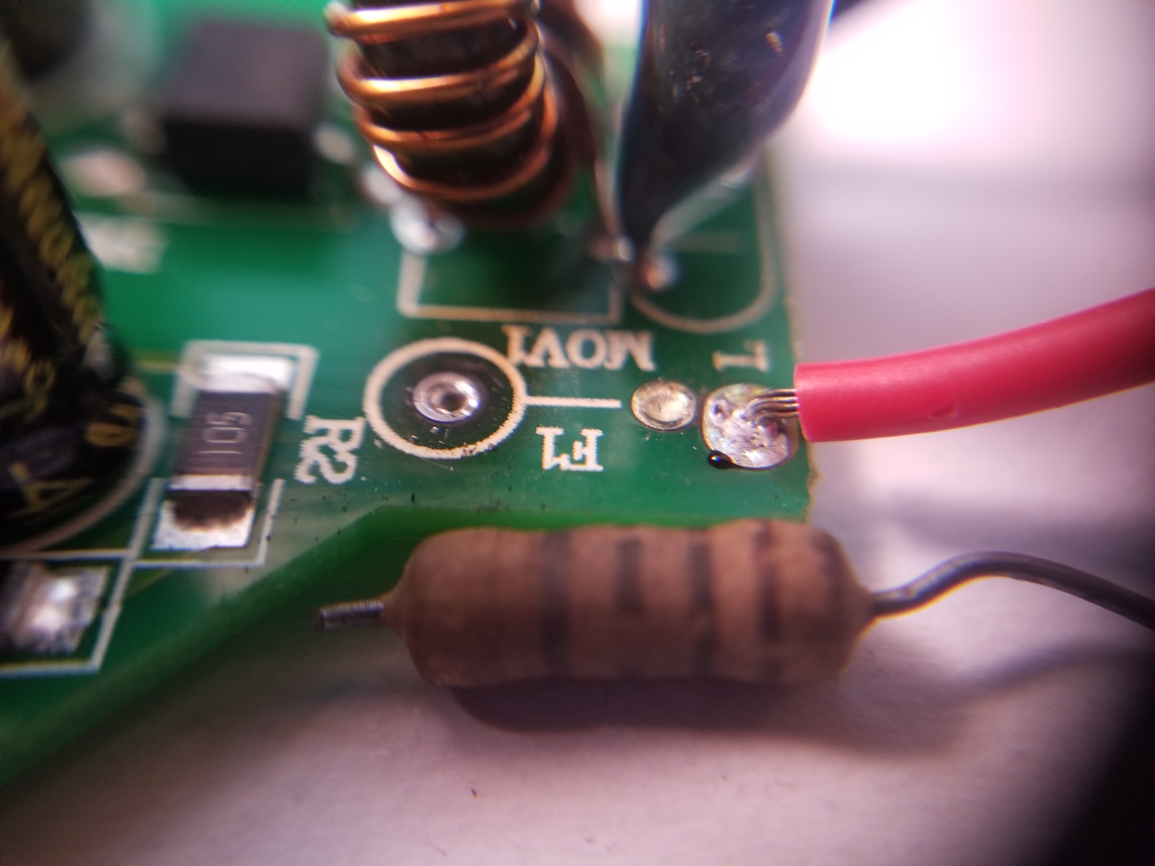

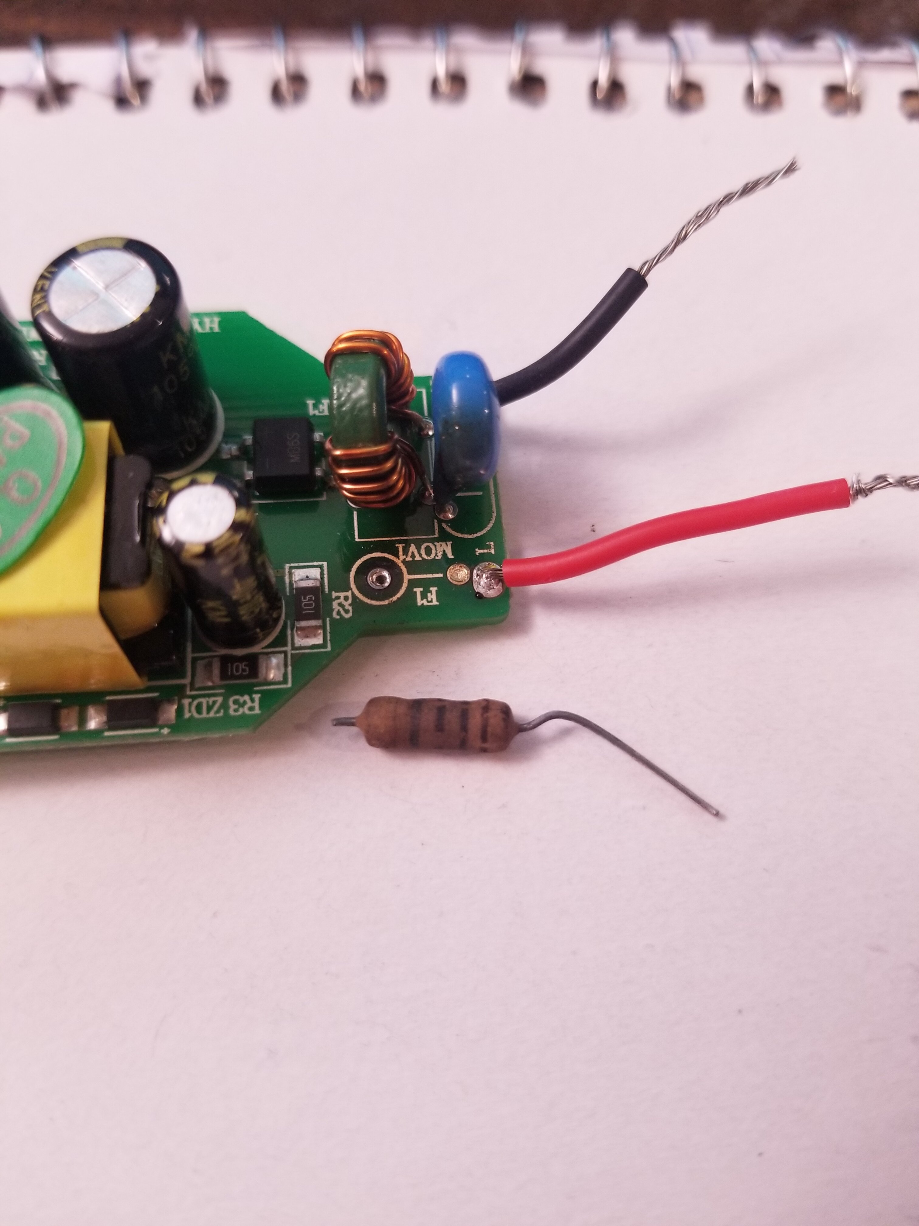

Hello! I am no pro at electronics but I know basic on soldering. Here is my problem. I have a burnt resistor. Looks like it has 5 bands but it's really hard to tell what colors they are. I'm just wondering what kind of resistor I need to order.
The smart bulb has a wireless card.
Thank for the help!!

Assuming it came out of the area marked F1/MOV1 then it's not a 'resistor', it's either some kind of fusible resistor or a MOV (varistor) - in either case it's difficult to know what 'value' it might be, and even if that is the only issue with the board. It's there as a safety device, and will blow if something serious goes wrong on the rest of the board, which would be more likely than it just randomly failing.

Hi Nigel. Thanks for the response. Well I guess I would have to buy a new bulb? I already own another 5 of the same make and brand. I was going to buy a 'resistor' pack just in case any other bulbs fail. I could replace the part and have it on a separate safe outlet just to test it. And yes, it came from the F1. the MOV1 varistor is still there and it's blue and it's not burnt.

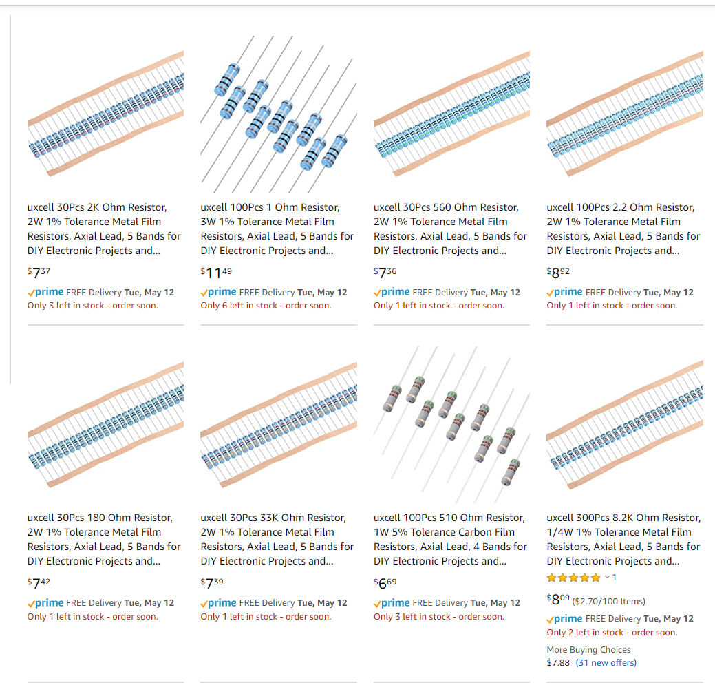

Hey thanks for the response. Would one of these do the job?
Thanks again!
DO NOT TRY the suggestion in post #3 of using a multimeter as a very expensive fuse. I you want to see if there is another fault on the board (Which I am almost certain there will be.) that caused the original fusible resistor to fail the try connecting an old fashioned filament lamp (Not a halogen bulb.) with a voltage rating equal to the mains voltage in your country and a wattage rating of about 20 to 40 watts. in place of the fusible resistor. If it lights at full brightness then there is a major fault on the board.

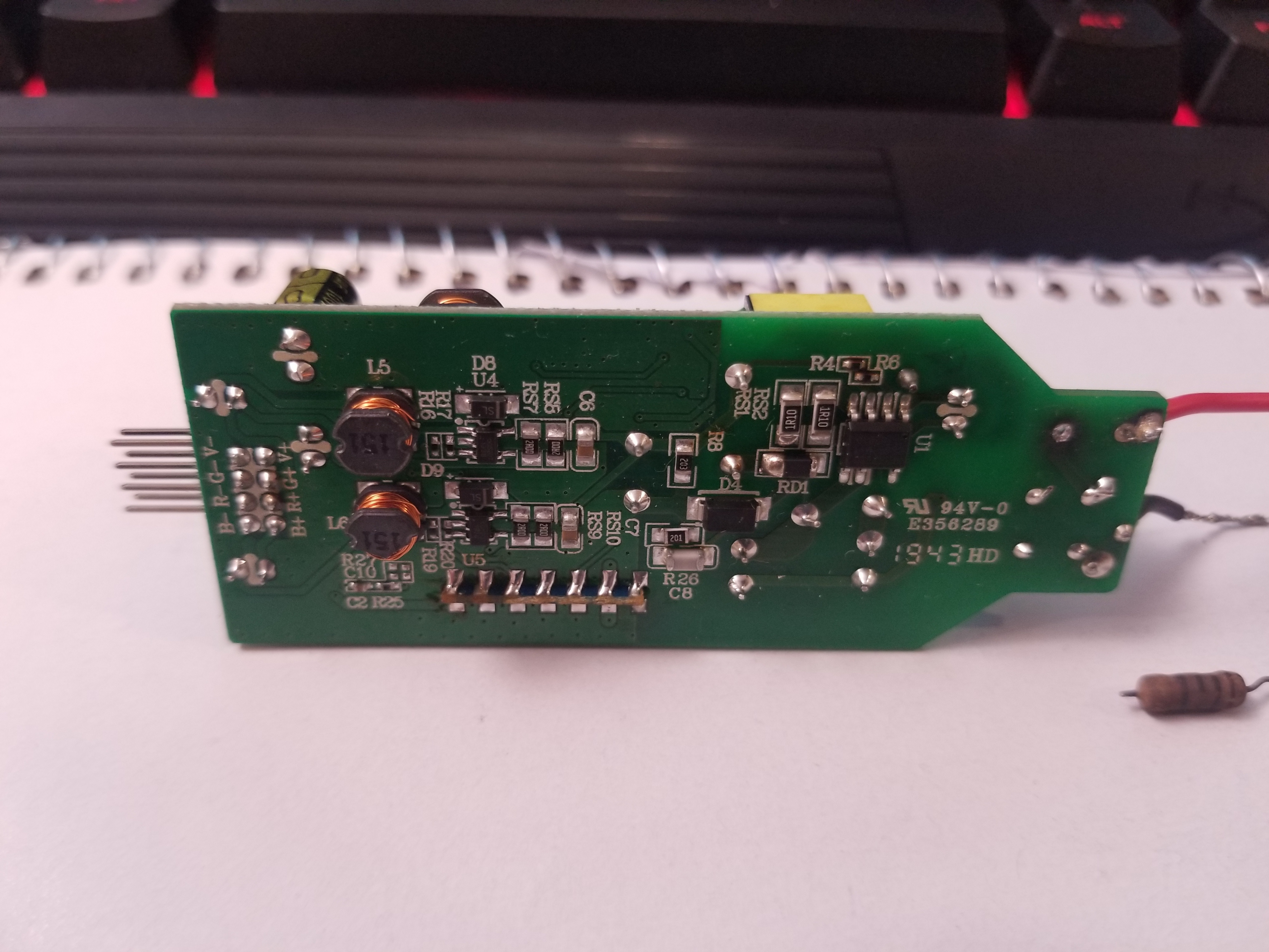

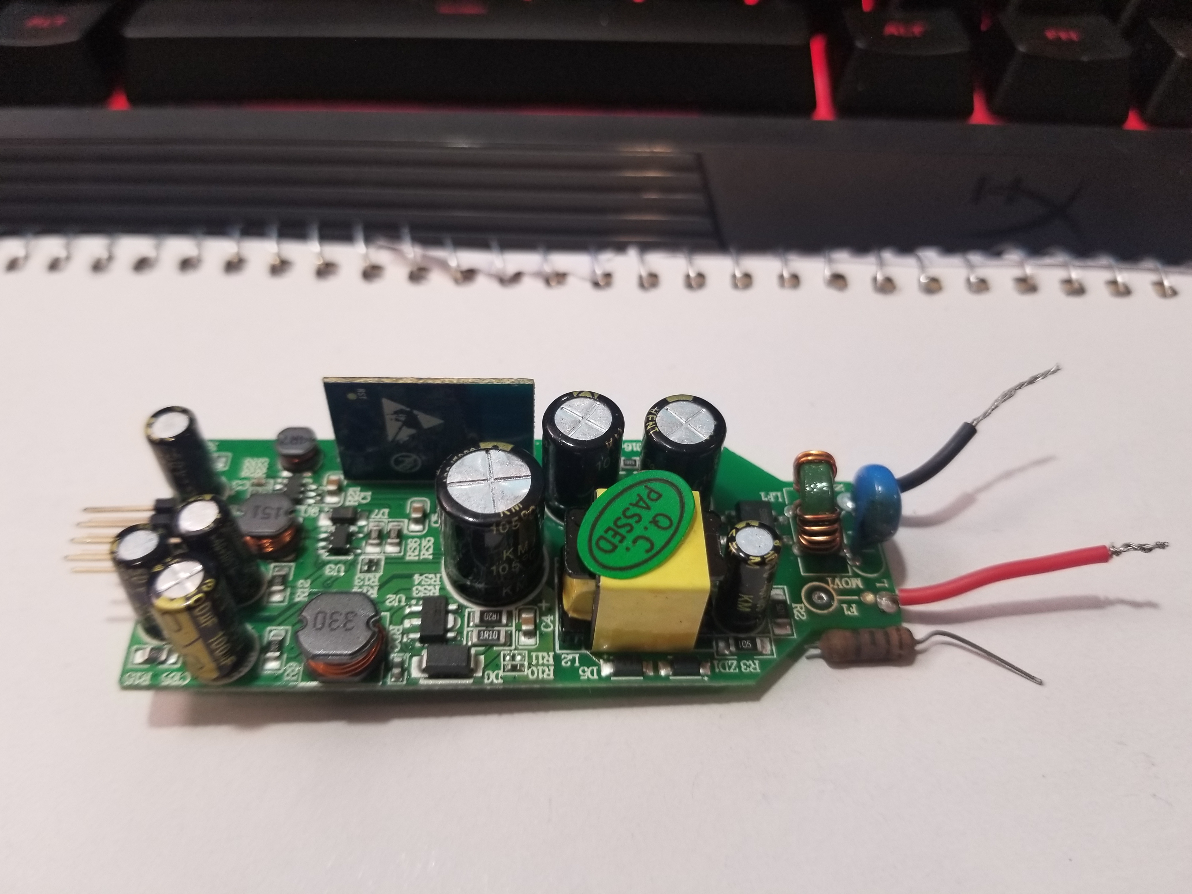

Take one of the other bulbs apart if they are the same, see if you can see the colours properly, you can test the other parts for reference to see whats shorted in the one that might have a short.
