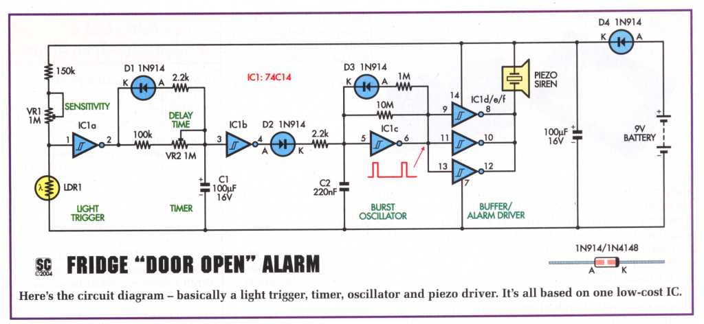

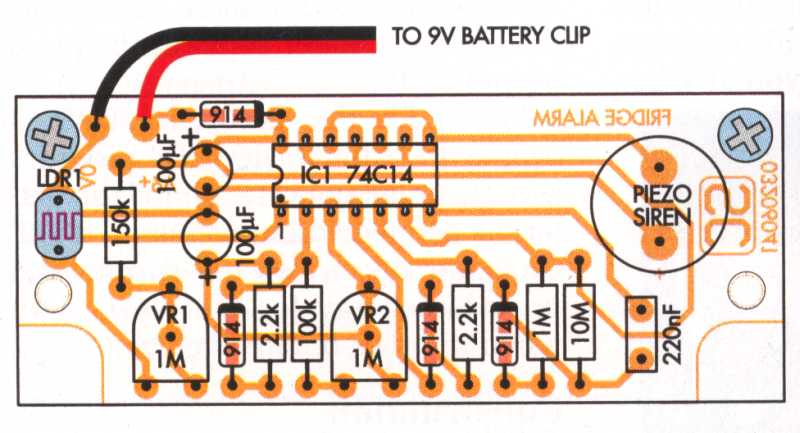

Hi Guy's,
Here's a schematic and overlay of a fridge door alarm and I can't see any reason why you can't use it on a freezer as the parts are rated for - 20 degrees C. Using just 1 IC it's a pretty simple but efficient circuit.
Cheers Bryan :D
Interesting stuff.
Anyone knows would a electrolytic capacitor still works(i.e. have some reasonable capacitance) when it is frozen solid in the freezer?
After posting the above I searched the net for an answer. I found, from the following webpage:
http://www.extremetemperatureelectronics.com/tutorial2.html
Quote:
Electrolytic capacitors typically lose capacitance rapidly upon cooling, and at cryogenic temperatures (below about −150°C) may have perhaps 10% of their room-temperature capacitance.
Unquote:
