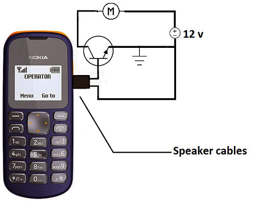

So now the question is, how can I turn on a 12v dc motor just by calling on my cell number? I have an old B&W nokia to spare for this job.
I have tried connecting the speaker cables directly to the motor, but that doesn't even rotate the shaft at all. I guess I will have to power the motor separately through a 12v battery and somehow trigger it from the cellphone's speaker cables. And this is where I need help. What I have in mind currently is this:
119764
What I need help about is:
1- Is this circuit practically applicable?
2- Should I indeed use a transistor to switch on the motor as compared to a relay? I have checked that the cellphone speakers cables provide a maximum of 3v, 100 mA power. Will a relay turn on at all at this power?
3- And finally, go on and tell me that the transistor will fuse away due to excess current. Which resistor(s) do I need to use in this setup (or any that you suggest) to keep it going?
No it's not practical - you can't just use a speaker output in that way.

Of course, but it will be triggered by ANYONE ringing the phone, including text messages from your phone provider.
Some kind of signal detection system on the output, feeding a relay driver - essentially it's a sound activated switch.

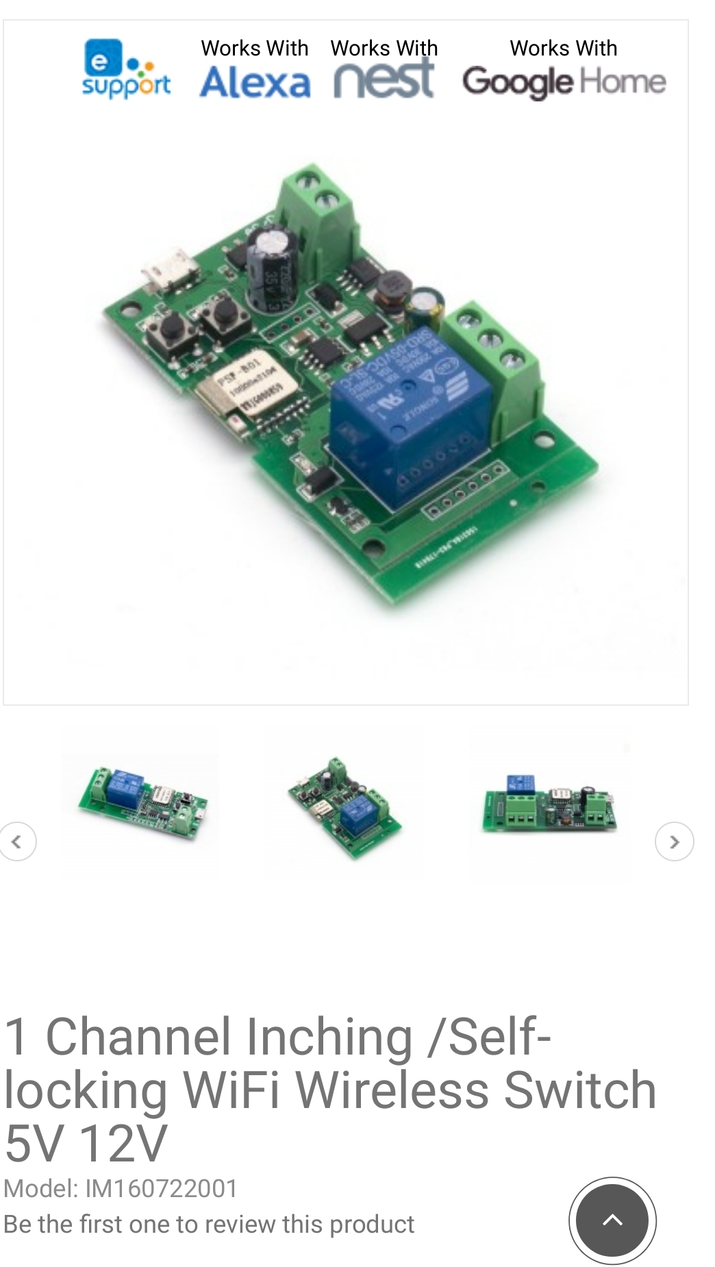

A Sonoff 12VDC module will allow control from a smart phone app anywhere in the world if you have a WiFi network at home. You'd want the 12 volt version of this module, which has something they call"inching mode" - when you turn it on via your phone, it will activate a relay for a few seconds, then turn off again.

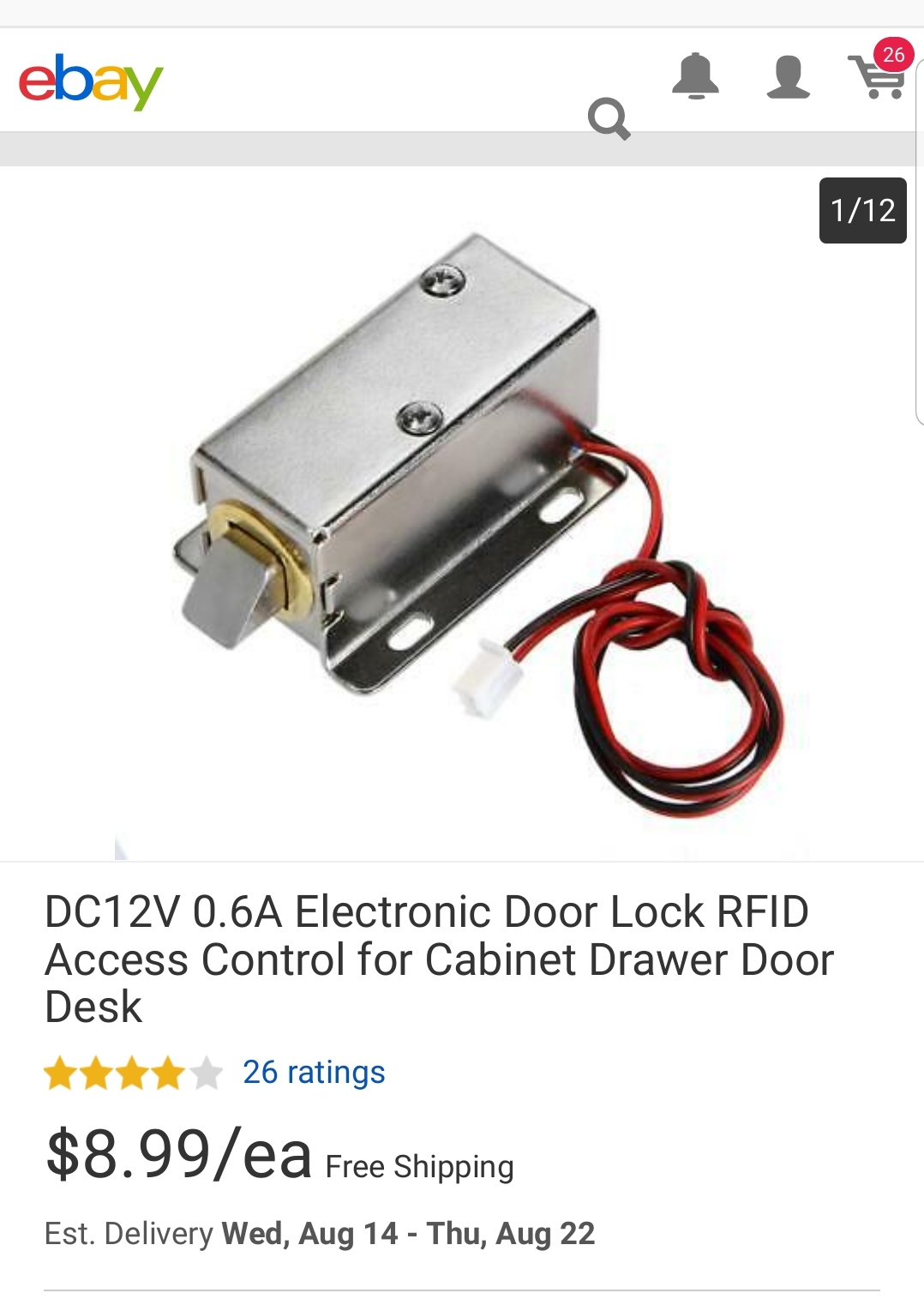

Use this relay to control an electronic lock module similar to the one pictured.
You'll need to supply 12 volt DC power to the inside of the cupboard to operate everything.
Is it possible to make it current/voltage driven switch? I can find ringtone detector custom circuits available on eBay but I want to do this with some amount of accomplishment as an electronics enthusiast.
How do we go around harvesting the power output to the speaker, amplify it to 12v, rectify it and feed it to the motor? This is what I am looking for, please.
I was suggested this approach by a peer, but it uses WiFi, which is a hassle and additional expense to provide, plus SONOFF is quite expensive, too.
A Sonoff module is quite expensive? Perhaps you didn't look at the link - it's less than US$7.
If you don't have WiFi available, it won't work, but I think that's going to be cheap by the time you make your idea work.
Whatever you do with the signal coming from the phone, you will have to have a separate power source to run the lock - there's not enough power coming from the headphone jack to make it work.

It goes like this. I take my old defunct Nokia 1280 cellphone, remove the back cover and disconnect the cables going to the speaker. I use these speaker cables to the amplifier circuit and the output to the lock motor. This cellphone is kept inside the cupboard.
If someone wants me to unlock the cupboard, they call me. I tell them to wait and then call my that old Nokia phone. The ringing signal feeds the amplifier and that turns the motor, hence unlocking the cupboard.
The main issue here is, how do I amplify the ringing signal up from 3 volts 100 mA to 12 volts 100 mA?
