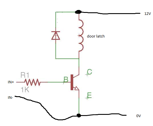

Most of the circuits provided so far are a little complex for a beginner. If the vibration motor output is used, all that is needed is a resistor, transistor and diode to interface to the solenoid. The solenoid will pulse as per the original motor pulsing; if this is an issue (though I doubt it should be), an extra diode and capacitor can be added on the input to extend the ON time.
119875
This image is modified version of one found on image search.
