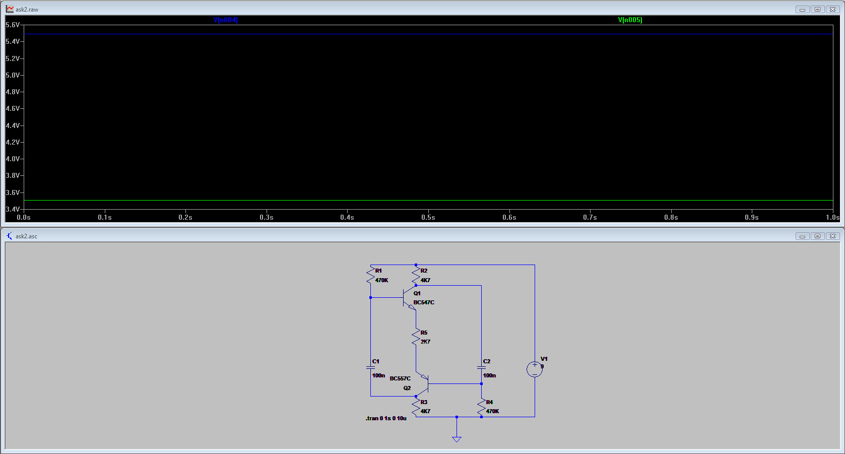

I tried it but i don't know if that's correct. I have attached the result for you to see. Is this what you expected? The blue line is the emitter of the npn and the green the emitter of the pnp

It looks as though its so high a freq that the simulator cannot resolve it
Increase the value of both caps by a factor of 10
Measure the collector not the emitters

I changed the caps to 1u and even 10u but the result was exactly the same. Am i doing something wrong?

The transistors still saturate, so the resistor does not effectively get multiplied by beta, as I surmise you were thinking. In fact, in my simulation, the circuit won't oscillate if that resistor is above ≈2.2k.
I am aware what the effect of saturation of transistors will have on β, the suggestion of a 2K7 resistor test, was to make the discharge paths the same, in order to produce an approx equal mark space ratio so that the OP could observe the effect of the diode in/out.
It would be then an easy task to increase the values of the two timing caps to give a freq required by the OP.
Can you say what the mark/space result was with < 2K2 and the *10 caps, I dont use a circuit simulator.
