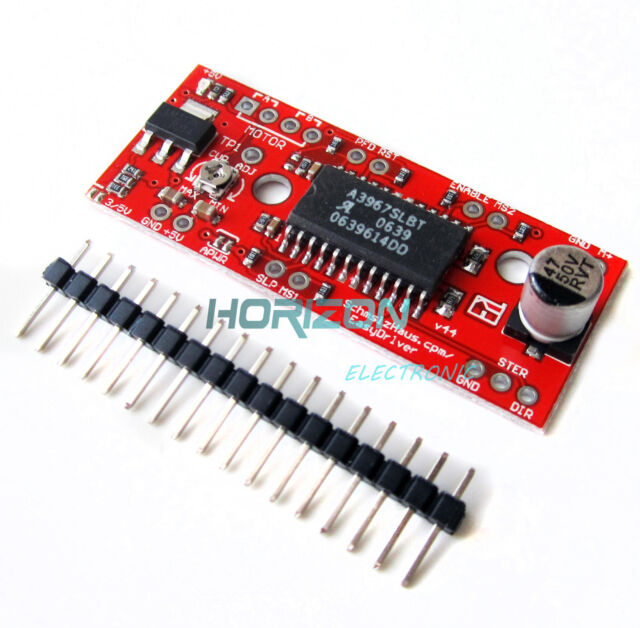

I got some of those too mine didn't have heat sink tho it burnt up at 500 mA but like I said it had no heat sink.
It like got hot really fast . I then seen them with heatsink. probably the problem but i got them for like nothing.
It would be nice if the easy stepper would do 1/16 it only goes to 1/8
The A4988 good to 1 amp
I'm SOOOOO glad you've warned me. The modules haven't arrived, and now I'll make extra sure that the heat sinks are properly installed and tight against the chip. Many thanks!
