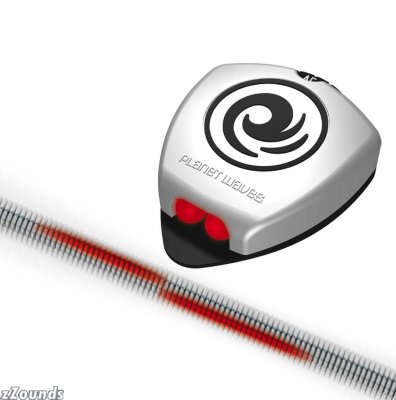

I saw a very interesting guitar tuner a while ago. It consisted of an oscillator that flashed an LED at 440Hz but with very short duration. You held the device near the string and it acted like a stroboscope. When the string looked stationary it was tuned.

Do you mean some thing like the attachment?
I have one of those. It's extremely accurate but its fragile and buggy. For example, on of LEDs on mine isn't nearly as bright as the other.

That is because it is made cheaply. There is no reason that something like this couldn't be extremely accurate and reliable. It would be a very good solution to the OPs problem.
