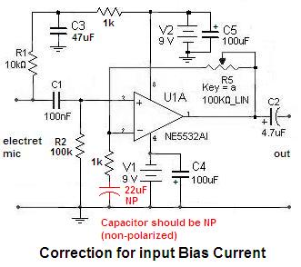

This is a non-inverting electret mic preamp circuit:

tried simulating it, worked fine but I didn't notice the shift of the waveform when the 100k pot's value was changed...
R5=50kohm Vout=493.302mV
R5=100kohm Vout=(*shifted downward)

The reason for the shift could be due to the OpAmp's max input offset voltage of 4mV being amplified by 100x to 0.4V at max gain setting. Since the Thevenin resistance on the inputs of the amplifier are also unbalanced then the input offset current of the NE5532 will also come into play. How much, in volts, of an shift are you seeing when you adjust the 100K gain pot?
Did you connect the 'scope to the output of the opamp instead of to the output of the output capacitor C2?
Then the high bias current of the old opamp causes the output to change its DC voltage when the gain is increased by adjusting R5.
I am used to using FET input opamps like the TL071 and OPA134 which have no input bias current.
The max input bias current in an old NE5532 is 0.8uA at room temperature.
Therefore the voltage drop across R2 (100k) is 0.08V.
Therefore the voltage drop across the 1k resistor at pin 2 is 0.0008V.
Therefore the max output DC voltage is (0.08V - 0.0008V) x 101= 7.99V above 0V or 7.99V less than 0V so the output might be saturated.
Adding a capacitor in series with the 1k resistor prevents the max voltage of 0.08VDC from being amplified.

thanks! it worked....a little confused about the nonpolar caps though...their values are in the category of electrolytic types... and I got a list of their ranges and they do fall in polarized caps...there were no avail. 47uF & 470uF NP in the stores....
I tried changing them n simulation into polarized caps: C3 and 22microF...an the preamp worked well as it was with NP..
The non-polarized capacitor has low frequency AC across it. A polarized capacitor is a rectifier when the signal polarity is reversed which causes severe distortion. Your simulation program does not know about it.

In this case it would make no discernable difference, no voltage worth mentioning across the capacitor - if it bothers you, put two electrolytics in series (opposite ways round) - which is all most NP electrolytics are.
is this what you mean? is it safe to put it like that on the circuit e.g. 22micrF cap connected to the gnd? the capacitance of the cap at the right side would follow the rule on series capacitors?
thanks for the info...but not so sure if there's Digikey in our area...
You correctly show the back-to-back capacitors.
Two 47uF capacitors in series makes 23.5uF which will work fine.
