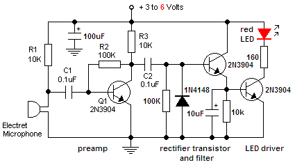

Did you look up "Darlington transistor"? Two transistors with a gain of 60 will give you 60 x 60, so 3600. MORE than enough. And the current is very small. That 2N3904 will do very well, and it is easy to get.
so i have to buy 2 transistors 2n3904 and try with one if it doesn't work i connect it whith the second thx ur the best

It will be better to replace R2 with the potentiometer for now. This is a very simple bias, and this is where you will need adjustment.

Yes, and I suspect he will learn a little something about biasing transistors in the process... afraid that circuit won't work very well. The light is on, mostly - but it DOES flicker if you blow on the mic hard, so I'll give myself half a point, after all - IT WAS AN EMERGENCY!!!!
If he's curious enough to increase that troublesome 100k resistor to a whopping ten megaohms, he will discover the LED gets quite dark when he yells loudly into the mic.
If he's further curious about biasing NPN transistors, he may discover the right way to do it (a 1 meg from the base to Vcc, 500k pot from the base to ground, no collector-base resistor) will, in fact, make the light light when you yell at it.
Does not need a recitifier, it's kept just below the 1.4V needed to drive the darlington.

It is easy to design a simple circuit that blinks an LED when there is a sound.

$crooge's. One fewer transistor, charge pump on the base of the second transistor.
That first circuit will work, if you make it a Darlington transistor, and use a "voltage divider bias" with 1M (megaohm) as the top resistor and a 500k (kilo-ohm) potentiometer (connected as a rheostat) as the bottom resistor.
And if you don't mind yelling. The gain isn't impressive. Really needs three transistors.
