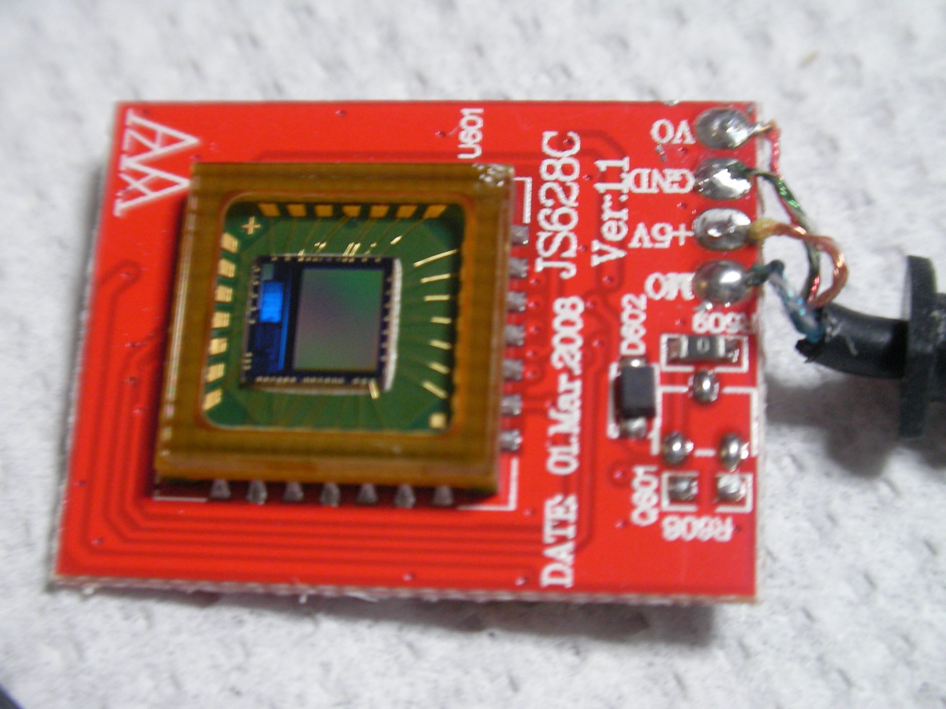

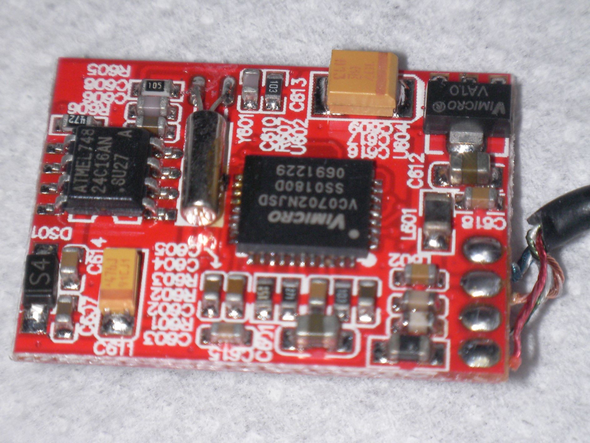

Photos of the camera PCB attached, and the user manual for the DVR and camera.
  • JS308&JS309M User Manual.pdf

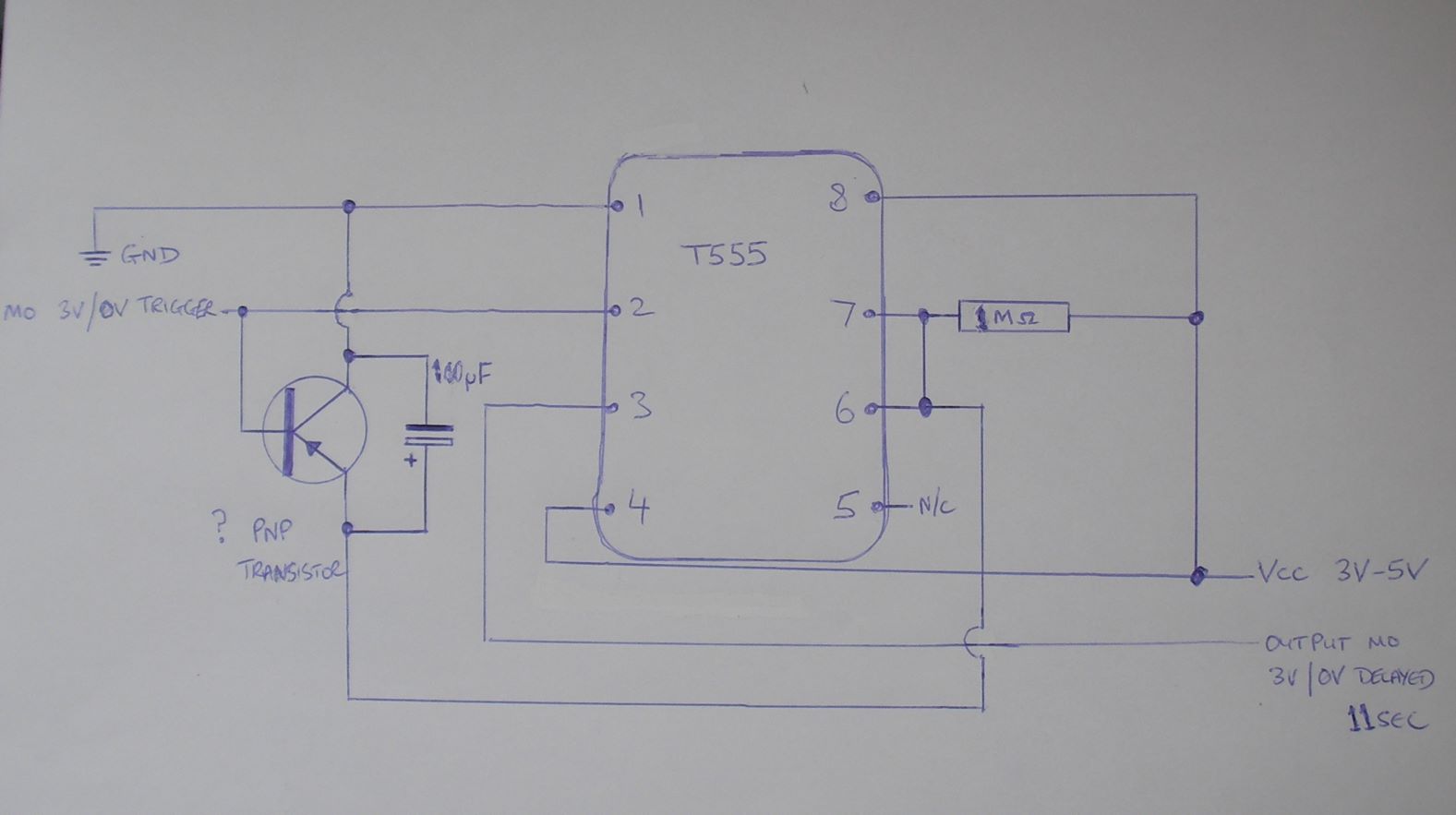

I guess the next is a circuit diagram, do you want to post a sketch.?
Use the data sheet for a ref, we will then guide you thru the design.:)
I think this right, sorry I've got no CAD, so old skool pen and paper will have to do ;)
It highlights a few points,
Looking at the fig 10a circuit diagram (
I'm also not sure which type of capacitor, but the info from Maplins on the T555 says "Choose high values for timing resistors to keep supply currents low and low values for capacitance, which should be low leakage types, not ceramic."
So by high values I assume it's 1MΩ or higher for R
which using the formula Time (seconds) = 1.1 x R x C gives 100µF for C to give T = 11 seconds, where R= 1 MΩ (provided I've put all the zeros in the right place for the calculation ;) )
100µF isn't an incredibly low value for C so I'm wondering if that's OK?
Next question will be which capacitor do you recommend? (It needs to be non-ceramic)
Onto the resistor, I'm thinking of putting a potentiometer in place of R, possibly up to 5MΩ which should give 55 seconds at the top end, but I'm slightly concerned that if it's wound down too low RΩ will be too low and that may have a bad effect on the capacitor. I don't know if it will or if there is a way to limit the lower resistance?

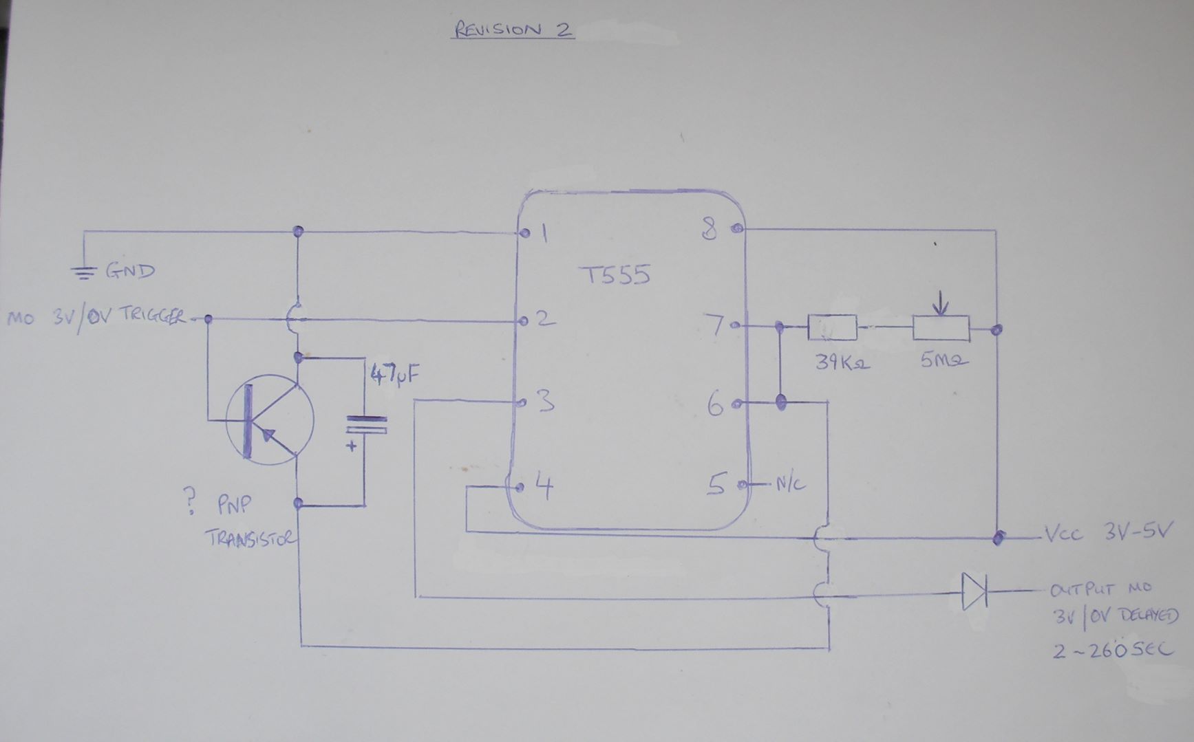

How does this look?
I'll think out a loud again, just to progress things.
First of all I've updated the circuit sketch to include some changes I 've included..
Secondly I need to correct my earlier calculations, I did get it wrong (by a factor of 10) so I'll show the calculations, to make it easier to spot any errors there.
I've added a potentiometer, to provide a means of adjusting the time delay, and at the same added a resistor in series with the potentiometer, to prevent a 0Ω reading, (I think the lowest is resistance 2Ω, but it will still drain the battery fast I expect)
New calculations using Time (seconds) = 1.1 x R x C look like this...
The resistors separately
1.1 x 39KΩ x 47µF = 2.0163sec
1.1 x 39000 x 0.000047 = 2.0163sec
1.1 x 5MΩ x 47µF = 258.5sec
1.1 x 5000000 x 0.000047 = 258.5sec
= 258.5 + 2.0163 = 260.5163 sec
OR together
1.1 x (39KΩ + 5MΩ) x 47µF = sec
1.1 x (39000 + 5000000) x 0.000047 = sec
1.1 x 5039000 x 0.000047 = 260.5163sec
Gives the same result, delay range now being approx 2 seconds to 4 minutes 20 secs.
I've tried to fill the gaps in my knowledge with "uneducated guesses", I'm particularly concerned about which transistor to select.. I've taken a real flyer by selecting the one I have, also I'm not sure if the Diode I've selected is correct. I've added the diode to try and prevent a backfeed corrupting the MO (motion sensor) signal when I supply the unit from the USB. (I guess you can tell this unit was fairly cheap!! :rolleyes: ) I'm not sure if it will work, but I'm more concerned about whether or not the addition of the diode will effect the timer output.
I have put together a parts list which may do the job without exploding, I'm not sure !! :eek:

You don't need a missing pulse detector. Look at the turtorial in the section "Monostable Mode", a little over 1/3 the way into the document. See figure 9a. That's all you need. No transistor is required.
Thanks for the response, but are you sure BrownOut?
Perhaps I'm missing something, but I need zero volts to be maintained on the output once zero volts is detected on the trigger cable. I can see that scenario working with the "missing pulse detector" (fig 10a), but surely the Output from the timer will be a voltage of some kind in fig 9a?
If does work without the transistor that will be great, so I hope your right :)

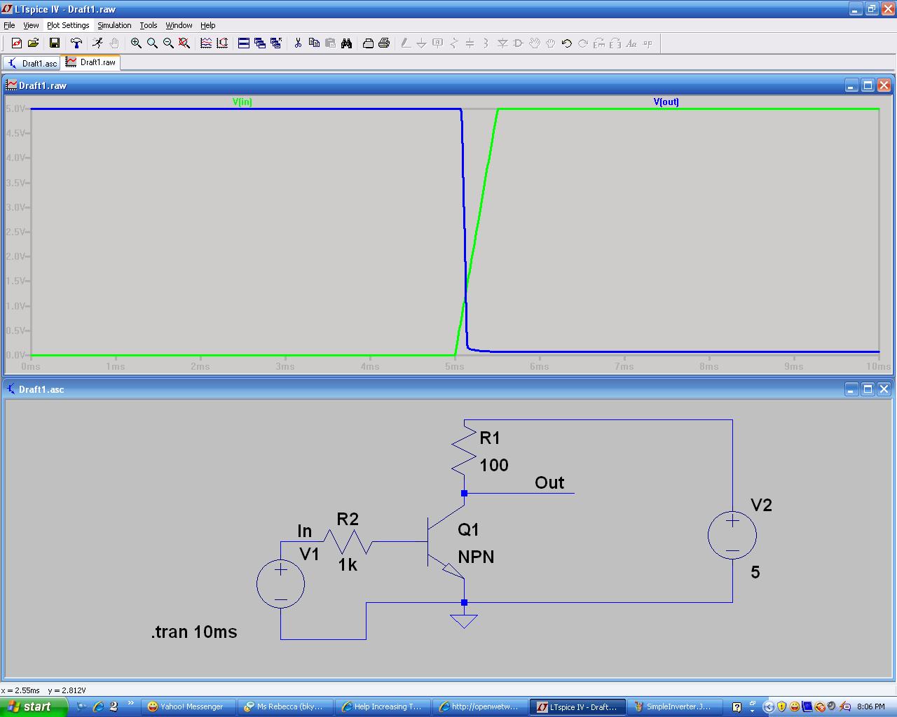

All you need is a timer configured in a monostable multibrator, aka "One-Shot." When you get the low pluse from the motion detector, that will trigger the timer. When triggered, the output will go "high" for a time period determined by a resistor and capacitor connected to the timer. That's the delay you will set.
The missing pulse detector won't work for your requirement. I won't go into all the reasons, but it's simply the wrong function.
Unfortunately, the 555 does not have an "active low" signal, so you'll need to connect an invertor between the timer and your recorder to get the "active low" signal you need. You can use an integrated inverter chip, such as this hex inverter as an example. Or you can create a simple transistor inverter. Either way, it's real simple.
Here is an example of a simple transistor inverter. The voltage source on the left represents the output of your timer. When the source is 5v, the output of the inverter is 0v, and visa-versa. The transistor can be a common 2N3904, 2N2222 or equivalent.

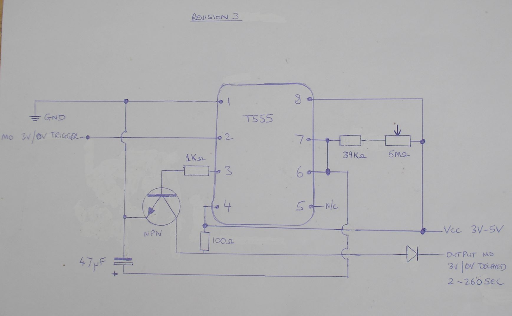

Circuit Sketch No3
All I've done here is removed the old transistor setup and inserted the one NPN inverter circuit from BrownOut above, including the resistors "as is".
Is this looking better?
Remove the diode from the output wire. The rest of the circtuit looks good. Min "on" time will be a little over a second, and maximum time will be a little over 4 minutes.
That timing will do me :)
