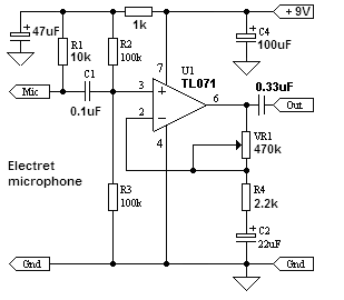

Here is a preamp for an electret mic:
great thanks, should have a go at this now.

Sorry, but still under the shackles of electronics noob. When 3 wires are connected to a potentiometer (as in this circuit), the middle one connects to the middle pin, right?

Thats right!.:)

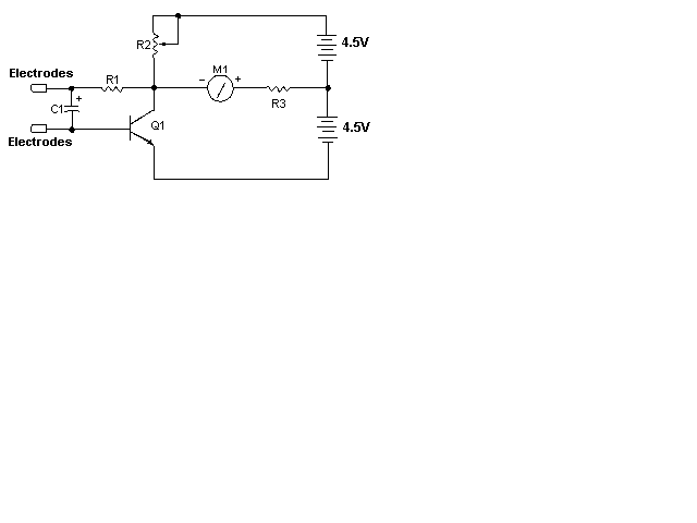

I was thinking of using this circuit of Aarons.
Just understand, the 3914 increments as a 1 for 1 value, or linear. The 3915 increments logarithmically. If you desire your indicator to express change in emotion in the form of current, then I would think linear indication is best, in which case 3914 is best suited to you app. You must decide the parameters of how your design will perform...
lol, so very? i really only want a very simple circuit to work with the chip. Most people say this works well as a simple lie detector, skin resistance??
