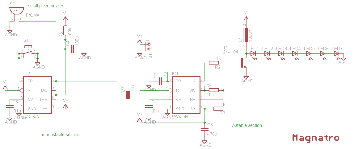

dear andrew, the inductor is used to boost the current to about 24v and due to the persistentance of vision, the flickering lights may not be visible. please look at the pdf file for simulated wave outputs,and i've posted a buzzer (look at my previous posts)
Also note that magnatro's schematic shows the LEDs wired in series - you would need to wire them in parallel.
Andrew
the out put wave form will have about 24 V peak, so in series will do. and he intended doing this with 1.5 v battery, so i tried to boost the voltage (like in a joule thief)
Also for the LEDs you have chosen, you will need a 12v supply.
- Pin 4 of the second 555 must be high for it to work - the best way to do this is connect it straight to pin 3 of the first, then connect pin 8 of the second to V+. With pin4 floating, the circuit won't work.
Andrew
yeah, that's right.. but when i designed this, i designed it in parts. and that was a mistake of me connecting the Vcc and reset pin.
the pin 4 is not floating, if it is i cannot have the wave form posted there... (see the wave form) and he want an LED flash.. not xenon for his purpose.

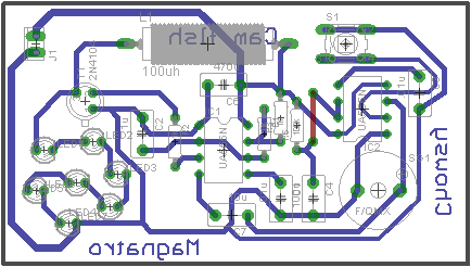

PCB for chowsy
PCB board (pdf)
View attachment untitled.brd.pdf
Pcb top
circuit diagram

That sounds to me like two monostables would be needed - one for the delay, then that activates the second monostable which sends a brief pulse of power to flash the LED and buzzer.

chownsy, look at post # 24, down load it and see if it's good or not..
It looks Good, but im not sure what that test is showing, I can see that its producing the spike of near 30v for the flash/buzzer but the time of 1 second, was that just for the test.
Which resistor and capacitors do i change for the 10 second delay (you mentioned a variable resistor Which actually thinking about it would be the best plan as it then allows me to adjust the time delay more quickly)
A parts list would be even more helpful as i cannot find exactly all the correct parts i need.
I dont want to spend money to find i bought the wrong part.
yes..it was just for simulation sake, the 30 v pulse can be used to power the leds in series for your flash.
change the r5 and c4
r5 =100k and capacitor = 100f for 10 second delay..

Also what is L1 as it was not in the list of parts.

L1 :100uH
yeah, you need a battery holder
Will 2x AA batteries be good enough for this or does it need to be a 3v lithium cell?
100uH an inductor?
it will do fine..
it's an inductor.i
