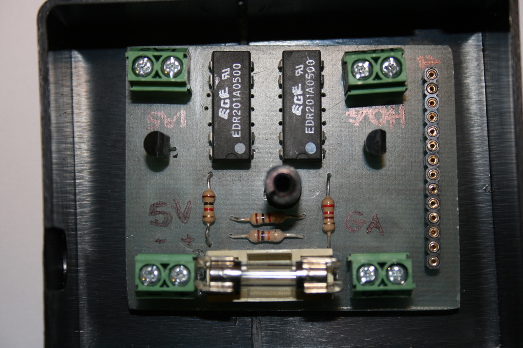

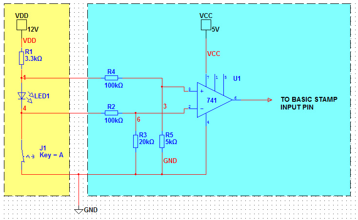

I looked at a opamp 741 as a possible solution.
I saw a circuit where a 741 is used to measure the current on a 1 Ohm resistor. I've created a circuit with this approach and would like to know your opinion if it will work if I measure the current on the LED instead.
The purpose of the circuit is to give a HIGH signal on the output if the LED is ON and a LOW if it is OFF.
Thank you
schematic-jpg.27180
That should work if you don't mind having a little current flowing through the LED when the switch is off, except a 741 won't handle the low input voltages. Use a LM393 (dual) or LM339 (quad) comparator. The output is open collector, so put a 10k pullup to +5V.

If your resistor is really above your LED as you show it, the voltage at the anode should be about 2V when the switch is closed. If you have 9.8V on the bottom wire when the LED is on, maybe the resistor is below the LED. Or maybe there are several LEDs in series.
In any case, the resistors you showed should still be used for the comparator.

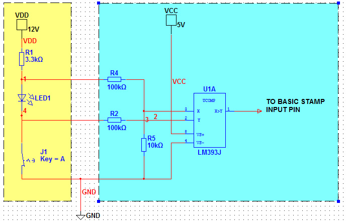

Here is the schematic with the 393 in place:
simulator_comparator-jpg.27229

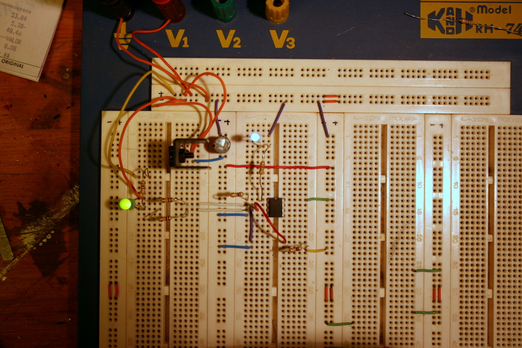

Here is a Photo of the breadboard with the monitored LED off (the green one that is connected to 12V) and as a result the white LED is also off. The heat sink is a 7805 for the 5V:
img_0218-jpg.27233

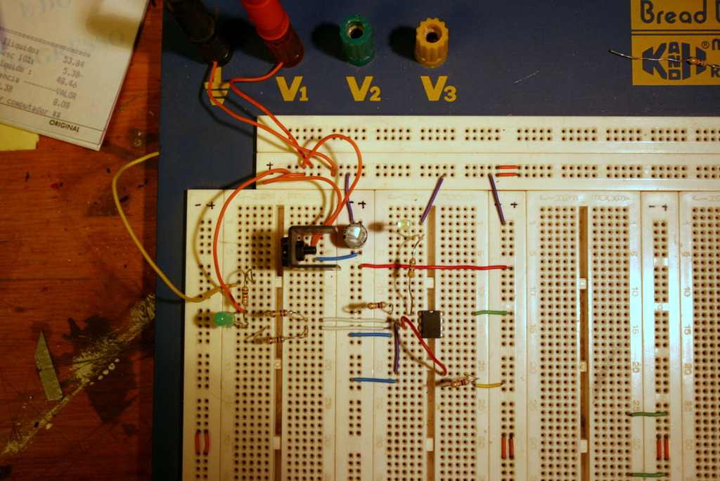

And here is a photo with the LED on, resulting on a 5V output from pin 1 driving the white LED.
img_0217-jpg.27232

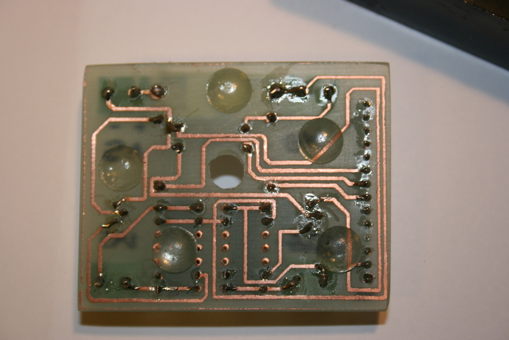

Now I'll join all the circuits together and create a PCB for a test drive.

Unless your Basic Stamp has an input pullup resistor, you should add one to the output of the comparator. Thr comparator is basically just a switch to ground (open collector), which has no pullup.
Oh yes...:confused:, I omitted those on the schematic but I planted them on the breadboard.

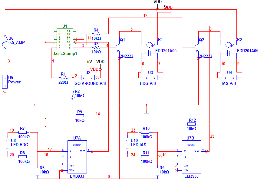

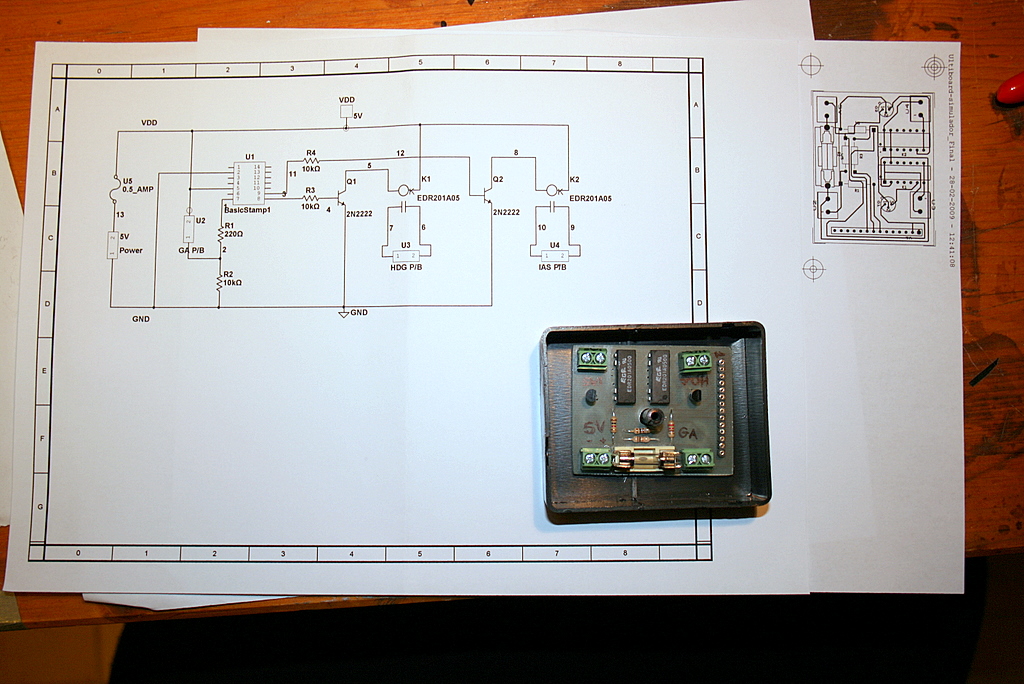

Here's the final schematic with everything put together:
final_schematic-jpg.27235
Why don't you simply connet the bottom of the LED to the input of the micro via a 100k resistor?
