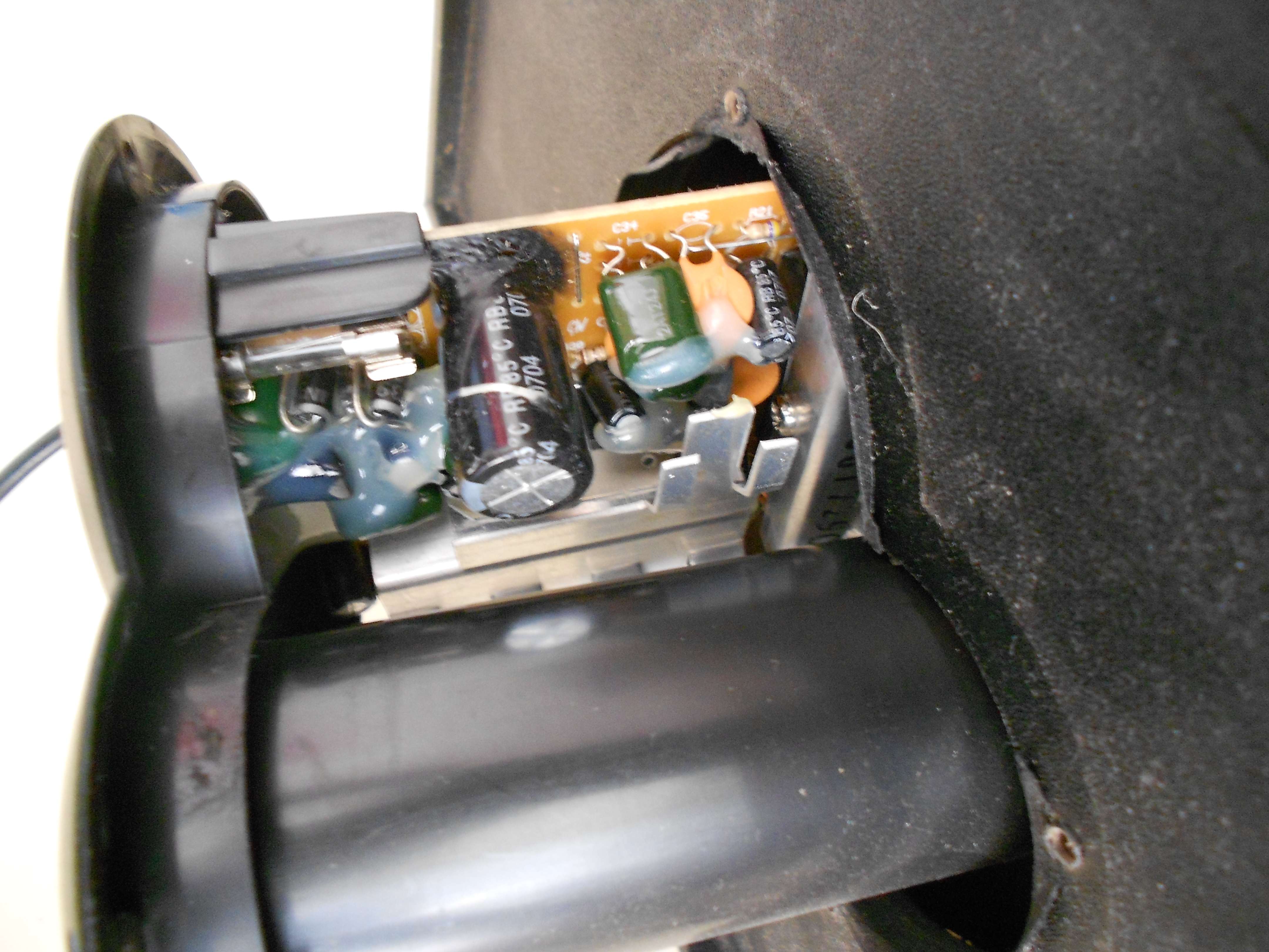

My CREATIVE 2.1(i dont know the model name exactly i think Creative 2.1-SB 250) speaker is suddenly stopped working, My two speakers are working fine but my sub woofer is not working,, please suggest a way to repair... My warranty period was over lastyear itself...:confused::confused:

I opened the woofer
i opened the woofer, in that they covered the circuit board by a kind of wax or plastic,
so can't i remove the wax and check the components?

Yes you can.
And i forgot to say that there is no supply of power for the Volume controller too..
i attached some shots of that wax covered board..
Help me to remove this wax kind substance pls..

Thats not wax its hot glue, it just pulls off. It looks like the fuse may be blown have you cheaked it? Did you cheak the speaker?

you can dismantle the woofer by pulling / destroying the front fascia. creative's subwoofer-to-amp cable are pretty short. as 4pyros mentioned, they are probably worth 20 bucks so you might want to just buy a new one.

I fixed my intermittent woofer by re-soldering every solder joint on the amplifier pcb.
