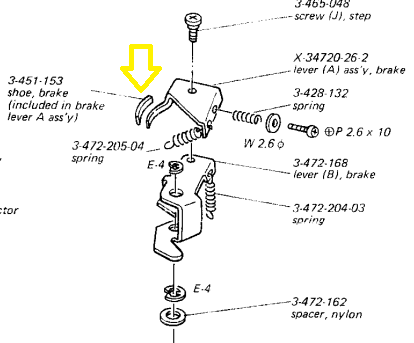

Yes, a small squirt, my mantra from now till I fix it. Jokes aside, since you're here and very helpful I wanna learn the more I can. When it rewinds, the right reel doesn't brake when I stop it, so it keeps loosing tape and I have to reset it manually, any idea about what to do?

There should be a brake pad, have you downloaded the service manual?
Pads, pulleys and belts all deteriorate with age - I used to get reel to reel machines for repair where the belts had just 'disappeared', if you were lucky a close examination showed a fine trace of dust where they used to run :D
From page 51 of the manual:
So... I managed to go to the studio and work on the recorder. The brake pad is completely flat and there is a spring that looks like it lost strength. I somehow managed to make it work by stretching the spring. It won't last till Christmas, but I'm good for now. As per the recording problem that went a little odd. I cleaned the pots with just a squirt of lubricant, but then I found out that the problem I described happened just when monitoring the tape, so i figured it had to be something with the recording head. I gave it another round of cleaning and now it seems to work. Anyway the two pots for the aux input are not working at the same level, the left one sounds less then the right one. I fed some white noise in it and I matched the levels. Now the stereo works fine and both channels sounds almost the same. Would it be a good idea to change the pots?
