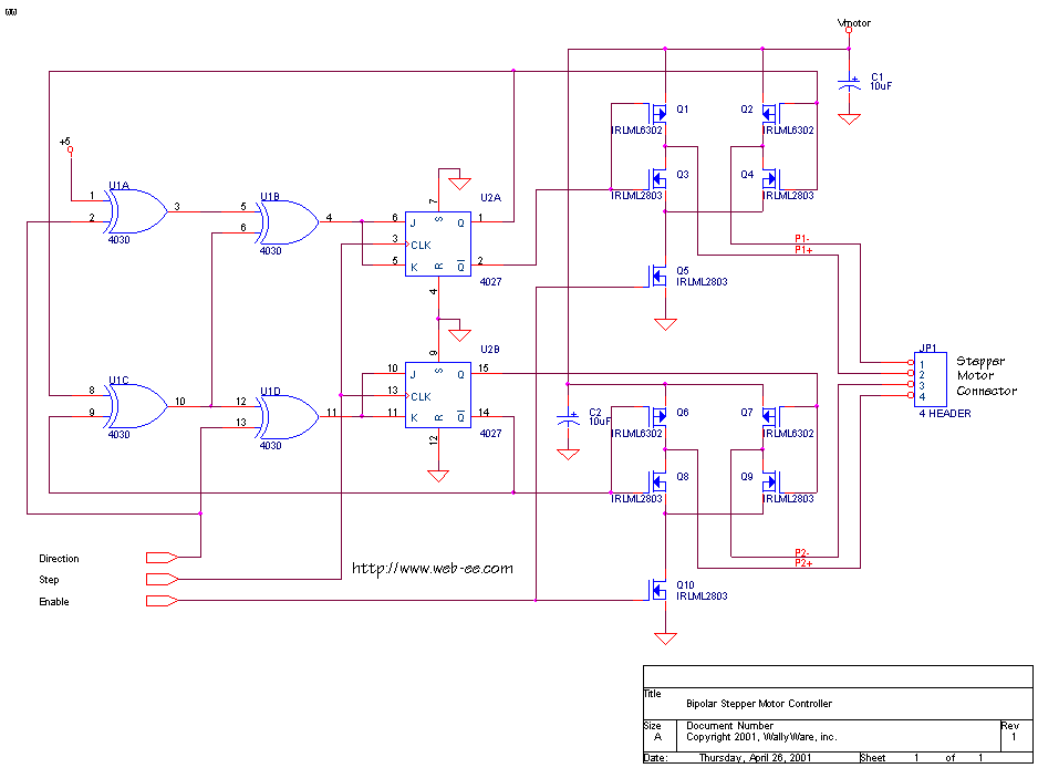

You're right. That's why I removed my post. I'm glad you asked, because that make me go look up this circuit. I plan on using it to test some surplus steppers I bought. The reason I like this circuit is because it helps me to understand the logic of driving the motors. It also shows how the leads connect to the h-bridges. If you suspect you're motors aren't working, you can quickly breadboard the ckt and try it. Inputs "Direction" and "Step" can just come from switches, and the "Enable" signal, along with Q10 and Q5 aren't really needed.

You know, I think there is an error with the circuit I posted in the way that the J-K flip flops are connected to the XOR gates. Can anyone verify?
Get the motor turning first, worry about the microphone later. Send a slow quadrature signal to the mosfets and see if the motor turns.
