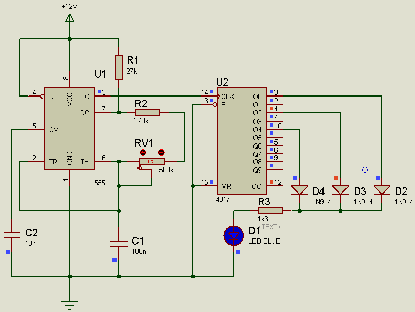

Hi delokaver,
here is something you can play with for a while.The circuit uses an astable MVV (NE555) with variable frequency from 9 to 25Hz connected to a decimal counter (CD4017).
Three output pins spaced two outputs (clock cycles) apart and connected to the LED via diodes (to prevent current flow into the output) make the LED flash three times, then pause and return to a new cycle.
Making a true SOS light signal requires at least three counters. Dashes have to be three times longer than dots according to morse rules. To obtain the required pulse lengths and pauses lots of output pins must be left unconnected.
I suggest to use an MCU for a light pattern like that.
Another easy to do circuit is double flashing with alternating LEDs, like it is used as 'camouflaged headlights' of police cars (at least I saw that on TV - very impressive)
The LED used for the circuit is a low current (2mA) LED at a forward voltage of 2.4V.
Connecting a normal LED (20mA) and using a 9V battery you might omit the current limiting resistor. That LED will illuminate a bit dim.

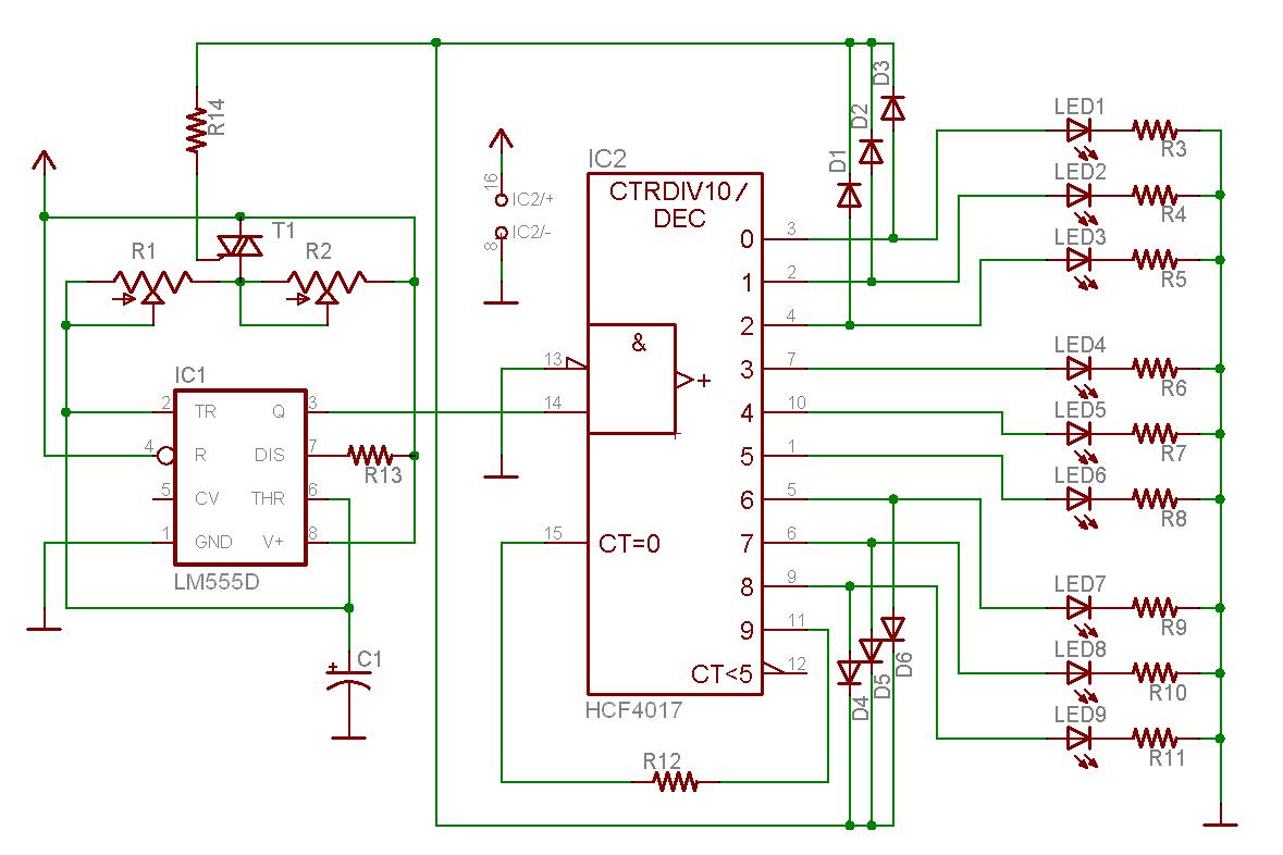

I didn't spend a lot of time and effort thinking about this of making this schematic but something like this might work for the SOS pattern you mentioned. You can vary the duration of the short and long pulses by adjusting the potentiometers.

After thinking about it a little more. You could probably eliminate D1 through D6 altogether in the schematic and instead just connect those wires directly to each LED's cathode.

Sorry vne147,
that circuit flashes nine LEDs in equal sequence. (LED chaser). The morse code again is: ... --- .... (from one transmitter to one receiver. Here you have 9 receivers.) The 4017 counting pattern looks different.
There is no break between 'signs'. If one output goes low, the next one goes high simultaneously. You could wire three outputs together using diodes to obtain a dash, omit one output and use the following to 'write' an 'e' (single dot).
So simulating a true SOS will take three CD4017, occupying a total of 28 outputs for an SOS and 5 time units break between transmissions.
Also the CD 4017 doesn't take care of pulse length, just freqency. It advances one count with each positive going pulse edge. So using 'PWM' is nulled by the 4017. Its outputs have a duty cycle of exactly 50%, no matter if you use duty cycle of 99% or 1%.

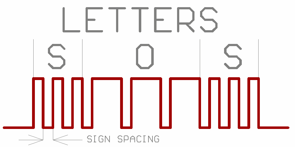

Here is the SOS as it would look on an oscilloscope. Normally the letters have to be spaced by 3 time units. (Words must have a spacing of 5 time units.) SOS is considered to be one letter and therefore spacing is equal.
To achieve just an 'S' requires 5 output pins: 0,2,4 for the active phase, and 1 and 3 for the pauses between pulses. The schematic I made in a former post represents exactly one 'S' followed by a long break.

Like I said I didn't spend that much time thinking about it. It was just an idea. I don't think it would flash 9 LEDs in equal sequence. the middle three would have a longer delay between them. However after thinking about it a little more, I'm fairly certain you can accomplish the SOS pattern with only 2 4017's. I don't have time to make up a schematic right now but I'll post it in a day or so.

after take a look with your circuit, i found some thing strange, what does T1 means above the 555 ??? is this a transistor ro what ?? could you please help me and let me know ??
hi vne147,

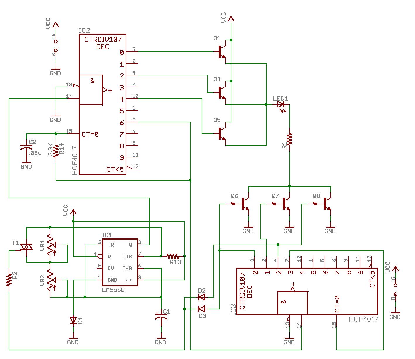

Delokaver,
T1 is a triac. When T1 is active it essentially shorts across one of the pots next to the 555 and has the effect of increasing the frequency of the pulse train coming out of the 555. That is how you get the ... --- ... pattern that you are looking for. For the ... part the triac is active and allows current to pass. For the --- part the triac is not active, current has to pass through the extra pot, and the frequency of the pulse train being output by the 555 decreases.
Boncuk, what do you think about this circuit?

A more standard 555 circuit and simply routing the diodes to a second timing resistor instead of an SCR (which probably won't work do to SCR limitations) and taking the output of the 555 to drive the LED as well will give him the "SOS" flashes.
Can you give an example of simply routing the diodes to a secondary timing resistor? I don't think I'm following you. Also, the symbol in the schematic is a triac, not an SCR. I don't think they are the same thing. I'm not sure what limitations you are referring to and if they apply to triacs as well. Could you please elaborate?
Delokaver,T1 is a triac.* When T1 is active it essentially shorts across one of the pots next to the 555 and has the effect of increasing the frequency of the pulse train coming out of the 555.* That is how you get the ... --- ... pattern that you are looking for.* For the ... part the triac is active and allows current to pass.* For the --- part the triac is not active, current has to pass through the extra pot, and the frequency of the pulse train being output by the 555 decreases.Boncuk, what do you think about this circuit?
