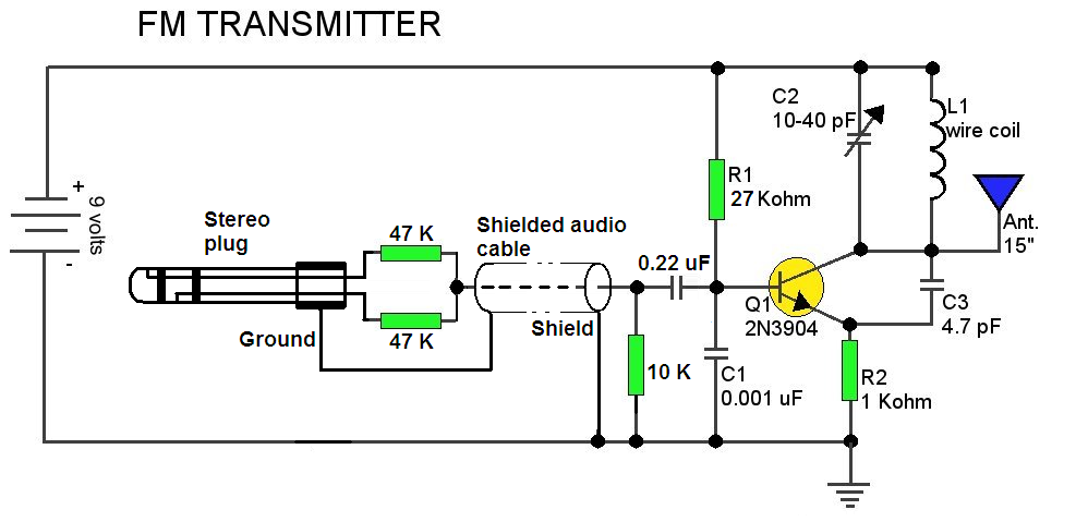

hi, I had found this diagram for a small FM transmitter, and I was wondering if there would be a relatively simple way to change the mic for an audio jack so I can plug it into my mp3 player to listen to songs on my car audio...
I looked at some of the transmitters on this site, but I think I'm going to go with this one, as I find it simple, and only need like 10 feet range (not even probly...)
Is there a way I can modify this circuit to have an audio jack rather than a mic.?
Thanks for any help
rip out the mic, connect the base of the transistor to a capacitor. Now connect the other end of the capacitor and the -ve to your MP3 player speaker output.
k, so the +ve of the speaker output just goes to the other place that the mic connected? also, any certain capacitor in particular?
Right?
Also... do you think this could cause any damage to my mp3 player? (i don't think it can... just checking...)

like this?
Since the 15k resistor won't have the current of the microphone in it, increase its value to 27k.
A 0.22uF coupling capacitor from the MP3 player is fine. You should connect both stereo outputs from the MP3 player each to a 47k series resistor. Connect both 47k resistors to the coupling capacitor and a 0.1uF capacitor can be used. Connect the grounds of the MP3 player and transmitter together with the shield of audio cable and the audio signal inside it.
It is not necessary to connect the MP3 player's output "backwards". Just connect its output to the coupling capacitor added to the transmitter and connect the grounds together.
Keep the output level of the MP3 player very low because the transmitter's input is very sensitive.
That FM transmitter is so simple that its radio frequency will change all over the place if you get near it, if the battery voltage changes or if the temperature changes.
Since it doesn't have pre-emphasis (treble boost) like radio stations have and radios have the opposite, reception from it will sound muffled without treble frequencies. :lol:

Hi Draco,
Your 2nd FM transmitter circuit has all problems the same as the other one.
I added a 10k resistor to this diagram of the 1st one:

What will the new resistor do?
It attenuates the input audio signal so that the level on the MP3 player won't have to be turned so low.
I've read that you have to use ceramic capacitors for transmitters like this... just checking if thats true...
Yes, for the RF capacitors such as C1 and C3. The audio coupling capacitor and the trimmer can be plastic.
Also, it won't work if built on a breadboard. These VHF circuits must have very short wires.
I'm also just curious as to why the freqency would change all over the place so easily
The tuned circuit of L1 and C2 and anything capacitively coupled to them determines the tuning radio frequency:
1) The antenna. Anything near it changes its capacitance.
2) The battery voltage. The transistor's capacitance changes with voltage so that it performs frequency modulation. When the battery's voltage changes then so will the transistor's voltage.
3) Temperature. The transistor, coil and capacitors characteristics change with temp changes.

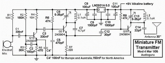

My FM transmitter project works perfectly. I used an RF buffer amplifier transistor to isolate the RF oscillator from the antenna. I used a low-dropout voltage regulator so that the 9V battery's voltage can drop to less than 6V before the RF frequency is affected. I used low distortion circuitry and pre-emphasis so that the sound is superb.
It goes more than 2km though, which is too far for your application. The day after another guy built it, he saw the RF cops in their truck with the antennas on top slowly go down his street. I told him they were looking for me!

Hi again, I haven't been able to get parts to build anything yet, cause the last place in town to sell components was Radio Shack, which became The Source, and no longer sells components... anyway, because of the delay, I was thinking I might build your transmitter instead Audioguru, but I was wondering how I'd go about making the range small enough to be legal (and how to change it to use audio input from MP3 :wink: ).
Also, just wondering if you could give me an estimate of how much it cost to get the parts needed to build it (and what is the box with I O on it... I'm really new to this, I know the basics of circuit diagrams and stuff from school, but haven't really made any cicuits myself before)
Adding an emitter resistor to Q3 should reduce its range.
I removed the mic and R1 to test it. I made an input attenuator with two 47k resistors from each channel of my music source to a 3k resistor to ground. Of course the grounds were also connected together.
I have no idea how much it costs. $10.00, $15.00? I already had the parts.
Look them up and order them online at www.digikey.com or www.newarkinone.com .
The LM2931A5.0 is a low-dropout 5V voltage regulator IC that allows the circuit to continue working well when the battery voltage drops to about 5.6V. I = its input and O = its output.
I'm really new to this, I know the basics of circuit diagrams and stuff from school, but haven't really made any cicuits myself before{/quote]
Circuits that operate at these very high frequencies need a pcb or a very tight Veroboard layout. Perhaps it would be best for you to make a kit as your 1st project. :lol:

by the way, do the caps have to have a specific voltage rating, tolerance etc? or for tolerance is it just lower is better?
also, could you tell me which caps have to be ceramic in the diagram you posted?
