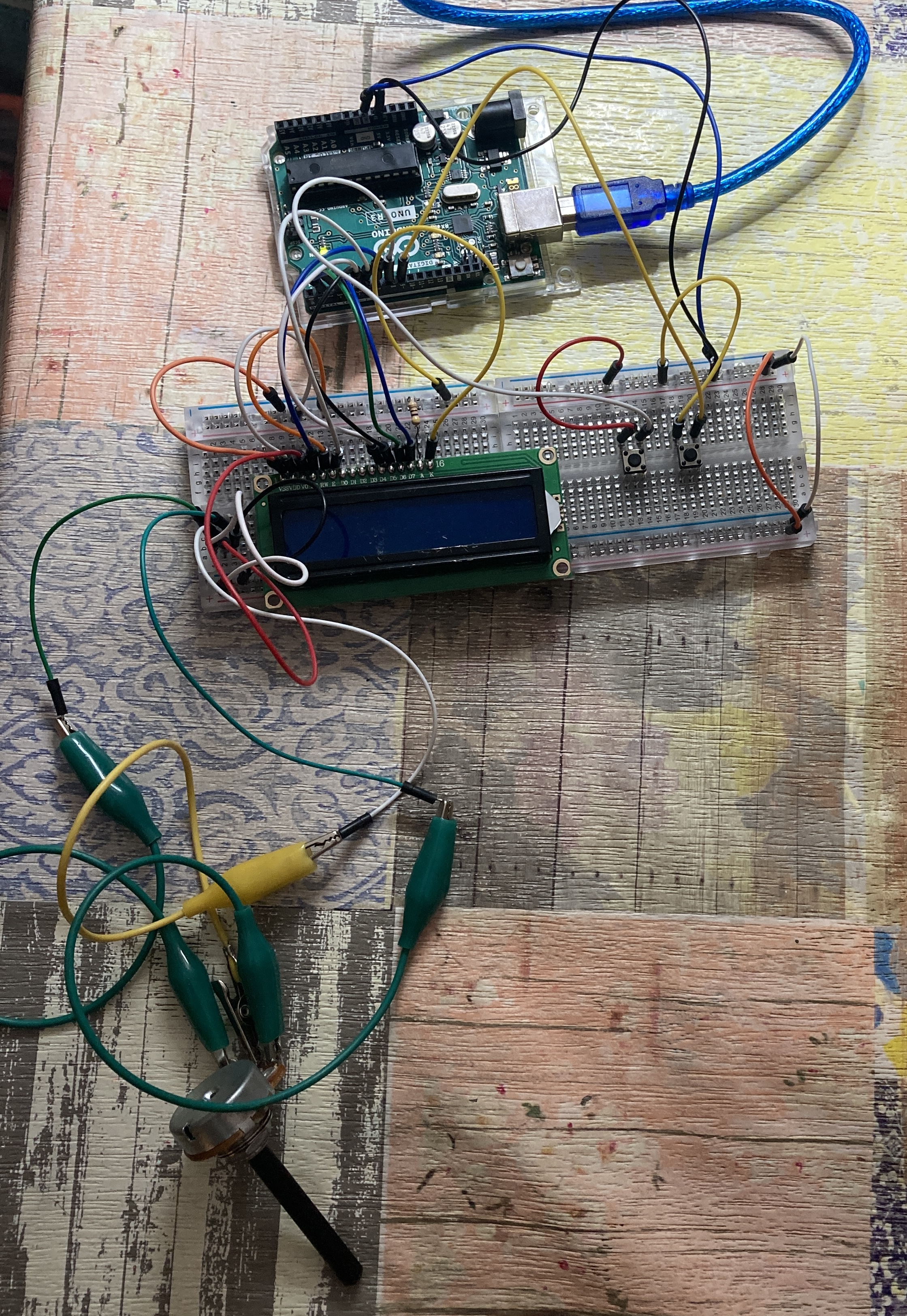

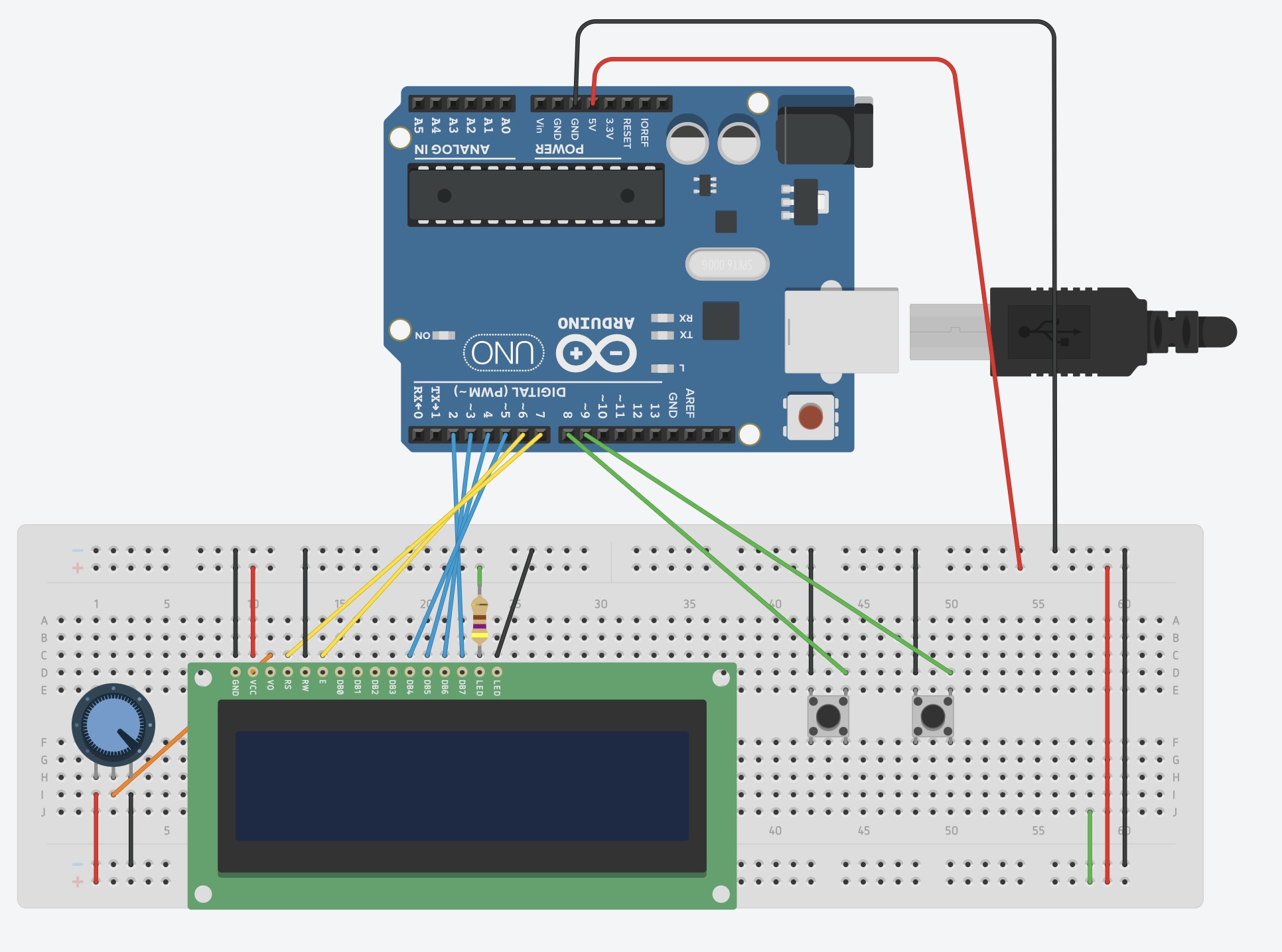

Whilst my circuit works online perfectly, the LCD won't even turn on irl.
The bullet points below cover basic problems that haven't solved my problem
- I've meticulously checked my wire connections, so that they're the exact same as online and securely connected, and bought the LCD already soldered (I think they're soldered perfectly fine).
- The Arduino is turning on, but no response from my LCD (except from when I removed the wire connected to the E pin and got small flashes on the side, or whilst I was checking the VSS and VDD pins I saw light flashes - so I THINK its a working LCD)
- The code works online, so I copy/pasted onto the Arduino app, downloaded 'LiquidCrystal' library for the '#include <LiquidCrystal . h>' bit. ( idk if it matters but I did it anyways)
My voltmeter is labelled 'B10k' so I'm assuming that means 10k ohms, like my online circuit, so I don't think its my voltmeter but idk, that could be it because...
I assume the problem is something to do with the backlights (I've toggled around the potentiometer and literally nothing happened) ?? Either that or connection issue, but idk how due to the first bullet point.
Soooo I'm stuck, I have no clue what the problem is, although this is my first proper use of Arduino so I'm assuming it's a simple issue I'm overlooking?
I've added pictures of my circuit (sorry for the messy wires - hopefully it should be easy to see it's the same as online) and a copy of the code, because at this point the problem could be anything.....

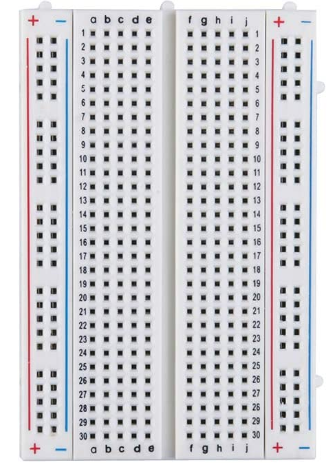

Something to consider with your solderless breadboard is the power rails. Are they continuous on each side? I see your jumper side to side but does each rail extend the full side of the board? Just as an example:
Note how the red and blue power rails extend the full length of the board. Some boards have breaks in between the sections.

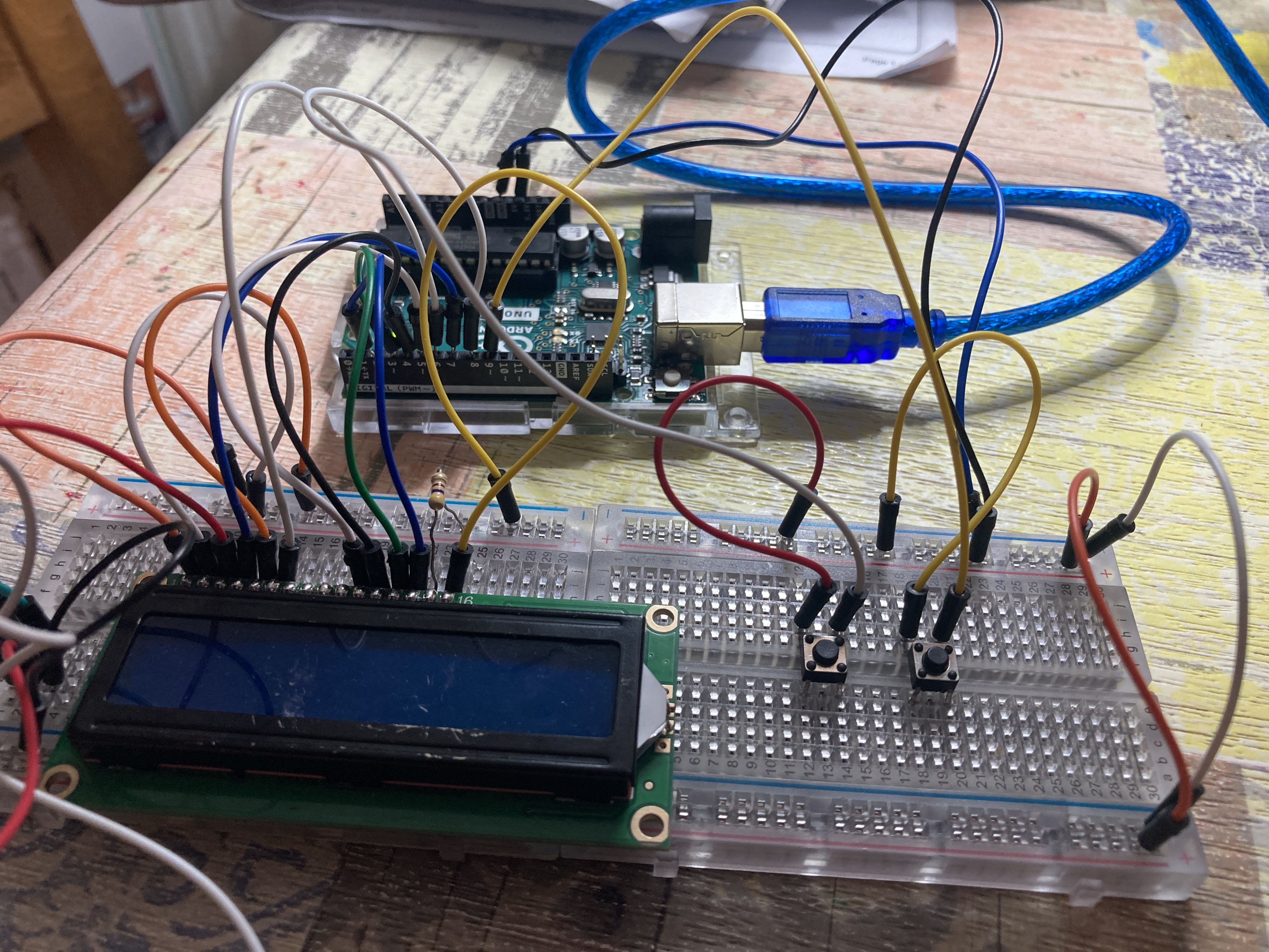

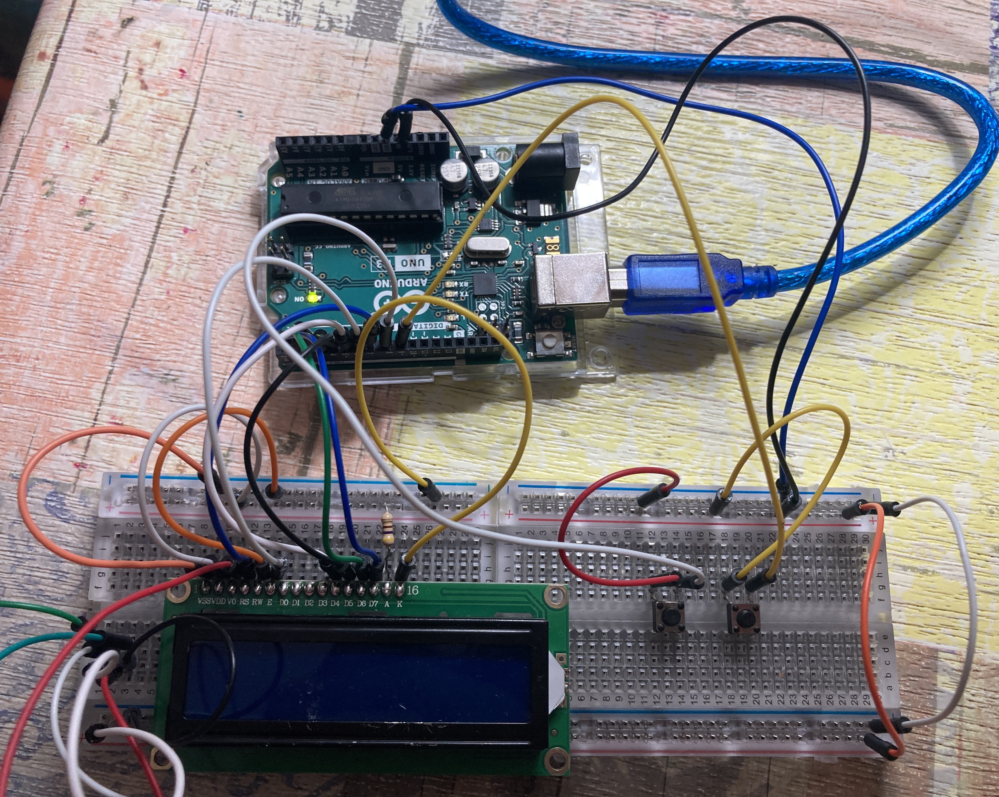

I agree with Reloadron, you have used two breadboards which are shorter than the one in your "schematic layout" diagram,
Looking at the pictures of your build, you do not seem to have any links between the power rails on the two breadboards.
Add a cap across the supply rail too. Check all grounds and Vdd.

This was one of the two problems before my circuit started working (which it does now, so thank you so much!). Once I connected the breadboards with wires, the backlight started working, but the potentiometer was off. So I directly connected each of the potentiometers pins the the power rail and designated pin for the LCD on the breadboard, and it worked (after adjusting the contrast of course)!
Glad it came together and worked out for you. :)

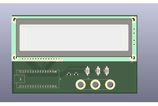

Good to know that your project is working finally. By the way, if you consider making a PCB, you can use an Arduino Nano instead of UNO. You can make a PCB like this:
That will make your project compact.
