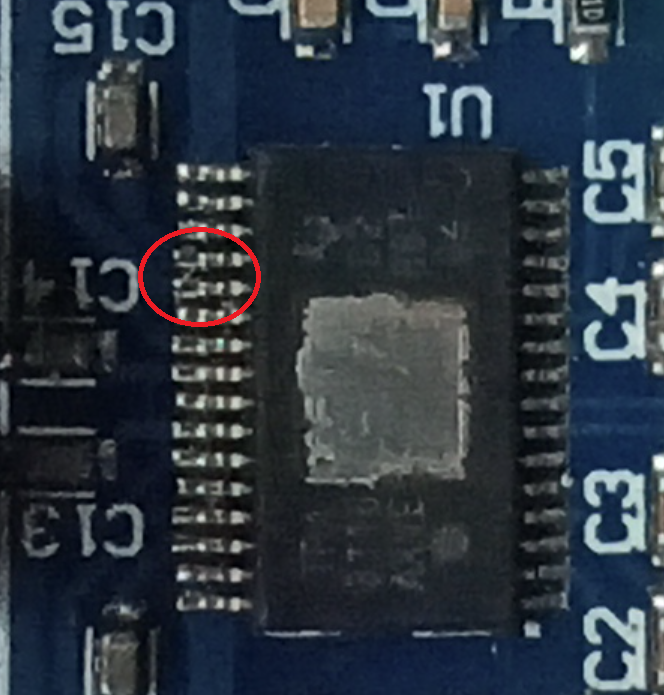

I got this amp a while ago and now that im testing it, its heating very quickly, qnd the led is blinking, which i suppose should be, ik an amp is supposed to heat up a bit but not to the level that i could burn the finger when touched, i have add the pics, if anyone could help revive it, that would be a great help, also i did attached my testing speaker to see if there was any noise when i turn it onn, but there wasn't any.

Which terminals did you attach it to?
I see L+, L-, R+, R- on the underside of the board. I'm guessing it's a bridge-tied output.
Your amplifier appears to be well used and not new.
Where did you get it?
Was it said to be working?
There should be a heatsink mounted on top of the IC.
Look at this one, which seems to be very similar to yours:
My best guess is that the IC is damaged.
But, have a look here:
Is that a solder blob shorting two pins together?

Mann, i didnt even saw that, also i did bought and used it for a while, it been like 8-9 month since then it was in my bucket with all the other apms, ik i it works for sure but now that im using it, its not working, ill look into that pin shorting problem, and mann even i didn't notice that, thanks for noticing and pointing it out for me, ill update what happen next, and yes it also got a heatsink like that but ik for sure that class d ics like that aren't supposed to leave a burn mark on the finger when touched

You could try using external power to reduce heat with 5V for debugging (4.5V min), although it is probably damaged inside.
Check if Fault pin is active. If one of the bridge-tied switches has faulted it will dissipate too much heat.
https://www.ti.com/lit/ug/slou336b/slou336b.pdf compare with eval board. Record test results on pins here.
