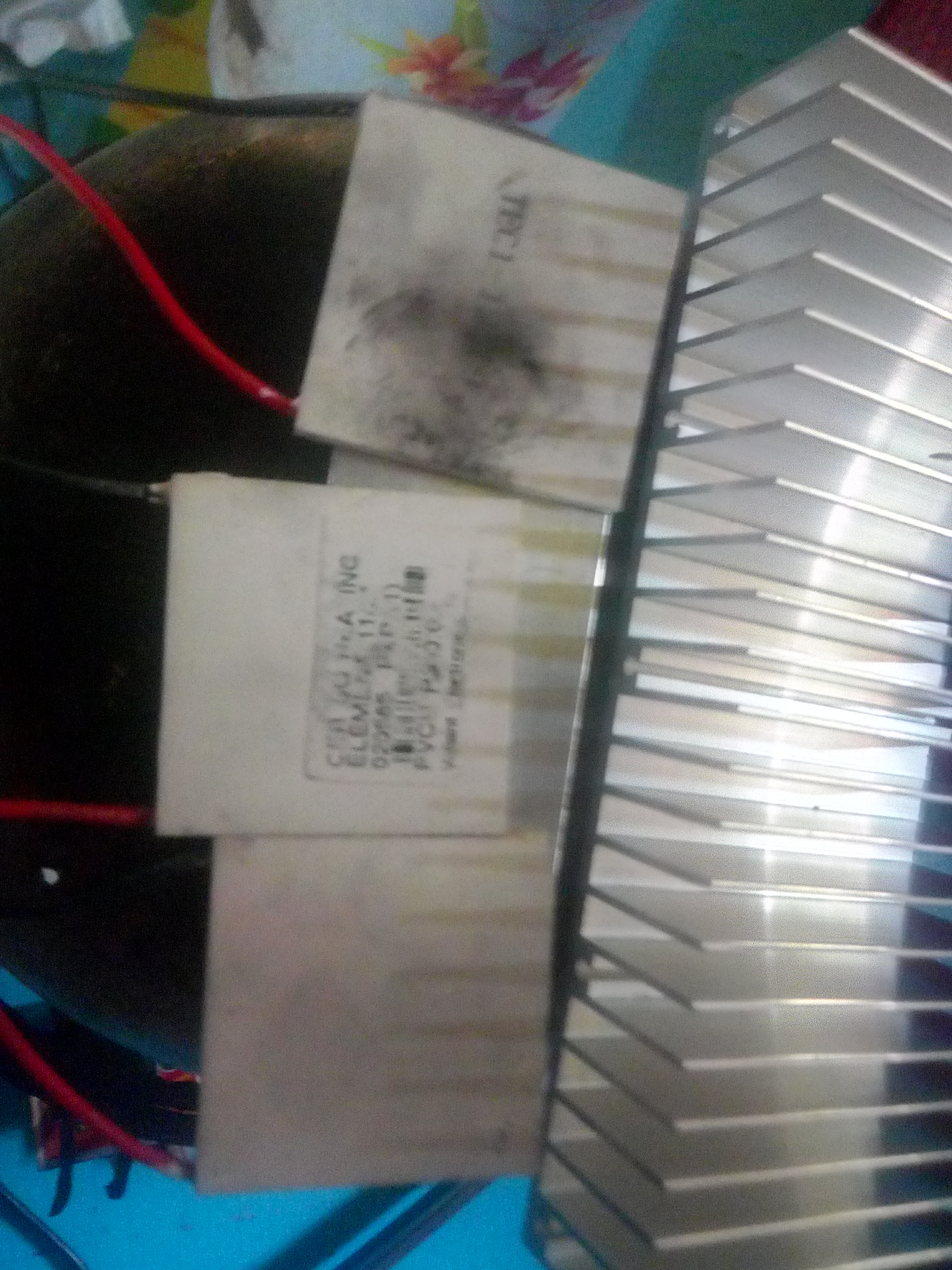

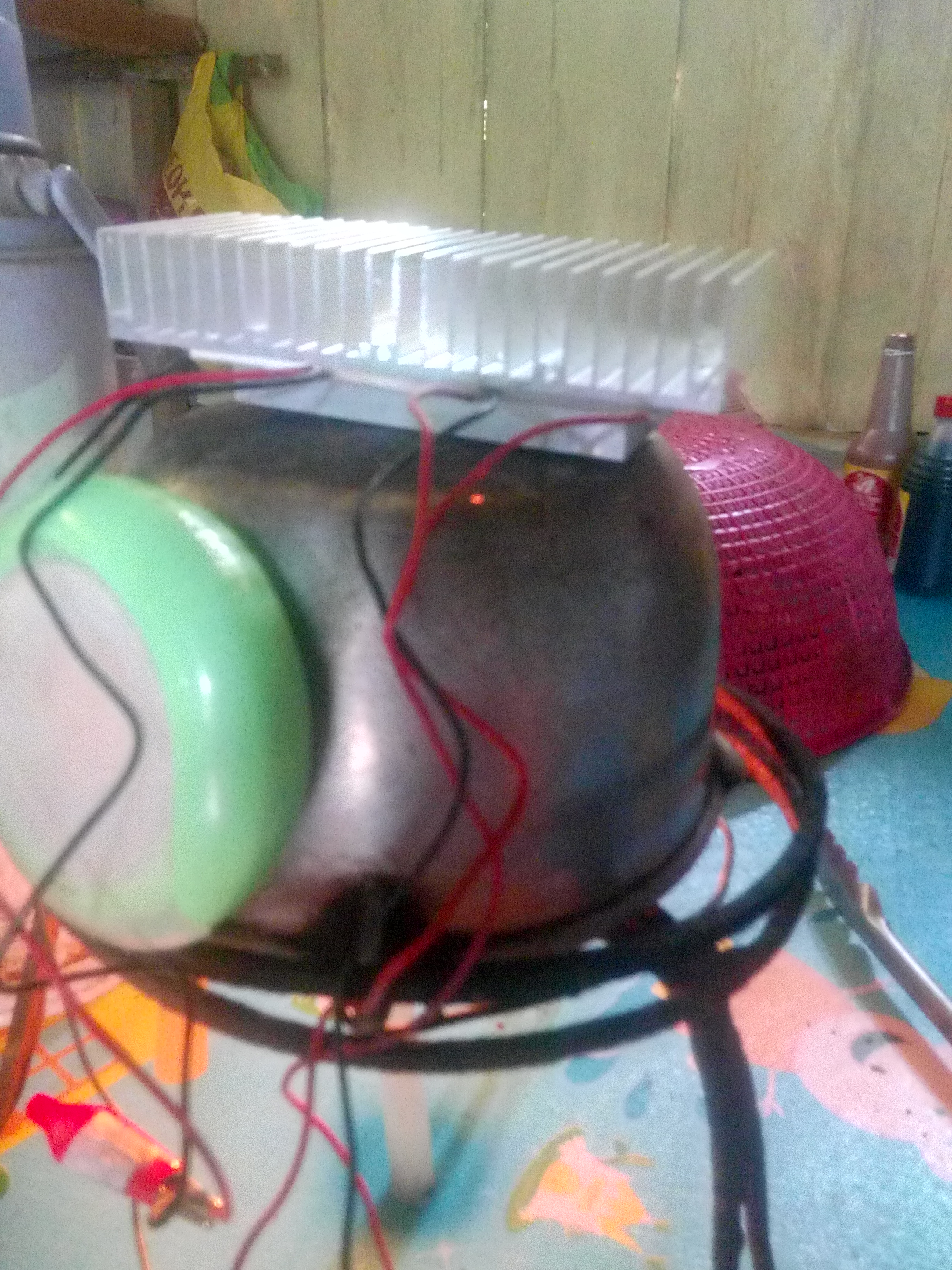

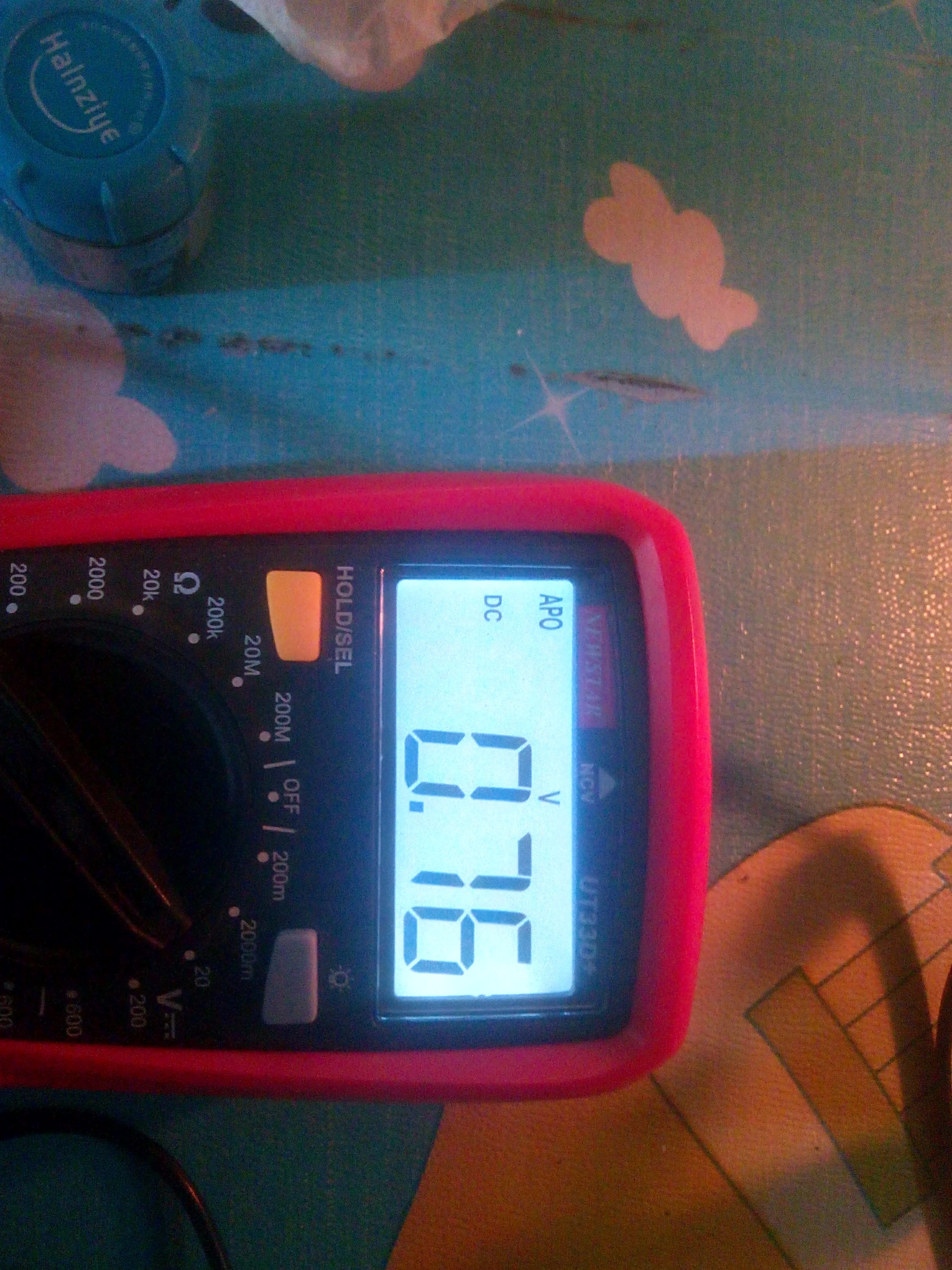

Hey you guys. I badly need help for my school project. I can only produce .8 Max voltage from my 3 peltier module-series setup. How can I enhance the voltage aside from using booster? I'm afraid to add more heat at the bottom because I had experience once my module exploded due overheat. Kindly See attached files

It looks like the "cool" side is still above the heat source; that should ideally be in a separate air stream or duct, so heat is taken away as effectively as possible.
Also try cleaning the modules & removing labels etc. then adding some grease or heatsink compound between the module surfaces and the aluminium block / heatsink.
The more effective the heat transfer in and out, the more output you will get.
Remember, the output of the peltier module is based on the difference in temperature of the two sides. Not the absolute temperature.
