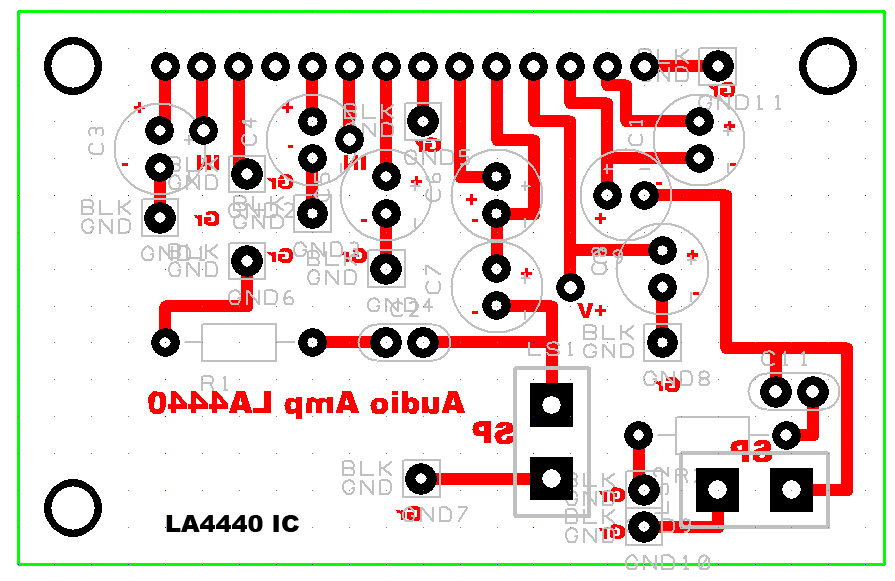

Audio Amplifier LA4440 IC
Can you tell me the correctness of the circuit diagram? As I can buy it from the market but I want to make it by myself for my satisfaction. If anyone can help me I will be very much happy for your generosity!
Thank you !

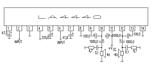

can you give us the schematic instead of the PCB? because it is more easier to know if the cct is right or wrong!
Stephen87,
Thank you for your reply ! Take a look at the schematic and tell your views on it !

No, it has many errors:
1) It is missing the important 4.7 ohm resistors in series with the 0.1uF capacitors at the output so its outputs are shorted at high frequencies.
2) R1 is not needed so it matches the missing resistor on the other channel.
3) The value of the output capacitors is so low that low frequencies below 180Hz will be missing when the speakers are 4 ohms.
The datasheet has a correct pcb design that should be used.

If this circuit which I use and what will be the ultimate effect on permormance ?
I don't know if the IC oscillates at a high frequency with the missing 4.7 ohm rersistors. With the output capacitor values too low then bass frequencies will be missing.
Why don't you use the correct schematic and correct pcb design shown on the datasheet?
This is one of 3 amplifier pcb's you are designing wrong.
What should the output capacitor value as you are thinking ?
Unless I make the mistakes I could not make my ultimate PCB !

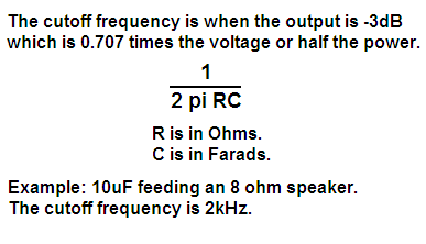

The value of the output coupling capacitor depends on the impedance of the speaker and on the frequency you want the output to be at -3dB.

Over two weeks ago you made a pcb for the obsolete Sanyo amplifier IC. Its recommended pcb design is in its datasheet so we don't know why you don't use it.
Maybe you should make your pcb so that you can find out that you did not research the different sizes of the capacitors and you will find that the 1000uF capacitors are much bigger than the 47uF capacitors then they won't fit on your pcb.
Maybe your pcb design will cause high frequency oscillation.

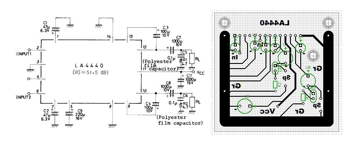

Here it is my final PCB of LA4440 IC ! I am not asking for any comments about it as it is 100% correct !
