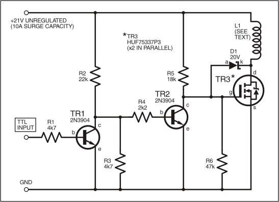

I wanted to use the pic-gen but as mentioned it generates as pos and negative value, I need to get a positive dc offset square puls, from between 0.1 Hz to ± 4Mhz. Wanted to use the pic-gen to drive a 555 or something similar that will give a positive puls, and in turn then drive a Mosfet or two that will puls a air coil at about 24vDC at 5 -10 amps.
Won’t it work to just drive the mosfets directly, because they can only be on or off. The spec on the Pic-gen says it can give +5v, is that enough to drive the mosfets full out.

I found this circuit, can I use the square wave output from the Pic-Gen to drive this circuit.
I only have IRF540’s can I use them instead of the HUF75337P9 mosfets.
Virus
