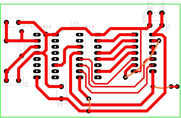

i meant the pins, it need a shift by one bit lower.ie if one pin of AND is conncted to Q6 it has to be connected to Q5 and so on.
so like this?
just a final check before i develop the pcb.

if you have an oscilloscope you can check it easily by checking correct 200Hz. then check the states.
did you use the right crystal?
whats your AND IC? which PCB did u use as final?
any how if you have made anything wrong, still its not hard to correct it since, its the matter of changing some pins of 2nd 4060.
i used this sircuit and i used the 74hc11, 3.2768mhz crystal
i dont have an ocilloscope :(

did you etch the PCB? or you just wired? what i suspect is that you have made some connection wrong. make sure the pins 7,5,4,14,13,15 &2 are the only out puts connected to AND gates.
yes they are all the right ones, and i etched the pcb
are you sure you told me the righ tpins? maybe you said one pin wrongly, or miscalculated it?

you have to divide by 12,000 in binary it is 0 1 0 1 1 1 0 1 1 1 0 0 0 0 0
so its like this........................................... Q14 Q13 Q12 Q11 Q10 Q9 Q8 Q7 Q6 Q5 Q4 Q3 Q2 Q1 Q0
i took it as above, if i have confused with this then Q0 is not correct. I THINK MY DIAGRAM IS CORRECT. but i asked you to change it, so just wire it again as it is on the diagram, ie connect pins 5,4,6,13,15,1,3

okay so is what you said correct then? because i am going to have to remove soem copper tracks and rejoin pins, i dont want to do that for it to be wrong, are you sure?
you have to remove only 3 connections,
cut pin7 and connect it to 6
cut pin 2 and connect it to 1
cut pin 14 and connect it to 3
hope it will work this time.
Edit: i remember the timing diagram and its ok this time, if the input to 2nd 4060 is 200 Hz then without any doubt you must get a pulse every 1min. once you finish it give a feed back
yeah the 'minutes' are about 5-4 seconds short, maybe it was the quality of the crystal
i might try find a better quality crystal, and see if that helps
