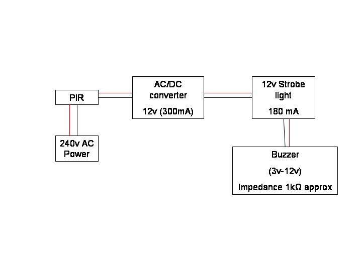

I have set up a deterrent to try and stop fuel thefts. I have a normal 240V PIR motion sensor, which is live, then activates a blue strobe light and two small buzzers. In between the PIR and the strobe/buzzers is a AC/DC converter which takes voltage down to 12 volts. The strobe light uses 180 ma and the buzzers even less. All works well but my problem is that when the PIR switches off there is still enough residual current to activate the buzzers continually and make the stroble light flicker occasionally. Presumably this is because the PIR is always having a small output? What do I need to do? Put something between the PIR and the strobe/buzzers? Novice here so all help appreciated! Thanks in anticipation
Hi, this is my best attempt at a drawing

I assume the PIR activated output is 240V, which is then converted down to 12V and given to strobe and buzzer both are connected parallel. The PIR should have adjustment for activated and stay on time delay, photodiode sensitivity control etc. If these won't help you to solve, there must be a fault in the PIR assembly. Open and clean the circuit well.
satchmolips, you've options are there. First measure the voltage output of 12v dc converter at residual session. Add a voltage dependent transistorized external strobe/buzzer driver. It should have a voltage sensitivity pot. :-)
the PIR has a relay?
its not uncommon especially if its handling 240 volts IMO
I suggest taking the cover off the PIR device and see whats in it.

Your PIR output device is probably a triac, so there's a snubber across it. It's likely to be of the order of 0.47 µF in series with about 220 ohms. You loaded the output so that the leakage doesn't trigger your load.
A triac feeding a transformer can be dangerous. It can trigger on half cycles, resulting in DC, damaging the transformer. Fortunately your 60W lamp also resolves this risk.
If you want to avoid this problem in future installations, use only PIRs that state that they can be used with fluorescent lamps. These have circuitry (usually a relay) that has little or no leakage.
