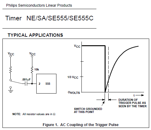

Problem is, I have a weird way of getting the 555 to make the necessary pulse. I'm basically using this.. **broken link removed****broken link removed**
It's designed so that the pulse only lasts the specified length no matter how long the momentary button happens to be pressed. This is exactly what i need, rather than needing to press and release the button a nanosecond :) And i DO have it working, however i can only get it working when i simply switch on and off the actual +5 rail itself. This seems to do the trick.. on the scope, the pulse is exactly what i specify with the "Ra" and "C" above. Looks great. But, this is not how the circuit above is laid out. I've tried redoing and triple checking the above circuit, and never got it to send a pulse other than when i just powered the darn thing up. Nothing whatsoever showing up on scope. Spent hours just making sure it was perfect. So, i relocated the momentary switch to be the main power switch for the IC and just jump'd the spot where the momentary used to be in the schematic above.

Or, how can i get the above circuit working? I'm powering it with +5VDC. I've separated it completely from the rest of my circuit, and recreated it exactly as above, a few times over. I get nothing on the output with that circuit. As an easier test to measure, I've been using a .1uF cap and a 1M resistor. This gives a nice clear 100mS pulse. When i switch the power to this 555, the scope indeed shows a nice clean approx 100ms pulse. But i can't get that 100ms pulse with the above switch design.

Add a 10K pull up resistor from the switch/capacitor node to V+. The trigger circuit works only if there is zero charge (both pins at V+) on the capacitor when the lower end is switched to GND.

This is from the original NE555 datasheet:
