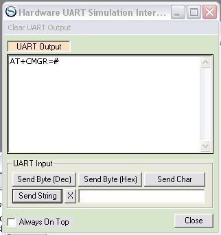

The following code is programmed to keep polling the UART until a ',' is received. The program will then take the next character after the ',' and store it into a variable which I have set as D4.
This next character expected is a '1' and I have tried it out in simulation (refer to attached picture)
After storing the character ('1') into D4, I intend to append this variable to a string and send out the string through the UART as follows "AT+CMGR = 1"
However, from the UART hardware simulation (as attached) I am sending out "AT+CMGR=#" instead of "AT+CMGR=1"

As I have saved the incoming character of '1' into the w register, is my method of transferring the value in the w register to a variable correct?
movwf D4
thanks!
Your code looks fine and I would suggest that the character received after the comma is a '#'.

i have inserted that line to gauge whether its a timing problem or not but i still get the same results in the simulator..
I guess its the nature of the simulator to do output received bytes as a '#'?

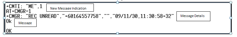

i have further developed my code and my pic is able to receive an SMS through the Handphone via the CMTI AT Function. Upon receiving this new message indication , im sending out the command AT + CMGR =1 to retrieve the message from memory location 1 of the handphone. I have inserted an LED indicator when a new message is received (by the lighting up of Port B movlw 0x0F) note that at this point, the message has not been read yet but just indicated as arrived. Oh and all Port B pins are connected to LEDs.
My questions are:
1).I have attached a picture showing the Hyper Terminal Results of the executed command and result codes of this process to retrieve a new SMS .
Back to the PIC, When i am sending out AT+CMGR=1, I would not only get my message but a prepended string of message details in a line above the message that I want. I do not want to store these details so i keep waiting until the ' " ' right at the end of the message detail line followed by waiting for the CR and LF (shown in the code below in bold) before i start reading.
I have commented out the waiting of the LF at this point (highlighted in red) because I discovered that when I do not comment them out, the LEDs connected to Port B to determine that a message has arrived will only turn on for an extremely short while and will immediately go off followed by the flickering of other LEDs connected to portA (which I have connected LEDs to as indicators for the AT configurations (Refer 4 posts behind) the pic starts to act wierd at this point..other than that the LED will just turn on nice and fine.
Is my assumption in waiting for a "<CR><LF> correct?
is the end of the message detail line a "<CR><LF> or is it just a "<CR> ?
i've managed to find out the problem above. there was a buffer overflow in the code..
