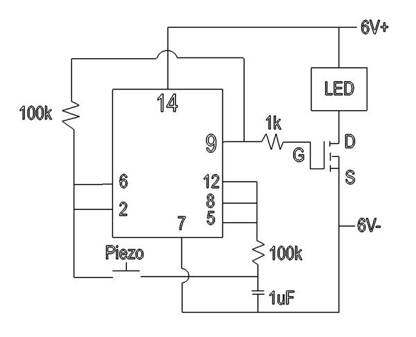

I am building a SCUBA torch using a piezo switch (these work well underwater) and two LED heads.
The sequence I am after is;
First press...LED 1 on,
Second press... both LED 1 & 2 on.
Third press...both off.

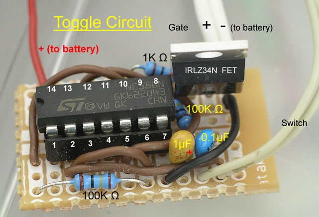

The circuit in my current torch has only one LED and uses a 555timer to toggle the LED on/off via the piezo. The 555 output operates a FET allowing 1amp to flow.
Do I need to source a programmed chip or can this circuit be made using ordinary non-programmable parts?

The ckt can be made of ordinary non-programmed parts. You're describing the operation of a simple binary counter. Look up binary counter circuits before going thru the complexity of using a programmed solution.

Thanks for that,
I thought as much but my expertise extends to soldering and sourcing parts, not designing the actual circuit.

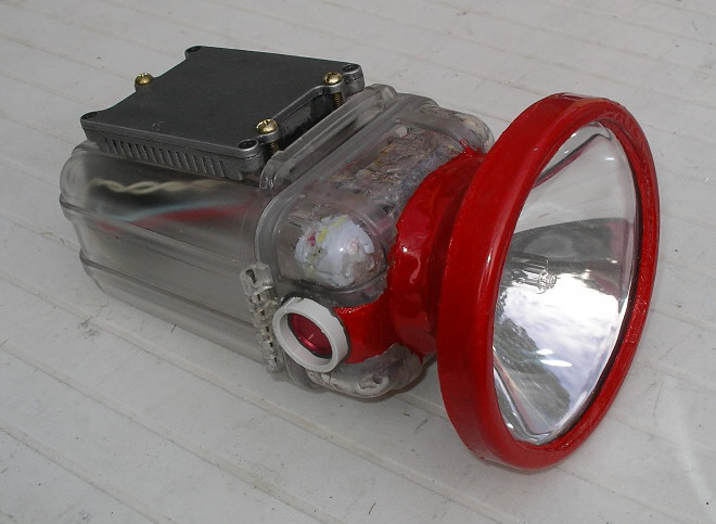

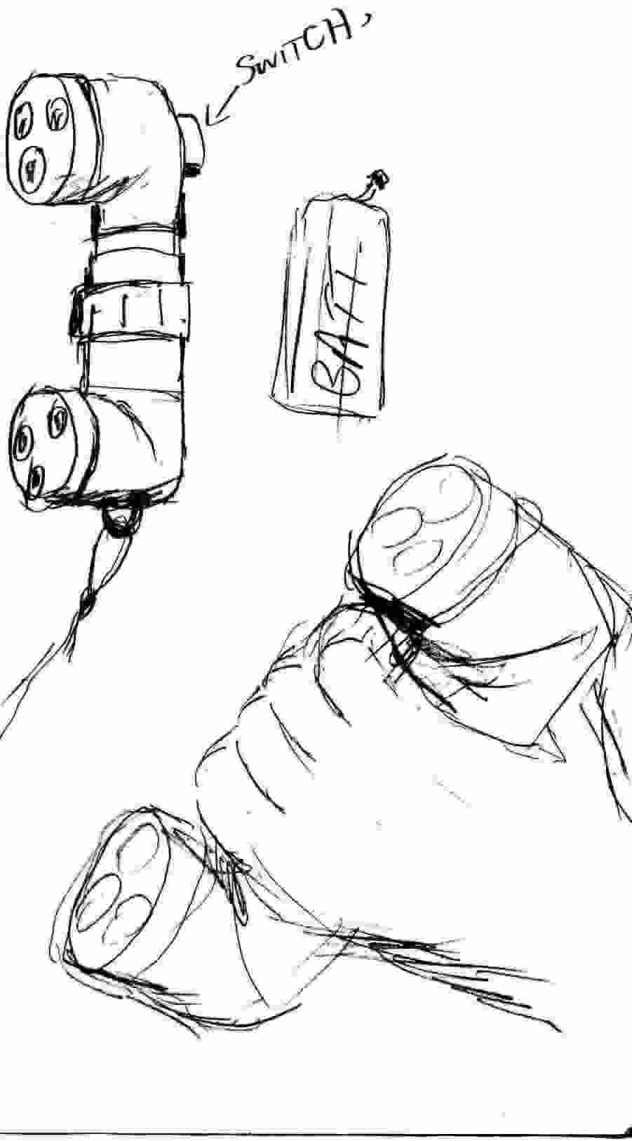

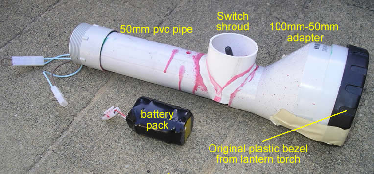

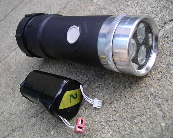

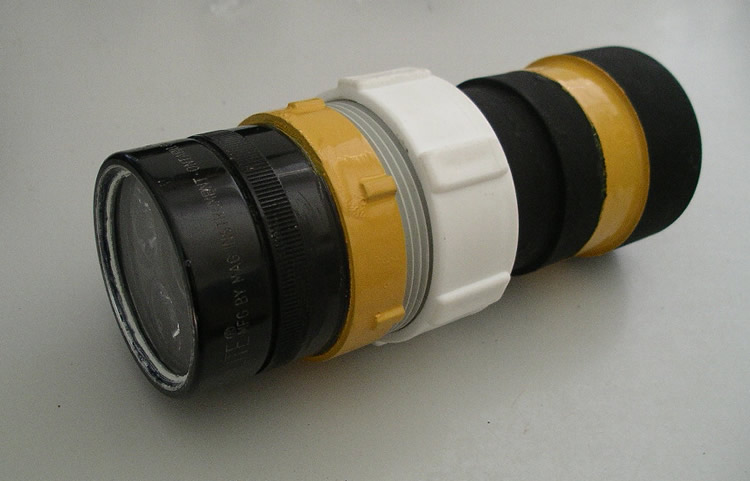

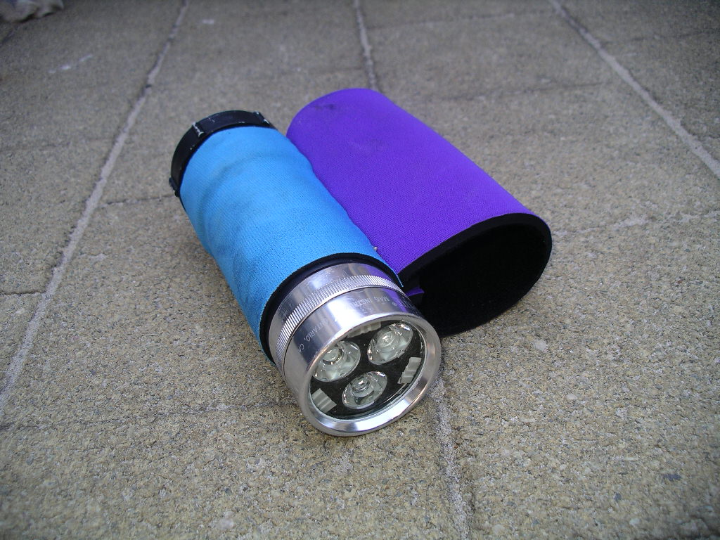

Here's a couple of pictures of two existing torches we've made using MR16 size tripple CREE XR-E LED's by Terralux, in a converted Maglite head. One uses a piezo and the other a magnetic reed swich array. Both with the same 556 toggle circuit.
Batteries are 2-cells of 4*18650 Li-ion's + protection circuit. About 5Ah of capacity on a 3watt draw. Doubling this should still give enough for two dives before needing top re-open for re-charge/change.
If I can get something as compact as the existing switch circuit arrangement that will save on unwanted buoyancy.
Any help on the circuit detail most appreciated.

No, I don't think space will be a problem. It looks a similar number of components to our existing single-LED toggle circuits (see photo).
On that. Do you think I can take the two outputs from your 4027 Flip Flop and instead of them activating transistors have them activate a FET instead?
Our current switch circuit uses a logic FET like the IRLZ34N to power these 3Watt LEDs. I was advised that logic FETs allow them to open completely when you want them too, with minimal resitance and copes well with the high current.
One more question. I am unsure what the acronyms at the top of your circuit mean; "S1-I, S1-O" and the four to the top right, "D2, D1". I assume they mean Switch One Input and Output but don't know the others. Are these necessary in my case?
Also, unsure what the line between the 6V symbol and Ground is ('IC 1P').

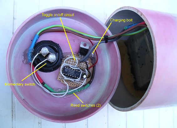

Boncuk,
Thanks also for the circuit design. As you can see I buy one of these project boards and tyr and figure out how to solder wires connecting it all up.
I know I should get into PCB building and etching but have never really found the time. Any starter advice here would be welcome
Klem

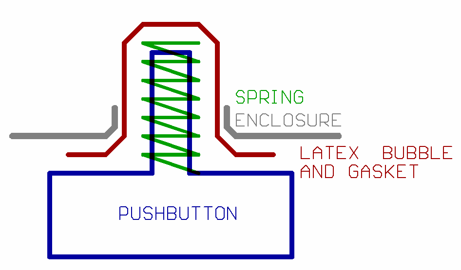

How much pressure is needed to activate your touch switch? How deep do you plan on diving to? 32 feet is 1 ATM.
Hi Klem,
since the switch and the LEDs are not located on the PCB the labels and solder pads are used to connect the switch and the LEDs.
S1-I and S1-O are connected to the switch. In the schematic both, switch and LEDs are dummies for better understanding.
+D1 and D1- as well as +D2 and D2- are connected to LED1 and LED2 respectively. (+ = anode, - = cathode)
IC1 P (IC1 Power) represents the supply pins of IC1, which can be identified looking at the pin numbers (8 for ground and 16 for VDD).

According to the schematic you posted that circuit allows only one LED to be switched.
Boncuk

Boncuk,
OK, understood on the solder pads....makes perfect sense now.
Yes, our existing toggle circuit is an on/off for one LED only, but necessary when using a non-mechanical momentary switch like a piezo. I included the photo to show the size and where we're at as far as expertise (or lack of it!) is concerned.
Klem

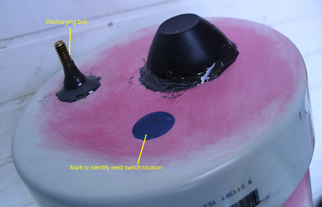

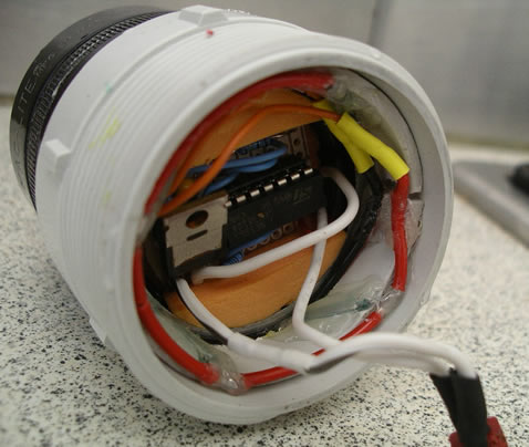

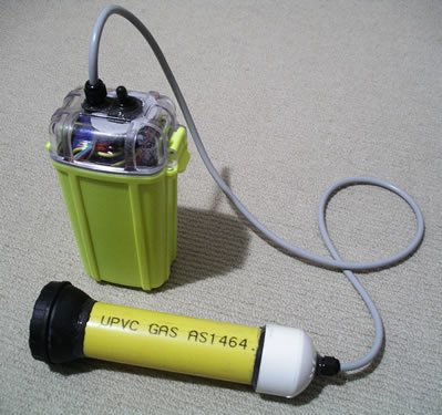

Mikebits,

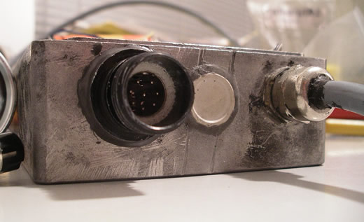

Yes, pressure is an issue with torch switches underwater and you are right to point this out. You need a switch that handles up to 5 atmospheres. From 1 atmosphere at the surface to at least the limit of diving on air...50metres, 6 atmospheres.
As you allude, diving is a harsh and unforgiving environment on electrical equipment. normal mechanical toggle switches work with waterproof rubber boots, but they are high profile and prone to getting knocked or the rubber pierced.
Commercial torches use mechanical switches going through a waterproof O ring to the inside
Press toggle on/off switches are useless as they become permanently compressed underwater with the pressure. So a reverse clicky toggle never goes on and a forward clicky toggle is constantly on.
Another method is to use a magnetic reed switch, either with the magnet applied for the entire dive or use a toggle circuit like in this thread with a momentary swipe. obviously normal reed switches are amps limited so you have to have some sort of relay system happening for the high amps needed. reeds are fragile to the knocks and bumps so be careful but they do help with the 'hull integrity' and are low profile.
Finally there is the more expensive piezo option with a toggle circuit. We've dived to 45 using piezo switches with no problems. As the ambient pressure increases and decreases on the piezo it is gradual enough that it doesn't respond like an intended activation. It works just as well at 45metres as it does on the surface.
attached are photos of different switches we have used. Some with more success than others.
It's a constant journey of discovery
Cheers
klem

Also, I don't understand the problem concerning push button operation in a submerged torch. You can use any pushbutton with an operating pin having at least 5mm length. Use the latex cover (102 bubbles) of a spill proof PC-keyboard and mount the pushbutton underneath adding a spring strong enough for the water depth you are planning for. (See attached sketch). For safer operation you might add a retainer ring at the top of the operating pin.

With your push-button switch query, you are of course correct, in that they can work underwater with the right amount of stiffness in the waterproof boot. Or as you allude the height is longer than the diameter (pressure from the sides more than pressure from top). This photo I showed earlier is a 'marine' momentary starter button, used in conjunction with a toggle circuit. It's the big black rubber button top-right. I remember diving to 20 metres with this design and the switch remained uncompressed by ambient pressure until you activated it. What didn't work however was the permanent seal arrangement. It had a couple of gelcel 12V battery's encased inside a 100mm PVC pipe with no access ports to aid waterproofing. Battery re-charging was via 2 brass bolts (one seen in the photo). These were kept from salt-water short-circuiting by a reed switch (also seen in photo).
Trouble is, the gelcel batteries didn't like being constantly deep-cycle drained and eventually they wore out, and on opening the terminals were all corroded and the reed switch semi-fused by high-amp charging exceeding it's rating. It was about to break down from any of those reasons but the battery was first. It was an early design...but, the switch did work fine.
These marine switches are fairly cheap also, and the rubber bomb-proof.

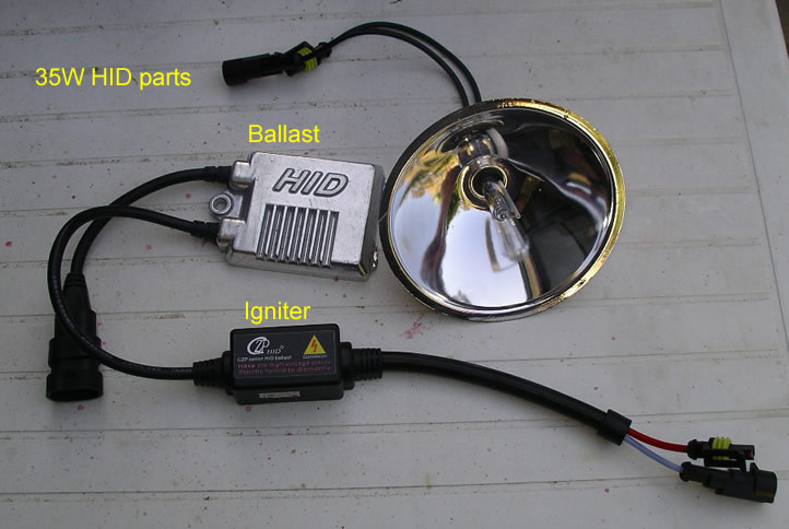

We use different torches for different diving.
Night diving is the most critical. We carry two each. A main 35Watt HID for long-range focussed light, and a mask mounted LED for reading console instruments and working close.
Daytime diving we carry one light only...The larger LEDs I have been talking about, for compact under-ledge/cave illumination.
The photo is my 35W HID night torch, which has a 100mm diameter 10mm thick Perspex lens. Powered by two 5Ah 18650 Li-ion packs (12 batteries), at 3.5A gives 120mins-140mins (depending on battery quality) continuous light of about 2,500+ lumens, 5,000K light colour. Reflector is collimated so it's a true spotlight. The ballast is mounted outside the waterproof Otterbox where the water can cool it (it gets hot). The igniter is inside. Essentially these HIDs are sold as replacement vehicle headlights.
LED's are about 500 lumens, but far more compact. For the LED's, using an old Maglite torch using 10mm perspex is a bit too thick for the available bezel thread. We cut a 50mm disk and spin it in a lathe to cut a 'step'. The 10mm lens at the edge becomes a more usable 5mm. At 50mm diameter there is less surface area to flex under pressure so we are less concerned with catastrophic failure than the larger lights.
We try for around 5000+K colour temperature. This 'white' light is far more natural underwater than the 'dirty' yellow that incandescents give (around 3,500K).

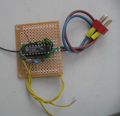

Test circuit made
Boncuk,
Still waiting on the FET's so I've built a test circuit in the meantime with your circuit. It works prefectly.
I applied 8V and measured the voltage straight off the 470 resistors and got the following toggle sequence;
1. Both on (8V)
2. Both Off
3. A only
4. B only
Terrific!
I'll post again later when the torch is assembled
Cheers
Klem

Hi Klem,
from my understanding it doesn't work perfectly yet.
I added a power up reset cap (resistor was already present) and now the sequence is as I planned:
1. all off
2. LED1 on
3. LED2 on
4. LED1 and 2 on
5. all off (again)
Please check the schematic and locate C3 (1µF electrolytic cap) connected between V+ and the clock input of IC1A.
This way the circuit is reset upon power up with no LED lit.
C3 offers an additional feature, since it limits the pushbutton trigger intervals with pauses of 400 to 500ms. (might be useful when trying to blind a shark, not inadvertantly switching off all LEDs in panic :) )
With this IC you won't need a power switch (main switch) for the battery. When no LED is switched on the circuit draws 120nA of current. When powering the circuit up initially the current flow is about 5mA for 1/2 second.
The PCB has become 0.1inch longer than the preceeding one.
