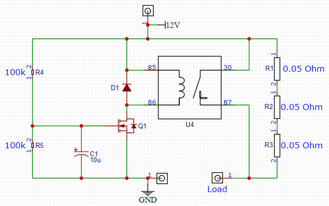

I am trying to design a soft start circuit for a 12V high current load. The 12V power source is a large 240Ah LiFePO4 battery with a BMS that is cutting out because the initial load of the ARB Twin compressor is drawing a peak in-rush current of nearly 200 amps. The BMS is rated at 100 Amps constant or 150 Amps momentary.
I have made an attempt to spec components based on a simple mosfet, relay and power resistor design but it's not working. Ie I introduce the circuit into the load but it makes no differnce and the bms continues to kick in and disable the battery as soon as i turn on the ARB Twin Compressor.
I'm not sure if it's dodgy components (because I roasted them when soldering) or incorrect component specs.
I basically wanted to restrict the load current to 80 Amps until the relay is closed. So i chose 3 x 0.05 Ohm resistors. I've tried both 10 and 22 uf caps and when i test on the bench, i do get about a one second or two second delay before I hear the relay switch but when i install into the actual load (it's in my 4wd), as soon as i turn on the ARB Twin air compressor the BMS kicks in. This seems to not even be after one or two seconds but immediately as if the greater than 150 Amps is still being drawn.
I'm hoping someone can at least confirm the design is sound or not?

I don't see any obvious problem with the principle.
However, if it trips with the resistors in line, then the BMS must still be seeing an excess load.
I'd suggest trying with resistors alone to avoid any unwanted interactions, until you can get it run for a second or two without a trip.
A load current of 80 A through 0.15 ohms is a power dissipation of 960 W, or 320 W per resistor. That's a lot. Forget the BMS - what is keeping the resistors from flying off the board like jumping beans?

Ok that's a good idea.. i'll give that a try. I can only think it's ignoring the whole mosfet/relay circuit and going straight through the resistors. I have a few things to check but i wanted to make sure the design was ok.
Edit. The problem is if I use those resistors for any longer than the brief in-rush period I imagine they will blow...

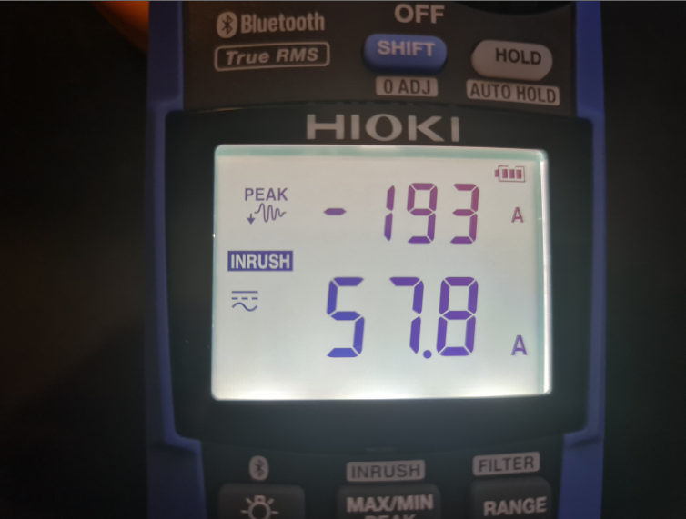

BTW There is definitely still a high load getting through (193 amps!) as per clamp meter on the load side between above circuit and the ARB Twin Compressor shown below...

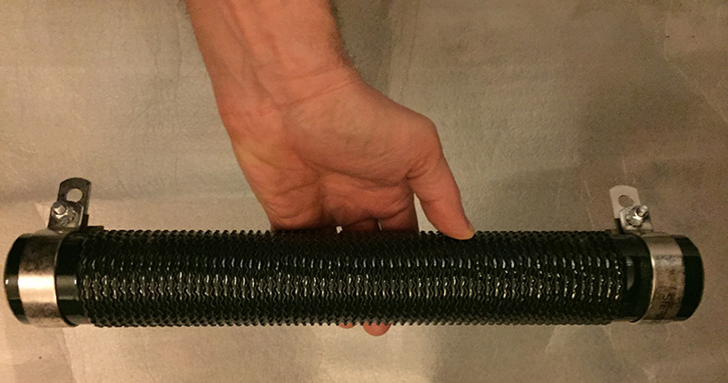

If you wanted one rated to take the full load continuously, you would need one like this - 1KW rating:

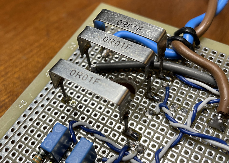

For a very short switch-on surge limiter, you may just get away with using a good number of this type in a series-parallel array; they are normally used for current sensing, but are quite heat resistant. A fan could help as well.

You can get some pretty hefty resistors on ebay for not a lot of money. For example 0.01Ω 100W resistors for ~US$2. Two is series will (probably) do what you need. They will get hot but only for a short time.
Edit, to be extra safe you could series/parallel them to up the wattage.
