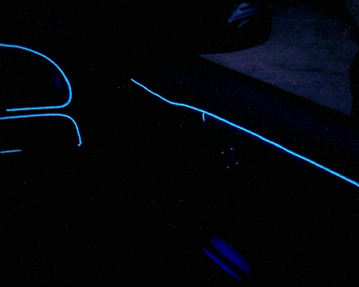

Have you discovered electroluminescent wire and sheet yet?
Though making it fade in and out is a bit more tricky but use the same principls as before but runs at higher voltage, typically 110volts.
Apologies for the poor quality pic , but it's damm hard to photograph.
