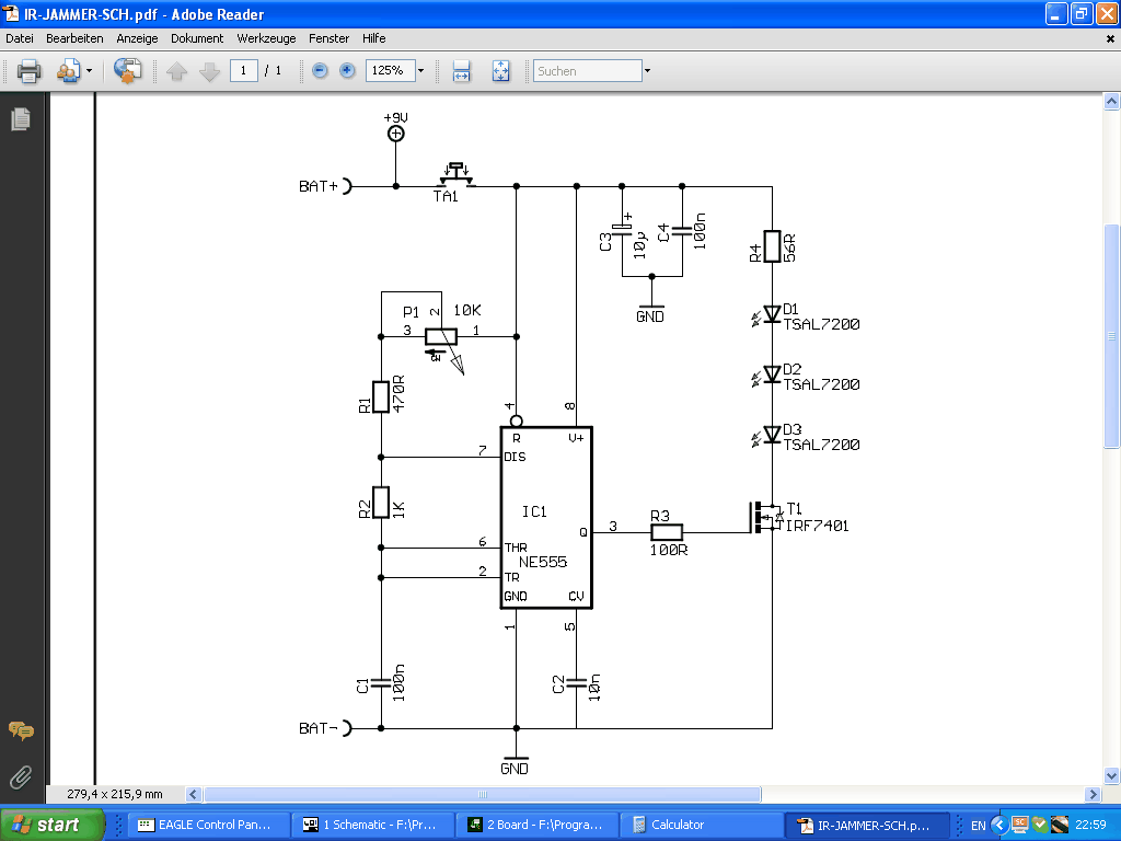

Hi guys..I have made an infrared jammer and it succesfully jammed my TV remote..but i'm planning strengthen the signal..any advice to do it? THX alot
The schematic is here:
Replace the transistor with a MOSFET and use more and stronger IR transmitters. Something along those lines.

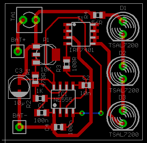

Hi imco123,
take a look at that.
It's a powerful IR-transmitter.
I kept the PCB design small to hide it in a pocket. May be you get slain if caught jamming TV-remote controls. :D
Board size is 27X27mm
