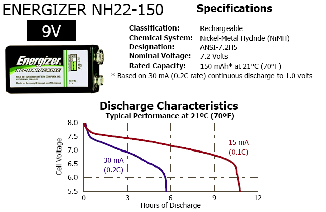

A "9V" Ni-Cad or Ni-MH rechargable battery is actually 7.2V because they contain six AAAA 1.2V cells. They are about 8.4V fully charged right out of the charger, then the voltage quickly drops to 7.2V.
I've often wondered why they don't put another cell in those 9V nicads so that the nominal voltage is 8.6V rather than 7.2V.... Surely, a fully charged voltage of around 10V wouldn't be a problem....
Six AAAA cells fit into a rectangular 9V housing. Seven won't fit.
Have you seen how skinny are those little AAAA cells? There is nearly nothing in them.
The capacity of the "9V" Ni-MH cells are up to 175mAh today. A little more than nothing.
