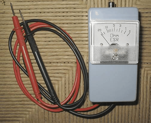

Well thanks to the generosity of Eric and a different ESR meter circuit provided by Nigel I have built my new ESR meter and it actually does something!
Not everything went as planned, for one thing I could not find any 470pF 1% polystyrene caps and had to substitute the ceramic ones I had. Having finally souced a 28v 24mA bulb for the circuit that the author states is 170r when cold I was a little dismayed as mine measured only 130r - I tried 2 of them as well.
Also I had to order some 1r resistors, the only ones I could find were 1w and they sadly measure 1.4r, I don't know how relevant this is?
The problem I have now is that when trying to set up the circuit as described by the author, he mentions a constant beep and all I get is a short beep no matter how I adjust the pot or preset!
I have rechecked my work and can't find anything wrong, so any suggestions from what I have mentioned above?

Bear in mind your meter won't be accurate on low ranges, but it's not critical anyway, just the bottom end of an attenuator to feed a low level of 100KHz through the capacitor.
The ciruit is pretty simple, and explained in the article, do you have a scope to set the output of the oscillator to the correct value?.

You should see a sine wave at pin1 of IC1a, at least 1Vppk I would say, also a smaller sinewave at Cx.

So center probe to pin 1 and outer clip to 0v (same as neg on meter) or neg on board (same as LED neg) and any clue as to where to start with settings on my old scope? I am not sure it can display a sine wave, never managed to get one to show yet :eek:
Thanks.......Al
Yes, that's correct for connecting the scope probe. Your scope should have a calibration test point on the front usually marked with a little squarewave and labeled with the voltage it produces. Use this to check your probe. When testing your 100Khz oscillator, set the scope for 0.2V per division if using a 1:1 or 20mV if using a x10 probe. Set the horizontal sweep to 10uS per division. You may have to adjust the trigger control until the scope shows something on the display. Adjust as necessary to get a clear and stable waveform.
