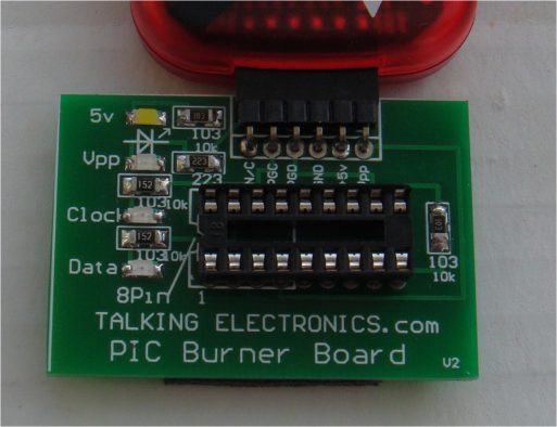

top-nochip-jpg.107827
I wouldn't recommend this board. It's poorly designed and probably a good candidate for the "Spot the Mistake" column on the TalkingElectronics web site, a 'closed' web site where the Author can ridicule designs without having to deal with comments from victims (reference: spot-the-mistake post).

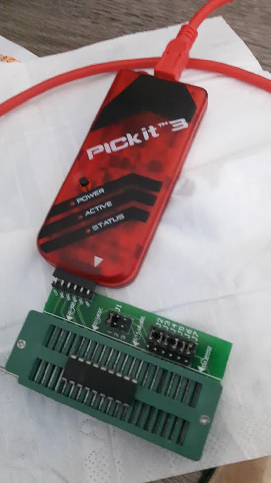

Jpanhalt ,john, ...all stuffs....i bought this pickit3 what can i do next.....?

You have source code and a programmer. Re-read posts 9, 10 and 11. Make a decision as to which IDE* you plan to use, and move forward. A good place to start is usually with the directions and a worked example. But first, you need to make that decision.
John
*MPLab 8.92 or MPLabX 4
Then, I recommend that you do "debugging" before programming. You do not really require the PK3 or a chip to do that. Although, you can install and debug with just the Assembly file (.asm), I strongly recommend that you use "Project Wizard" and create a project. Do not select PK3 as your debugger right now, pick instead "MPLab SIM." Then add your program and step through it in debug mode.
Once that is working, switch to "Release." Change your debugger to "none" and select your programmer as PK3. Then rebuild and program your chip to see if it works.
I have found an error in the source code in post #3. There is a line that says "goto loop 0" It should say "goto loop0" The extra space is making it look for a symbolic location loo (Which does not exist but loop0 does exist.) After changing this line it assembles using the EPE magazine TK3 toolkit. I have also edited the source file so it assembles using MPASMX.exe (v5.55) This is somewhere in the MPLABX directory structure.
Edit. I have put the .hex file (Created using the TK3 toolkit) into my dropbox folder You should be able to download it from this URL
https://www.dropbox.com/s/f9orq1f4bydh95q/MOODPIC02.HEX?dl=0
Les.
