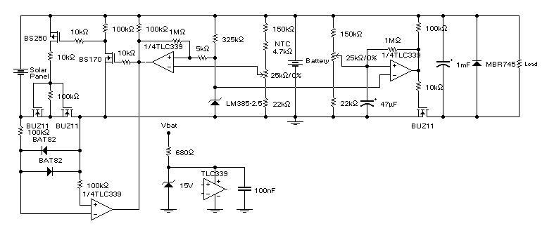

Actually I'm just copying an already designed circuit using a TLC339. I'm trying to analyze the circuit and modify the UTP and LTP values. Do you know where I can get that info ?
The circuit is attached below just in case.

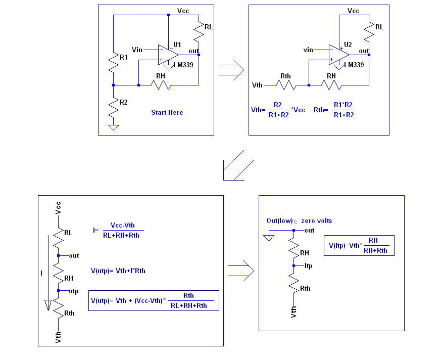

Anyone know any links to where I can find the formula/expressions for an Op Amp Schmitt Trigger ? Meaning to calculate the UTP and LTP values. Or if any of you know the formula, please reply, this is giving me a headache !

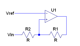

OK, guess I need to define R1 and R2 first:
R1 connected from output to non-inverting input. R2 connected from non-inverting input to ground. Vin is inverting input.
VupperTH = R2/R1+R2(+Vout-max)
VlowerTH = R2/R1+R2(-Vout-max)
Hope you can make sense of this.

It's not quite that simple. see below.

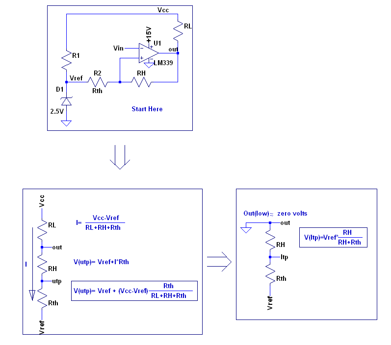

This is the Schmitt from your schematic. If your schematic is different, then post it.

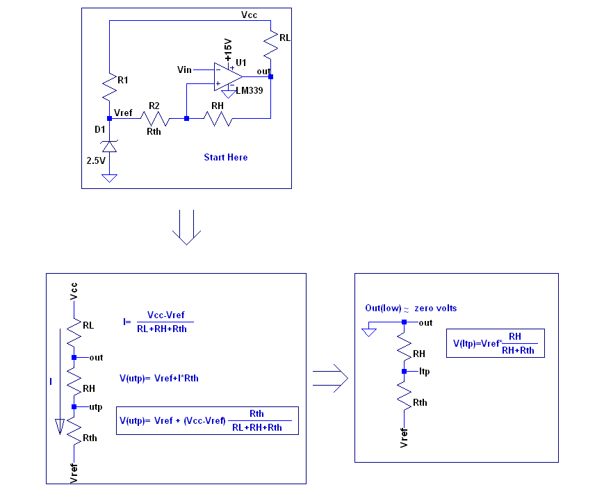

OK, here's the analysis for the other Schmitt trigger. You do have RL, it's the 100k from the output to the battery. Your LM339 is powered by the 15V zener circuit at the bottom of your schematic. LM339 is a quad comparator, so they only show the power supply connections on one of the sections.

OK, much thanks Ron, its all less confusing now. After calculating, the results I got for the UTP is approx. 2.5V and LTP 0V. Simulation seems to work ok too.
But how does the LTP get triggered when it is at 0V ? In this circuit the Vin cannot possibly become negative, right ?
Also, how do I find the Vout(max) of the opamp ?
Can you elaborate on 'Out(low) = approx 0V' ? Do you mean -Vout(max) =approx 0V and why do you set it that way?
V(ltp)=Vref*RH/(RH+Rth)
V(ltp)=2.5*1Meg/(1Meg+5k)
V(ltp)=2.488
How did you get zero?
Also, how do I find the Vout(max) of the opamp?
Vout(max)=Vref+(Vcc-Vbatt)*(RH+Rth)/(RH+Rth+RL), where RL=100k (the resistor from the output to the battery).
I don't know what your battery voltage (Vcc) is, but if it were, for example, 9V, Vout=2.5+(9-2.5)*(1Meg+5k)/(1Meg+100k+5k)=8.13V
The TLC339 has an open drain output, with the source grounded (see p.2 of the datasheet). When the output is low, that transistor is like a closed switch to ground. When the output is high, that transistor is off, so the output voltage is determined by whatever is connected to the output. Hence the equation above for Vout(max).

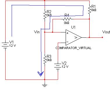

Is the analysis for the non-inverting opamp similar, using the Vcc to feedback to ground branch? The circuit is something like this :
If Vin is a voltage source, R1 (RL in my terminology) is the only resistor that does anything in that circuit.

For the non-inverting one, why do you say RL the is the only resistor that does anything ? I thought adjusting the pots would adjust the UTP/LTP ?
Looking at the attached pic, is the UTP calculated using the blue path ? If not, can you please tell me how it should be.
Also, how does the 2.5V reference in the negative input affect things ?
Thank you.
Thank you.
When your Vin is where you show it in the right-hand schematic, and Vin is a zero impedance source, the R2-R3 voltage divider and the hysteresis resistor R4 have no effect, because Vin is Vin, regardless of the value of those resistors. Imagine Vin is a 3 volt battery. You can adjust R2, R3, and R4 until the cows come home, but Vin will still be 3V. If you want those resistors to have some effect, Vin has to have some series resistance.

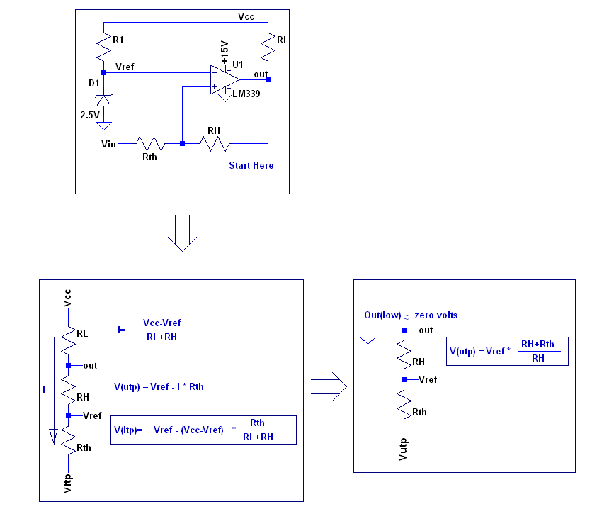

I don't know why you say that. Vref does not affect Vin in either case. In fact, Vin is by definition a voltage source, so it can't be affected by Vref. Here are the equations for -in and +in Schmitt triggers.

Ron, is there a typo for the +in calcs ? The second box, at first its Vutp then you change it to Vltp.
Nope, that's the way it works out when you switch from -in to +in. I ran simulations with an LM393 just to make sure my equations gave me the same answers as did the sims.

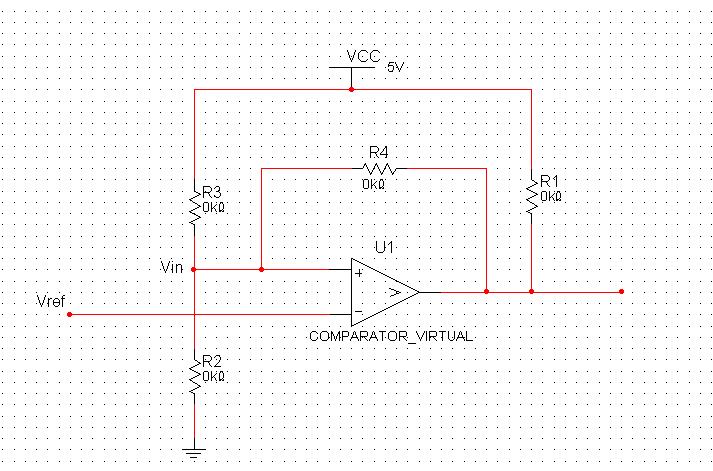

Weird though, in my circuit there is no Rth. Cannot be that the Vutp, Vltp and Vref are at the same voltage point .. ?
