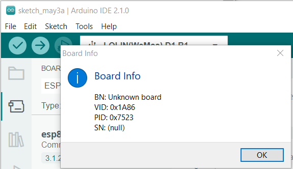

I am getting this when I select any lolin D1 board, COM5 is the correct port cos it shows up in Device Manager when I connect up the USB cable to this board.
Thats not abnormal, most manufacturers of their boards do not include this info
and the firmware therefore does not report it correctly. I ignore it generally
speaking.
