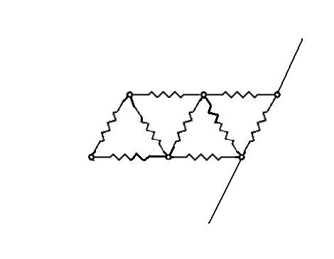

I need to know the terminal resistance for each, with all the resistors being 1K ohm in value for this configuration:
           o---ZZZ---o---ZZZ---o
          Z  Z          Z Z           Z
         Z    Z        Z    Z        Z
        Z       Z     Z       Z     Z
      o---ZZZ--o---ZZZ--- o
where ZZZ are the 1K ohm resistors
and o are the connections points
HELP......
The pic above does not seem to display properly so I have attached a pic and also in the next message a link

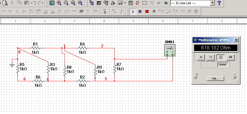

Answer of 42
Can you explain how you arrived at 42 Ohms? I understand the formula for a single delta config Rxy = (RA+RB)RC/(RA+RB+RC) so do I start on the left and "cascade" the calculated value over to the delta config to the right as I solve for it?
Resistance between which terminals you need?

or even 618.18R
hi neil,
I can live with that..:)
I think the OP in an earlier post said that 618.xR was not the answer,
most likely he's not given us the full question.
Once I saw a similar puzzle, but it had an infinite number of triangles to the left side (or was it made with squares? I don´t remember, it was many years ago). This type of topologies ussualy make very good puzzles.
Perhaps this is the case, which of course has a diferent answer than the finite one we were solving.
