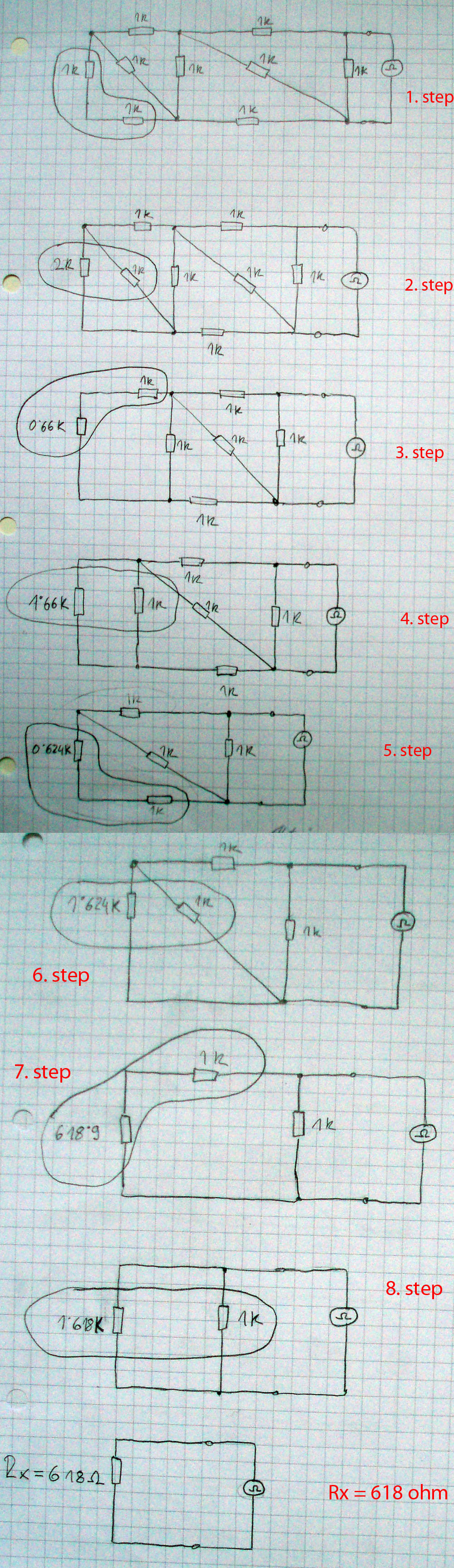

I suspect you are joking with us, but nevertheless here is step by step result.

The key to this puzzle is where you start from. I found my notes again and decided to have an other go at it. I hadn't look at this thread so all the newer solutions were unknown to me.
Firstly the connecting leads are at the RHS of the puzzle so the minimum value of the RHS string can never be less than 500:eek:hm: It will be the parrallel value of 1k:eek:hm: in parrallel with (1k:eek:hm: + X:eek:hm:)
Then I started working the way through from the LHS of the puzzle by series parralleling the sections of three resistors.
2k:eek:hm://1k:eek:hm: yields 666.6:eek:hm:
1.666k:eek:hm://1k:eek:hm: yields 625:eek:hm:
1.625k:eek:hm://1k:eek:hm: yields 619:eek:hm: = X
1.619k:eek:hm://1k:eek:hm: yields 618:eek:hm:
I didn't put all the decimals in the example but you get the idea.
Regards, Raymond
I did the same thing, collapsing the network from left to right using
series and parallel formulas. The result i got was:
6800/11 ohms exactly,
or
618.1818181818181 ohms approximately.
I solved from the left also and got 618.18 ohms. I can't see how you could do it from the right when your parallel values are unknown
