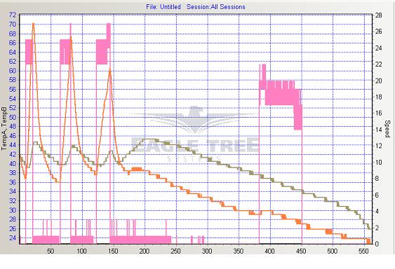

I have an old Coal fired central heating boiler. The temperature is controlled by a bulb & capillary thermostat sensor mounted on the side of boiler. that starts a fan when the temperature is low. However, due to the mass of the boiler (and water) there can be a temperature lag between the boiler and the coals. So, when the water pump is off, the boiler & water temperature can remain higher than the coals. So in certain conditions the coals go out.
In short, I would like to control a fan (240v ac 0.2A) dependent on a temperature between roughly 20C - 100C and would to be able to adjust the upper & lower temperatures.
I would really like to, not only try and, with your help, build this, but also, understand the build / circuitry.

The flue is giving a wide range and is more directly related to the coal fire temp. That's where the sensor will be placed.
Then you will probably need a sealed temperature sensor sheathed in stainless-steel or a thermocouple. The flue is likely to be a very corrosive environment. Visit Omega to see what type of suitable sensors they have.
The sensor I've been using for data logging has been surface mounted, No corrosion worries.
So, post the specs on the sensor and some recoded data as measured in situ.
I'm happy to use what ever thermo couple will work i the range......... k type?
Are you asking for a circuit that will switch on/off an AC load based on the temperature plot above?
If so, what voltage does the sensor put out at the desired turn on/turn off temperatures.

Thanks for the reply, but the water temperature has been regulated effectively (manually) by controlling flue temperature.
I take your point regarding draft, which I'm sure is a problem......
...... bottom line?? I want to
That's what I'd like to do. It may be beyond my ability. But that is why I posted here...... to get assistance with a temperature controller. I may end up having to get an 'off the shelf' controller & thermocouple, which would be a shame.
Yes
If so, what voltage does the sensor put out at the desired turn on/turn off temperatures.[
Don't know.
...........I would like to control a fan (240v ac 0.2A) dependent on a temperature between roughly 20C - 100C and would to be able to adjust the upper & lower temperatures.
Is the 20 - 100C the stack temp or the water temp?
An easy way to make an electronic thermostat is to start with a thermistor, which if used with a simple bridge and opamp circuit can switch a relay or SSR. You suggested that you already have a sensor, but now it seems that we are back to square one! Like I said earlier, everything derives from the sensor, and what voltage (or resistance) it puts out at the temperatures you want it to switch at...
I'll take any advice regarding which thermocouple to get.
