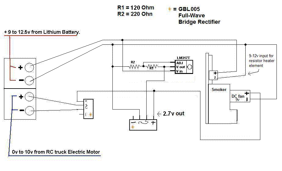

so I decided I wanted to make the fan idle at about 2.5v all the time so a steady stream of smoke comes out my tail pipes.
(this will do 2 things make the truck look more real when sitting still, also it will keep the air moving across the heating element to keep it cooler.
that is where I am having my problem.
I decided to use a LM317 voltage regulator and have found a resistor calculator online to help me with that.
Also I am using full wave bridge rectifiers so that the fan does not spin in reverse when I put my truck in reverse. ( I did notice that those do draw a little power)
I am able to get the smoker fan to idle at a good speed now using LM317, but when I go to use my remote to move forward just a little bit my smoker fan shoots up really high in RPM's. it did not do this before when I had it hooked directly to the DC truck motor.
so I know it is a problem with my circuit.
can you look at my schematic and tell me why my smoker fan is going from my 2.5v steady idle then jumping up to a high voltage as soon as I go forward just a tiny bit at slow speed.
the smoker fan hits full blast or sounds like it.
I have included this video and my pictures so you can see for yourself my problem. :)

With the LM317 providing a steady 2.5v, your providing 2 paths for current to get to the fan when the motor gets power. I'd imagine thats why it speeds up so much sooner. Its only a 9v motor and your already close to a 1/3 of its rated voltage when you turn on the motor.

Question: Is the lithium battery connected to anything else? Specifically, is it connected to the receiver circuit, which then supplies the 0-10V to the RC truck motor? That could be your problem.
thank you you just helped solve my issue.
Yes the lithium battery is the same one that was driving my ESC and receiver.
so I diconected the top from the lipo and hooked it to my bench P.S. and tried it that way and the fan idles nice and the fan also has proportional control, also the heater works from the 12v from my bench P.S.
So I was considering using two 11.1v lipo battery's
now I think I will, with the one controlling my smoker and LED's having its own cutoff.
unless there is a fix I can wire up to my current circuit to correct what ever is going on because i am using the same battery to control the ESC.

It is hard to say. It depends on how the truck motor is controlled. You need to measure the voltage between the Lithium battery's (-) terminal and each of the truck motor terminals with it operating in forward, reverse and stop. If the voltage between the Lithium battery's (-) terminal and truck motor terminals is zero when 0 throttle is given (stopped), and only one terminal at a time varies in voltage with forward and reverse throttle (the other stays near zero), then there is a simple solution to this:
