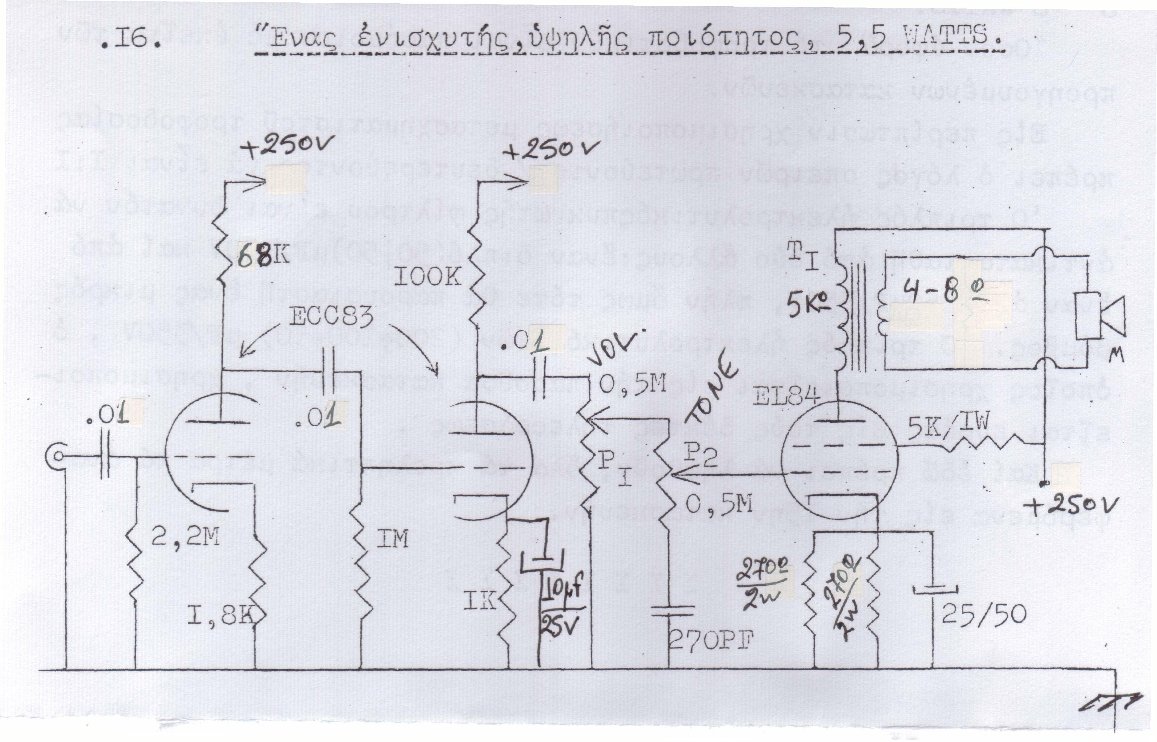

i got this design... and i need to ask why suppressor grid isn't connected
and if it is by mistake left outside...
second thing, i need to know if this amplifier needs split power supply or
if single is fine
also if somebody want to recomend any changes on component values it's ok...
