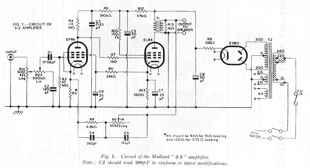

help understanding amplifier schematic
@Nigel i was hopping it will be useful both for listening to music decent enough and as a small guitar amp... (i don't mind the output power at all...)

It's certainly possible, but it won't be optimum for both.
Here's a circuit for the Mullard 3-3, it's from 1955 :D

can i replace the tubes with the ones i have?
atleast for the first design, looks possible to me...

about the power supply are there any suggestions?
i'm going to do full wave rectification with 1N4007 a couple of
capacitors 150uF/400V and 220nF/400V maybe an inductor and i think i need a load resistor because the transformer outputs 220VAC...
about the heater the transformer outputs 6.3V/3A and i think i'll leave it as is and if the hum is high we will see...
ok... but only the heaters? i was thinking to do it for every cable...
what about the other thing, do you think i need load?
Only the heaters cables feed AC.
You should NEVER run a valve amp without a load.

when i'm saying "load" i mean a resistor in parallel after the rectification to dissipate some power...
the power supply is 220VAC/250mA
probably you mean that i must always have my speakers connected right?! if yes what's going to happen if i forget it? can i blow off the tubes or only the output transformers?

No, only sensitive parts - the input would normally be a screened cable.
Not normally required.
It's the transformer mainly, although it can kill the output valve.
