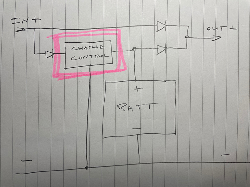

In the case of a circuit
Solarpanel>Mppt>Battery>Load
Is there a way to restrict the potential max current to the battery wired in paralell whilst retaining 16.8v, without restricting potential max current to the load, reason being I would like to limit max load at 16.8v@4A to the battery, but allow 16.8v@8A draw from the load from both either the battery or Mppt.
Is this accomplishable effeciently?
You have been told repeatedly how to do that and completely ignored every answer.

But if 20 amps was available from the charge controller, the battery would charge too fast in this diagram???
