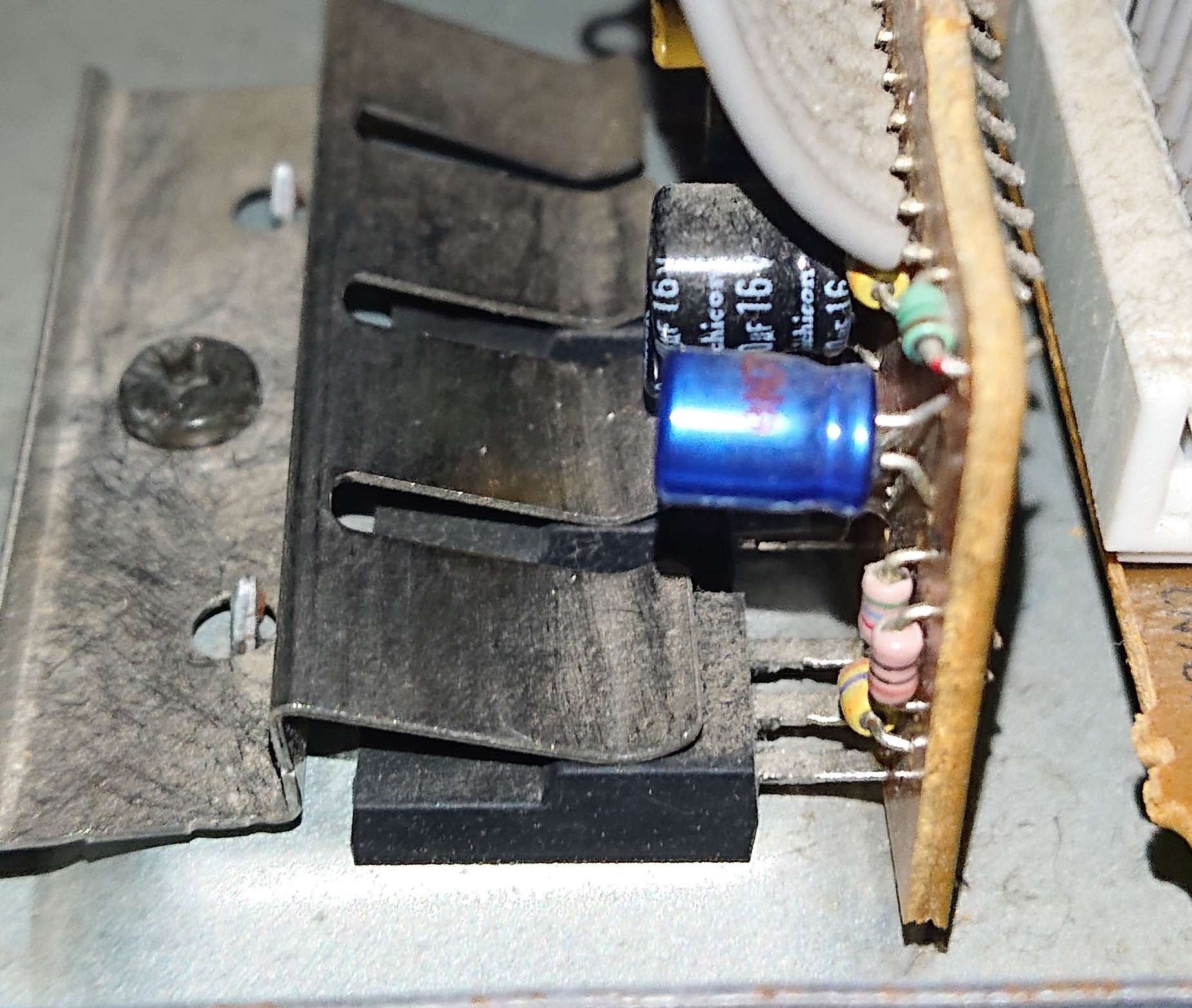

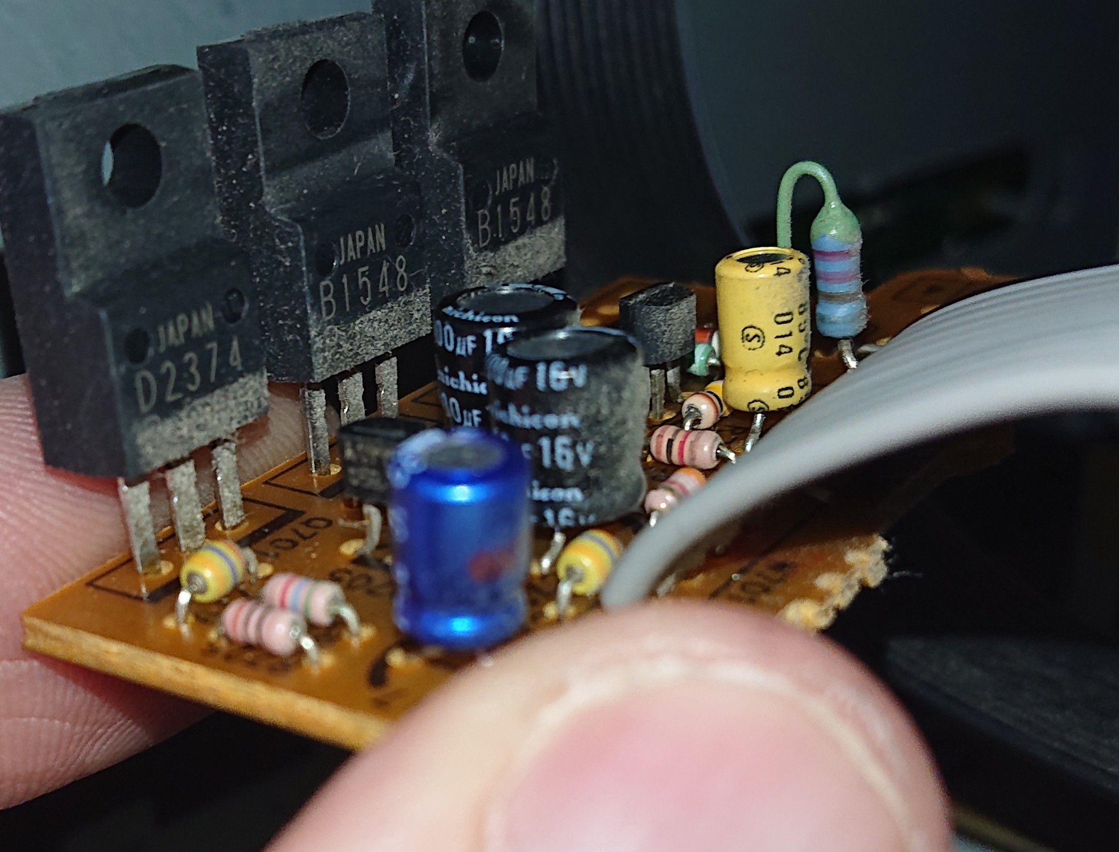

Hi, I picked up an old technics sa-eh760 hifi system, it works great. I have a concern with a component getting very hot, it's a pcb with 3 transistors d2374 and 2 b1548's the service manual calls them regulator transistors. The 3 transistors are clamped down to the body of the amp, I'm guessing for heat dispersal. If it is a heat sink it's not very substantial and no sign of any thermal paste ever being used. So I would like to know what it is? A voltage regulator?
And should it get hot? How hot is go hot.
Many thanks Ben

The resistor in front of the D2374 transistor is broken which might cause transistors to get too hot.
The heatsink is Mickey Mouse simple so the transistors should not get too hot.

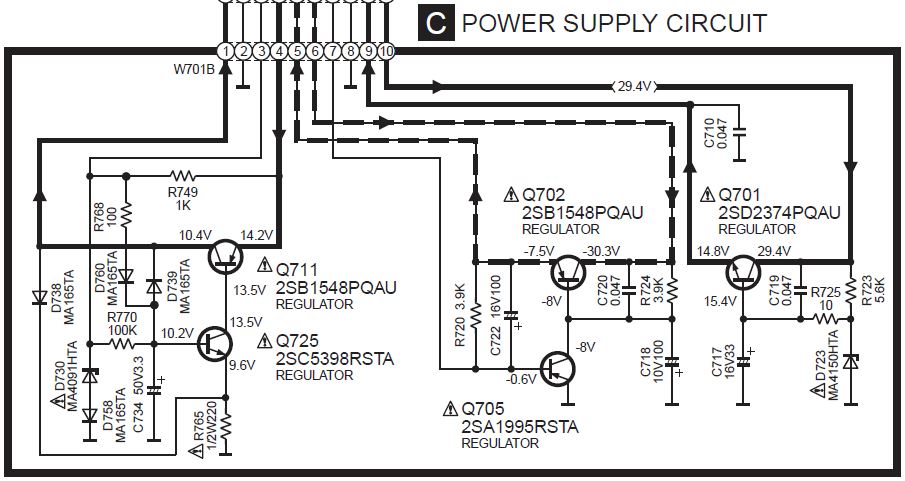

A detailed schematic shows us what things do, not a photo.
They are the power transistors used as part of the voltage regulator circuits.
Two of them are dropping a fair voltage so will get quite warm even at low currents.
I'd try adding heatsink compound and then keep an eye on the temperatures in use..
After it's been on for a while, isolate power then damp your finger then tap the heatsink to leave a single drop, without it running in to the electronics.
If the water boils it too hot!
It it evaporates in 30 second or more, it is fine. Inbetween those is debatable, some things used to be designed to run at 80'C or more...
AG - the circuit / service manual is easy to find from the given model number. eg. https://elektrotanya.com/technics_sa-eh760_sm.pdf/download.html
From that, the short yellow items are 47nF caps, not resistors.
Edit - ps. That voltage regulator board is on page 55 of the service manual.

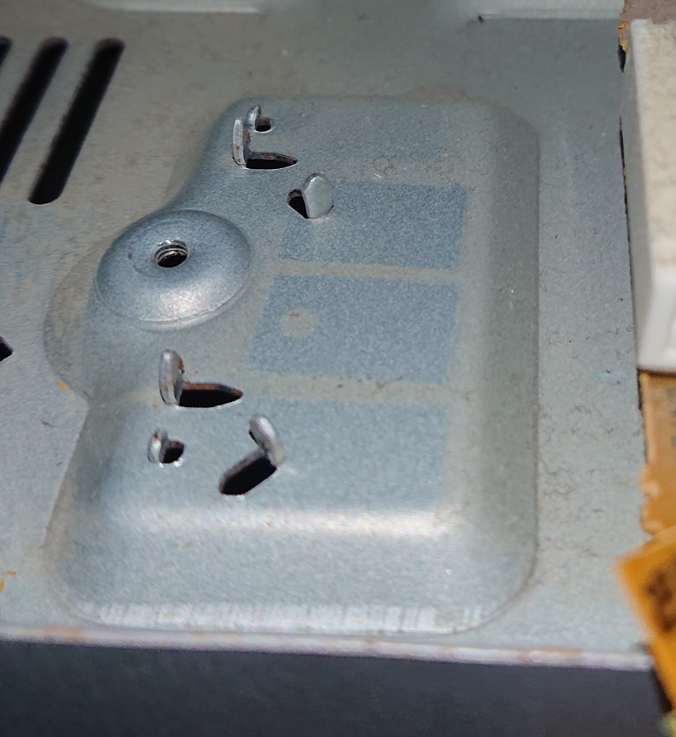

When I open it back up to put the paste on I'll give it the lick'n hiss test lol, I was thinking the heat sink is a bit lame but thinking about it the body of the machine is probably doing a good job of drawing some heat away, where the 3 resisters are clamped to the base of the stereo, it's pressed in/raised up, I presume to keep more distance from the table or surface the stereo is on so it doesn't cause any damage. That works fine I can't feel any heat transferred to the table, if I put my finger under the stereo directly where the transistors are, it's hot, very hot can probably leave my finger there for 5 seconds before it gets to hot to handle
