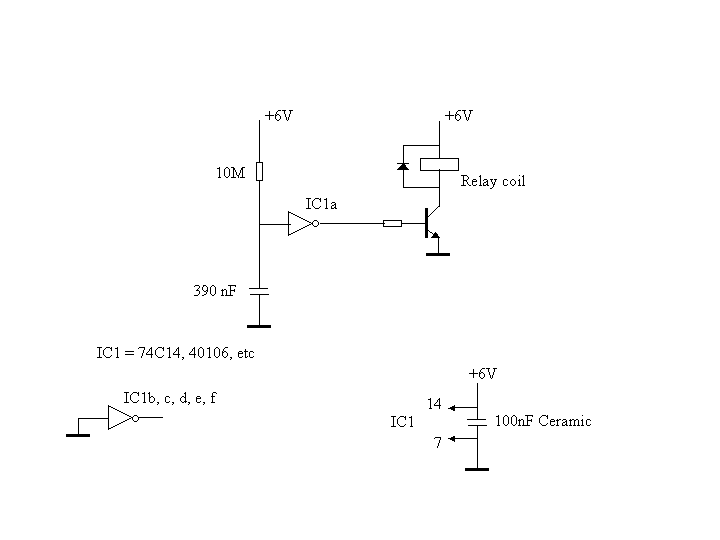

Here is a circuit I posted for ymmy in the Chat forum.
It provides a delay of about 3 second. If you leave the relay and driver off, the output of the IC will provide a High pulse for that period. If you need a low pulse, either swap the capacitor and resistor or use another inverter.
Len
ljcox, can’t thanks enough!!! Seem like this one exactly what I looking for. Will try to build tomorrow and see how it works.
Thank you once again!!!
I’m very impressed! Works better then expected, no need to wait long time to discharge huge cap like in transistor version and this circuit ready to be used again within 1sec or even less after On/Off power cycle. I’ve ripped surface mount 74hc14 from my old cd-rom drive so the whole circuit done on the top of chip and circuit dimensions extremely small if compare to transistor version due to huge and ugly 220uf electrolytic capacitor.
As always Thank You for '5 star' help!
