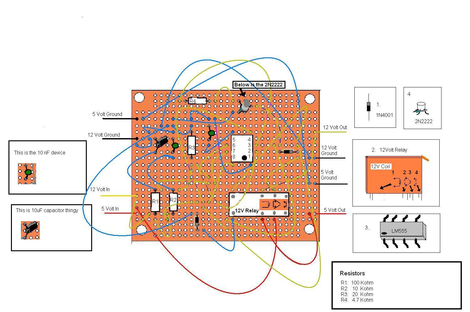

Ok, I need to build this circuit for my car alarm siren output. I can't figure out how to build it:
What I want the circuit to do:
  • I want it to pass the 12V+ signal once it has been received for 3 consecutive seconds
  • It should not pass the signal if it is received for less than 3 seconds
  • Once the signal stops, it should stop passing the signal and reset
Why?
I got some air horns because the alarm's siren wasn't loud enough. The alarm dosen't have a dedicated horn honk output. With the horns hooked up at all times the arm/disarm chirps also honk the horns and they're too loud for everyday use. I could disable the arm/disarm chirps but I like them.
With this circuit the siren will, if you guys can help, chirp by itself when arming/disarming the vehicle and the siren will blare continually when the alarm is triggered while the horns honk on and off, because of the flasher, after 3 seconds.
I'll use a standard automotive relay to supply the power to the horns so the circuit only need to supply enough current to switch the relay, not sure exactly how much that is.
Any help or suggestions are appreciated!

Alrighty, I switched one of the 1N4001's around as it was facing the wrong way, and retested it, but it still flips the relay to the OC and and stays there. So I've come to the conclusion that I'm doing something wrong that isn't at all apparent to me (the newbie guy) but would probably be very easy to spot for one of you. So to hopefully make it really easy to troubleshoot, I'm posting this pretty close to scale model of my circuit I built. Let me know if you have questions or comments, and please please please let me know if you see my mistake.
All adjacent colored-in holes are to be considered sauldered
Yellow indicates 12V power, Red indicates 5V power, Black is ground of course. A Yellow wire carrys 12V power to some component, and a Blue wire is on its way back to the 12V ground. The wires in the picture are not at all drawn to scale, but hopefully they are easy to understand whats going where.

Hi Cynet1,
I have tried to follow your layout,
but its too difficult panning backwards and forwards
and up and down, and following wires, im on 640/480
I got as far as trying to see if the relay contacts
were correctly wired, but i couldn't see how the pic
of the relay went to its pins.
Got the impression that the two 'makes' are on each
side. Coil at one end.
Maybe 'e' could see that its ok.

Oh,
Hehe, I see why it was tough to figure out the relay...
I forgot to draw a set of pins for the silly thing....
There we go, things should be much clearer now since I've updated with the correct drawing of the Relay.

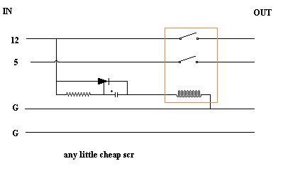

If you cant get to grips with that circuit,
you might like to consider something simpler.
I know you have gone to the trouble of building
that assembly, but sometimes simpler is easier.
You might like to consider this diagram.
Start with 10k and 20 MFDs and see what time
interval you get. Try altering the cap value
until you are happy with the interval.
Unless of course you've got it working!
Best of luck, John :)

ohh man that diagram is very hard to read, but im suprised at
how well it is at the same time. I really tried to figure it out, it looks
like the transistor (2n2222) is in wrong. Im having a hard time seeing
anything else... the top two legs of the metal case looks like they should
be switched, but im not too sure because it is hard to see... Do you have
a multimeter, or even an LED? If so test the output on pin 3 of the 555
timer, to see if it changes state at 1 sec, if so its something with the
transistor, if not its something before that. Does the transistor get hot at all? Make sure to check all solder joints carefully, If R1 or C1 is not
connected at both sides it could do that.
I do think the transistor is in wrong though, the leg you should have
going to R4 seems to be going to the relay(c), and the one going to the
relay should be going to R4(b), the third leg (e) looks fine.
If you have a multimeter/led/testlight/small 12v light.. hook one side to ground and the other side to Pin 3 of the timer, it should
turn on right as the power is turned on, and off 1 second later.

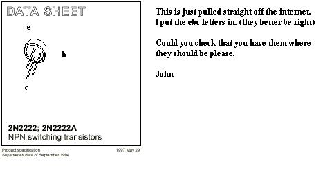

Yes, i had a hard time following that layout.
I agree with 'e' that transistor is a likely candidate,
you can't really tell which wires are which.
Emitter should be to g,
Collector should be to the relay,
Base should be to the chip. (via the R )
Ive added a pic, just in case you're not sure.
(i hope i have the connections right,
if they chose to alter them,
they wouldn't ask me first, nor tell me after)
Cheers, John :)

yea that picture shows the pins correctly, i think the TO-18 case
is kinda harder to follow than the TO-92
Thank you for the 2N2222 info
You were correct in identifying
my mistake there :roll: . The
electronics shop person drew me
a diagram of how that 2N2222
worked and what was what, but
he got it backwards :?
